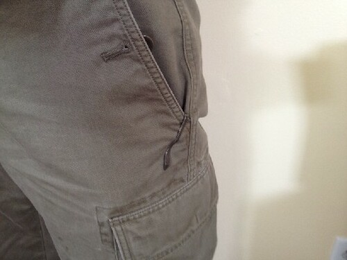

I recently purchased a Spyderco Delica 4 (FRN FG Plain Edge) and wanted to swap out the stock clip for something that carried deeper in the pocket. I have come across another similar post here (I cannot find it now or I would include a reference) but wanted to share my experience.

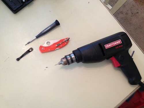

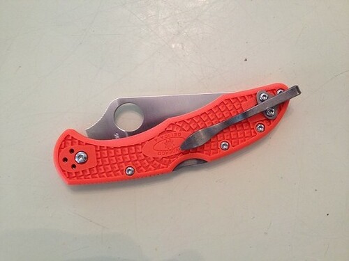

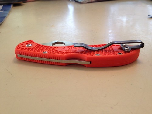

I purchased this STEALTH clip from USA Knife Maker for about $9.50 shipped: http://usaknifemaker.com/ti-pocket-clip-formed-tumbled-040-low-rider-stealth.html. By default, the holes on the clip do not line up with the mounting holes on the Delica 4. The other poster mentioned using a diamond file - I went another route and used a 1/16" Cobalt drill bit. It took about 15 minutes, but ultimately I was able to extend the holes enough towards the center enough that they lined up.
Below are some pics:
