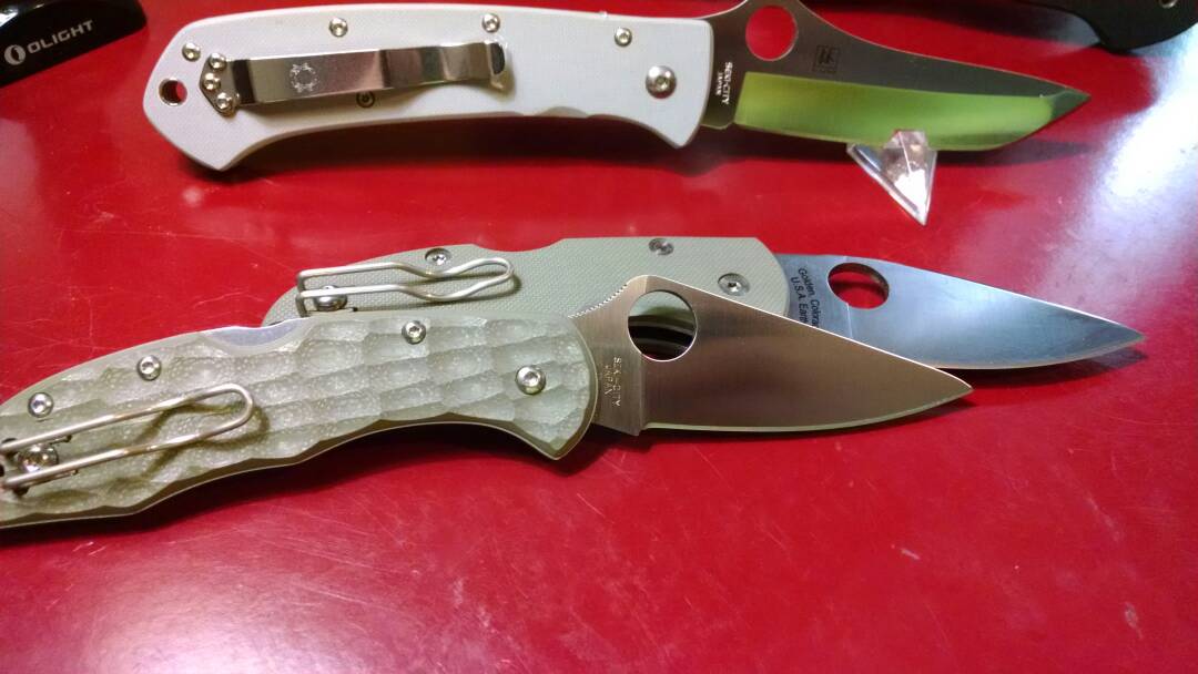

Will the wire clip mod, work with this as well?
The Native 5 you did for me, is Awesome!
And your Delica scales, I modified..
Awesome work on both!

Wire clip mod looks very cool.

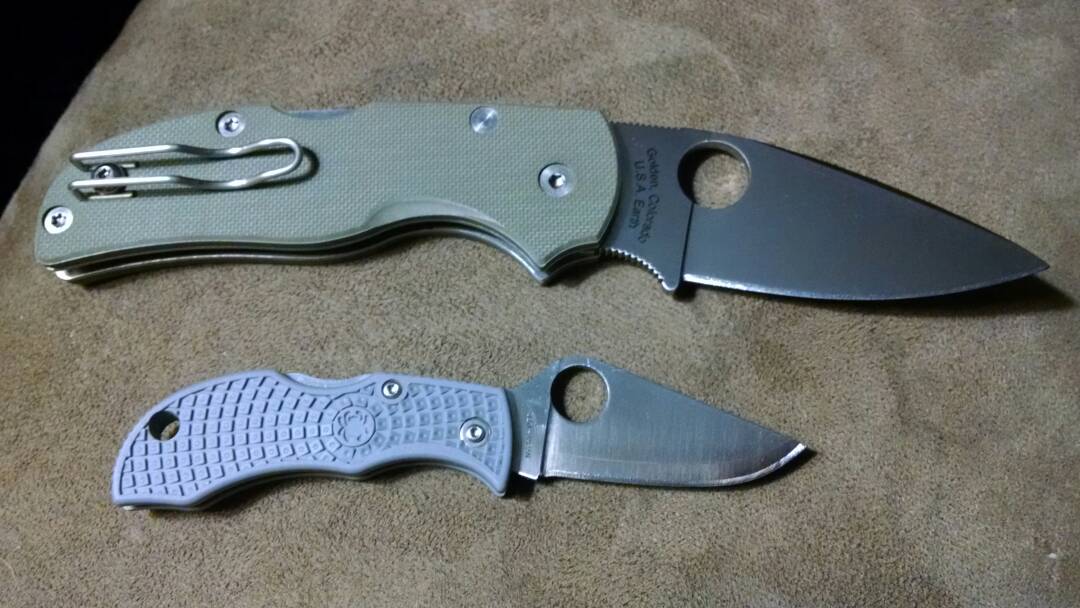

It's Casey Lynch's design. He came to me with the idea of Ti scales for the Delica and we discussed the PM2 center "hump" ergos as I call it and the best way to get a choil in there. Some time later he had a machine shop ready to do the work for him. The choil feels as good as any regular one. He did a good job with the small details and the execution.

A wire clip MOD could easily be ported over to the design for those wanting that.
Casey Lynch's Ti scales are a fantastic Delica treatment! He accomplished virtually the same design outcome by eliminating the liners completely.
I started out with my efforts to come as close as I could to a Para 2 without the necessity to make alterations to the Delica hardware. A simple scale swap for a major appearance change. However... for those having the abilities... this design requiring liner modifications is absolutely doable on my end.
Yeah that's right, the liners are removed on my Delica and that allows more flexibility with a complete redesign. So you are talking about materials that need to keep the support of the liners only then? Is it more for simplicity, or are you trying to keep cost down? I can see that hard line to follow is using the stock liners.
