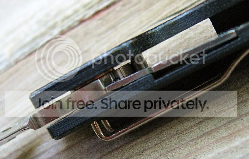

The polished flat G-10 handle scales are reinforced on both sides with recessed skeletonized steel liners, and the locking liner has enough spring force to inspire confidence. It requires a very firm press on the liner to disengage the lock, so an unintentional release is unlikely, even when positioning your index finger in the handle cutout for some extra grip purchase. The detent is crisp and retains the blade firmly in the closed position.

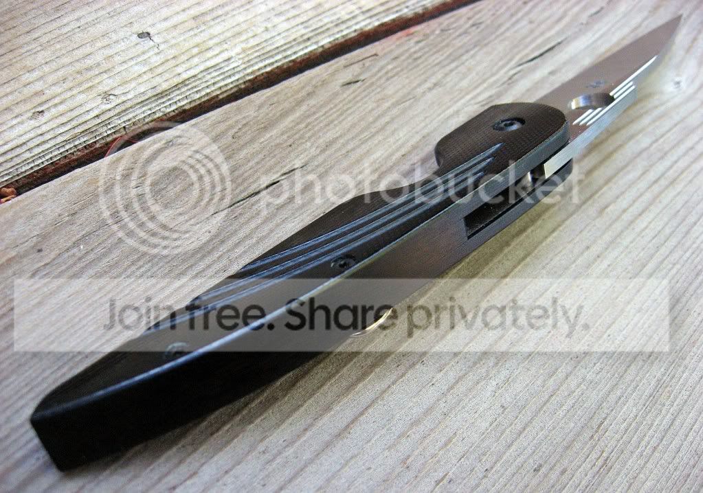

The .40" thick handle feels somewhat boxy in the hand, though not uncomfortable, but I would have preferred that the edges were more deeply radiused to further enhance both the ergonomics and aesthetics. Speaking of aesthetics, it would have been a nice touch if the locking liner was given a uniform satin finish, since it’s so visually prominent.
The removable wire pocket clip is unusual for Spyderco, in that it's mounted at the pivot for tip-down carry, and there are no provisions for either tip-up or left hand mounting. I've read one or two complaints about the clip interfering with grip comfort, but I have no problem with it so far.

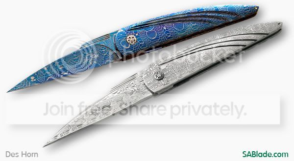

On the plus side, the horizontal corrugated grooves machined above the hole seem to provide enough traction to thumb open the blade without relying on the hole at all, which makes me wonder if the hole, along with its large associated handle cutout, was really even necessary beyond Spyderco's trademark appearance. Many of Mr. Horn's designs open by flicking your thumb across the knurled edge of the blade spine much like striking a lighter, while the custom version of this knife appears to rely solely on the horizontal groove pattern.

The blade locks up firmly, with a solid snap and no hint of play in any direction. The pivot tension (and/or the detent pressure against the tang) is set firmly enough from the factory that there's a noticeable amount of resistance, and while the blade feels uniformly smooth along its full travel, thanks to its bronze bushings, there’ll certainly be no mistaking it for an IKBS pivot.

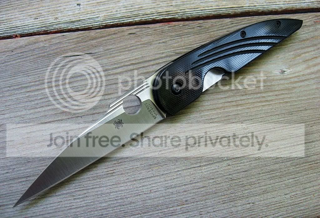

The knife appears larger than it really is in this pic:

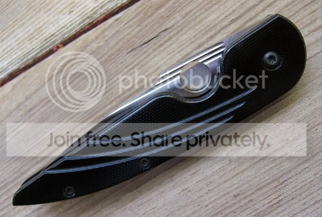

That's more like it:

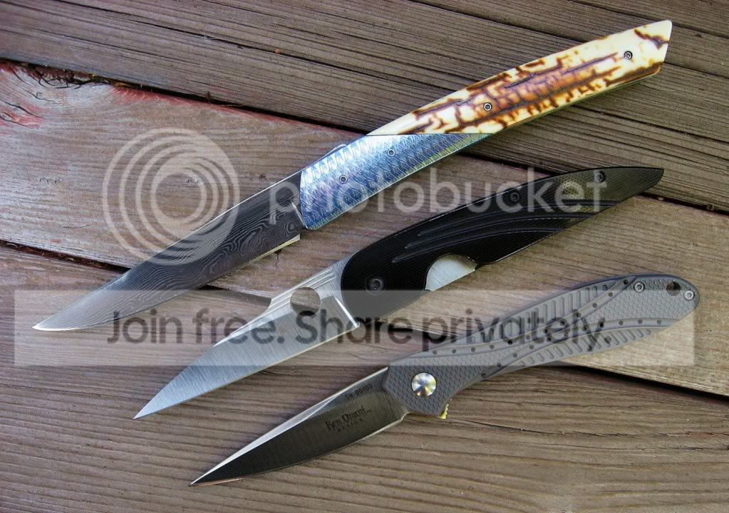

Here's a comparison shot with another lightweight modern gent's knife, the CRKT/Ken Onion "large" Eros, along with a sizable Des Horn custom:
