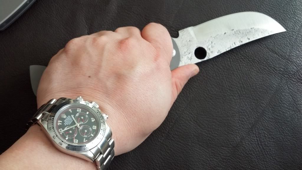

First Spyderco in... yes over 20yrs.. and well, the lockbar sticks majorly and engages at 60-70% (engaging at 60-70% not an issue). The lockbar is so stiff and placement of hand makes it almost impossible to close one handed... The detent is very stiff and gritty. The "Spyder Hole" has sharp inside edges.. no edges knocked off, no chamfering or rounding. I still don't like that it was made over seas. All of that all really bums me out..
THE GOOD.. The blade is sharp out of the box. The blade is centered. No blade play or lockrock. The lanyard hole tube acts as some structural support and the one screw near lanyard hole has a large tube to help spread out pressure. This all looks good.
I think the way the lock side is made, forces most people with normal to large sized hands to put pressure on the lockbar itself.. This obviously goes against the direction you want to push when trying to release the lock and close the damn knife!

If one thing could be fixed, it'd be how impossible it is to disengage the lock... it is a bit insane. I might send it back, but if this is how the knife is... then...
Hello Chris,
Here is the info, just so people will understand more regarding the tension of frame locks and liner locks.
when I make the custom version I can either set the lock a little tight or a little on the easy side, it is a simple thing to fix (that is if you wish to change the factory spec) ,
It is up to you if you wish to do this, please ask about warranty side of things, but it is a simple thing, you can simply take the knife apart, take the lock stabilizer out, bend the lock bar just enough, so you have less tension, so it goes across a little less, the way I have done this in the past is to make sure the lock bar only goes across 'just pass the full thickness of the blade + the washers, this works for me. I hope you understand what I mean.
The lock should be a 'solid lockup', it may not be to everyone's liking but it is a perfect lockup but the tension can easily be changed.

When I got mine I noticed it was tight right away, but figured it was supposed to be that way. I have seen one other well known custom maker do this. It breaks in very nicely and in fact mine is already beginning to close /unlock much easier. The grinds, edge, finish and everything on it were all first quality. This was the first clue I had that the knife was supposed to come a little tight. Mine was sharp enough that it bit me twice which is not something I usually have happen.
Overall I'm very happy with mine and feel fortunate to be able to get one of the first ones.
As far as taking it apart to adjust it only do it if you are good at that sort of thing. You can violate your warranty by taking it apart and working on it yourself. That is standard through much of the knife industry. It's realistic though. If someone damages it why should Spyderco have to pay. On the other hand if you take it apart and know what you are doing I've heard of the W&R still giving warranty service on items that truly are defective and not something buggered up by the new owner.
If the knife comes to you really with a lock that you can't close safely it would probably be best for ham handed guys like me to send it in rather than try to fix it causing it, or some other part to get worse. I stopped working on my car decades ago because of my tendency to break bolts, or have parts fall into places they can't be easily retrieved from. Perhaps that came from working on the railroad and also building bridges where tools were pretty large, and sockets were as big as my head, wrenches were 4 foor long or more. :)

I have no issues disengaging the lock one-handed. It's definitely on the solid tough side and you need a strong thumb. Lockup is solid at 70% and not moving. The lock stickiness is gone. Seemed more a function of the tight lockup. Very solid construction. Very light for how big it is. The big donut standoff at the bottom is quite a pillar of support.
