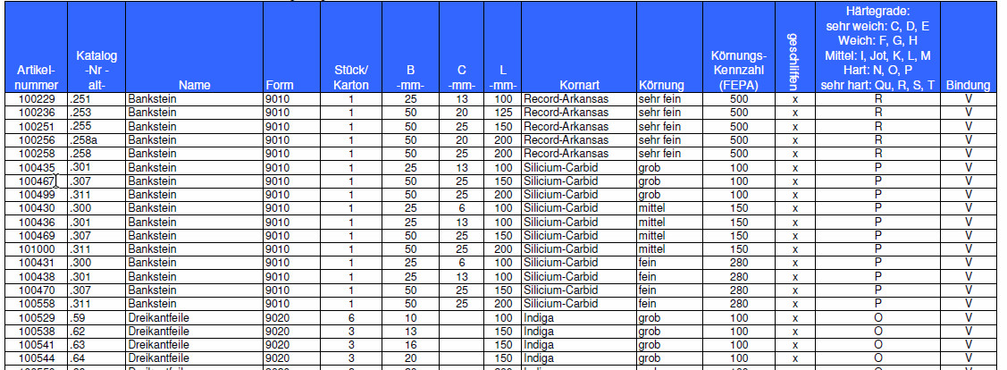

I don't have the Norton India, but i have several artificial arkansas stones by a german manufacturer named LAPPORT. On their stock list, they rate it at hardness "R", which is almost at the top.
They produce "Indiga" stones, and the name is obviously a hint on what to expext, they are rated "O" which is still hard, but a full hardness level lower than their "Record Arkansas". And if i compare the Lapport Arkansas to the Spyderco, it is still quite manageable. It takes a while to flatten them, but they are only a little harder than an average siliconcarbide stone. Since these artificial Arkansas stones are still a bit porous, it is not wise to lap them with SiC grain smaller then F220 because smaller grains will clogg the pores and make the white stone grey, quite a mess to clean without resurfacing it completely.

Be assured, anything expensive would have meant a prohibitive price tag, and these stones are quite affordable, think half the price for a japanese 1K stone. The artificial arkansas they produce contains mostly standard corundum, Al²O³. The binder should be some standard silica binder for hard sintered ceramic stones, nothing fancy.
The term "hardness" for stones doesn't necessarily refer to the particles, but more to the toughness of the binding. The more binder is added, the tougher the final stone is.
