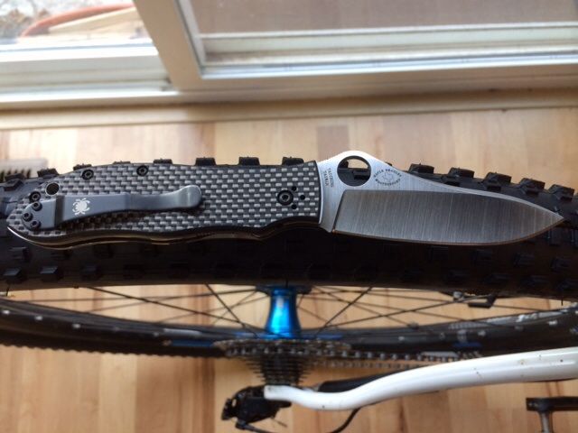

When I pulled the GB out of the box, I thought "man, I thought it'd be bigger". This is not a big knife! In fact, it is almost identical in size to the Paramilitary 2, but weighs a great deal more.

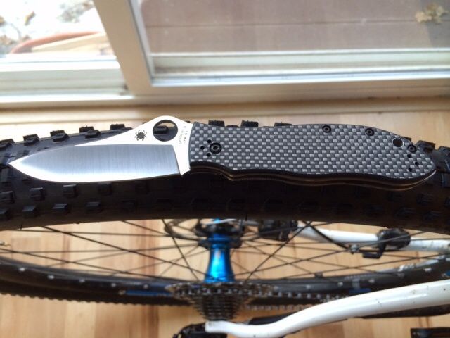

It is definitely an attractive knife.

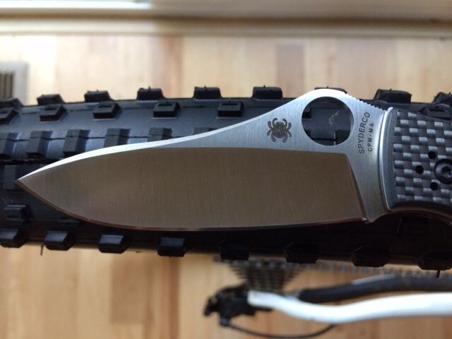

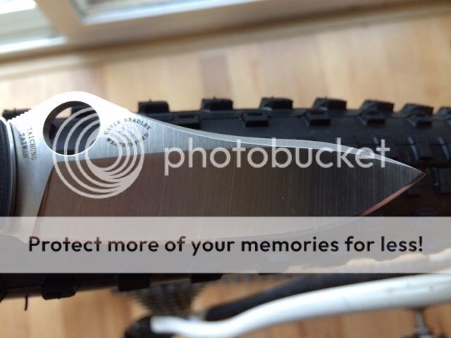

The blade is a unique shape, and almost all belly (no straight edge). The CPM-M4 was the whole reason I bought this knife, and it doesn't disappoint. The hollow grind provides a very thin blade behind the edge. The factory edge was sharp, but uneven, so I put a 17 DPS edge on with a 20 DPS microbevel. I finished both edges with an ultra-fine stone and a bare leather strop. The result is an absolutely SCAREY sharp blade. This is by far the sharpest knife in my collection. I went to test it on some hair and it shaved 3mm above the skin, and whittling almost everything it touched.
One qualm: The tip is actually thinner than the tip on a Paramilitary 2, which is already pretty thin to begin with.

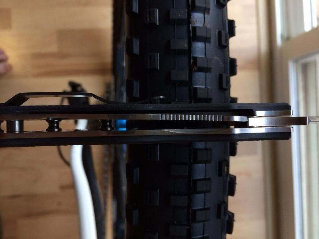

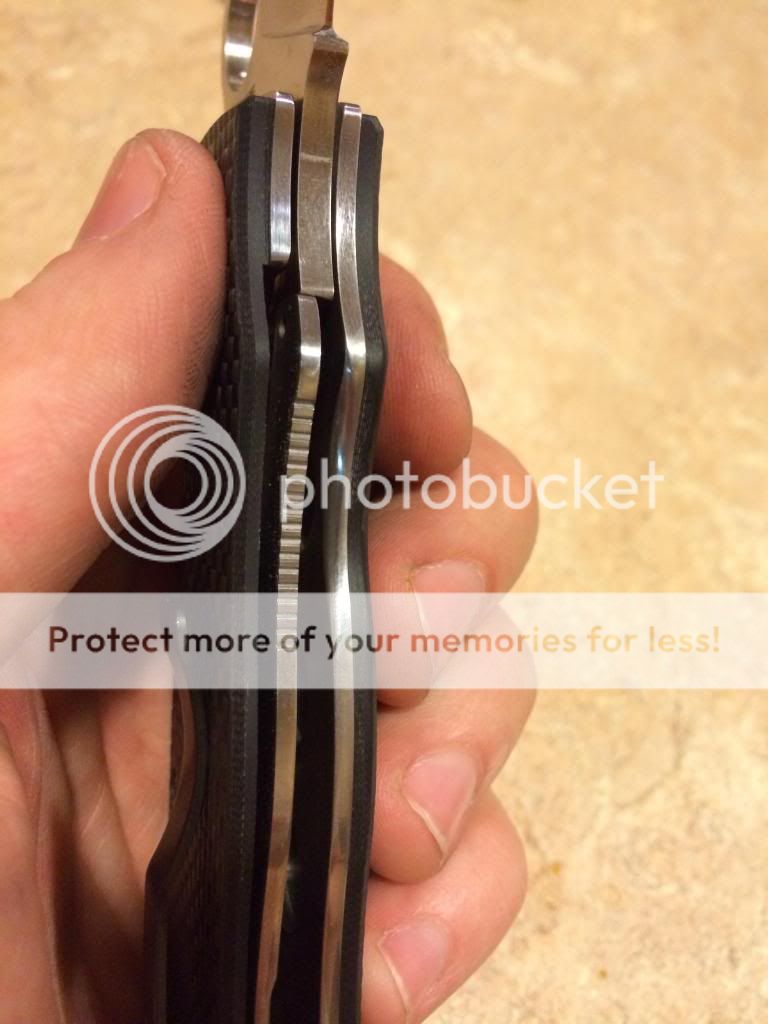

Onto the biggest complaint about this knife other than weight: The lock. I have watched the Gayle Bradley interview where he explains why the lock is so hard to use, and I understand the reasoning, but damn... This lock will make a man out of your thumb.

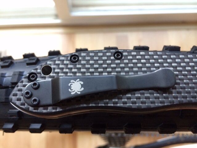

Taichung products have been known to have "edges" on their finished product, and this is no exception. The edges of every surface, save the swedge, have not been sanded or rounded in any way. When I wish to disengage the lock, I am putting a fair amount of force onto a stiff lockbar, but more noticeably, the sharp edge of the liner across from the lockbar. I sat and played with the knife for a bit after I got it and after roughly 5 minutes, my thumbprint felt like it had been smashed in a door. If any of you have played a guitar after letting your callouses go away, it's just like that. I'm almost certain I will be doing the Dremel mod to this knife.

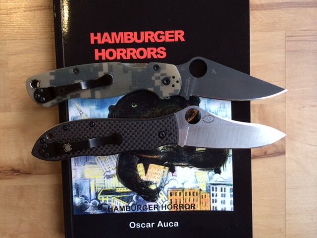

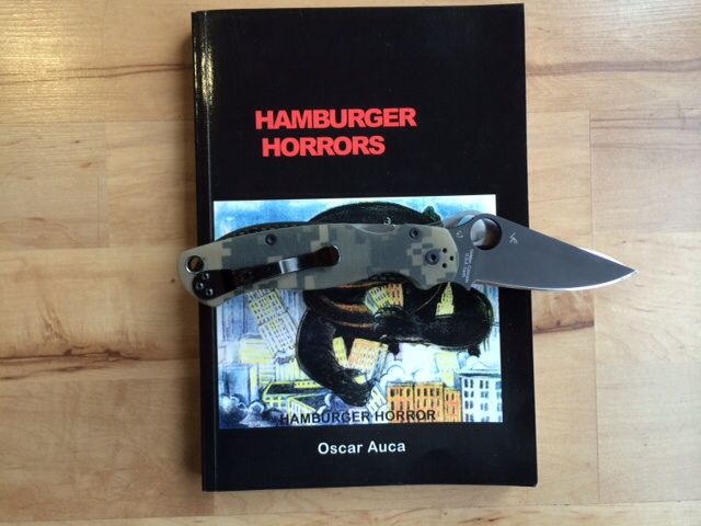

When I said it's almost the exact same size as a PM2, I wasn't kidding...
This is my PM2 sitting on top of the GB

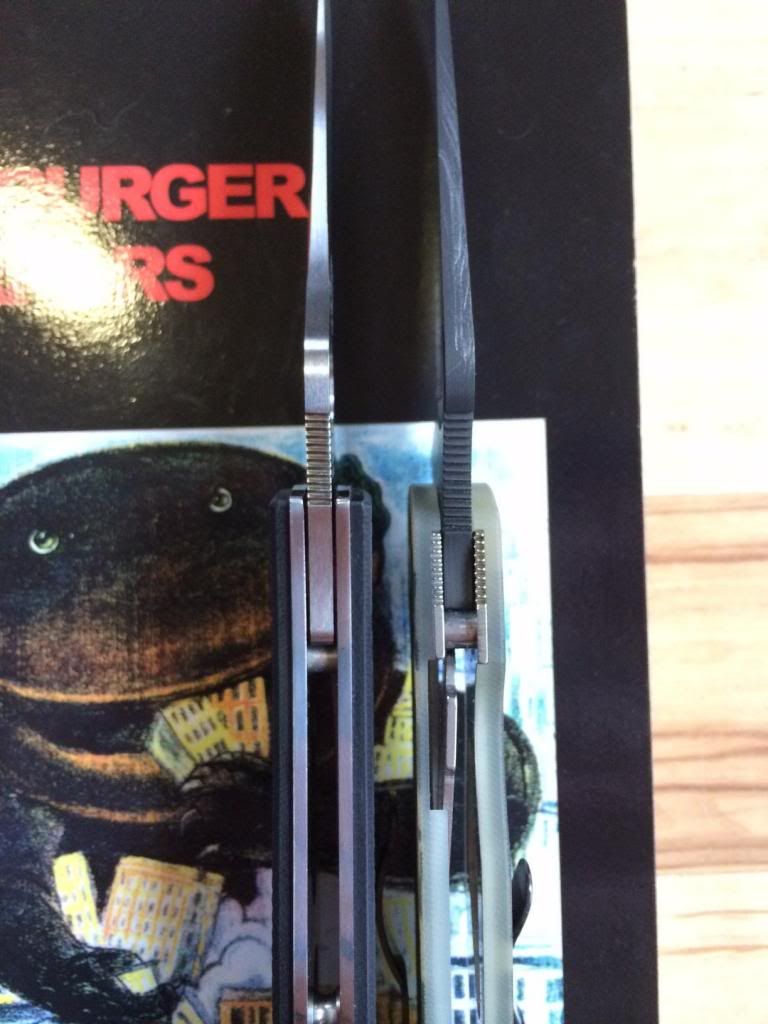

The GB is a tiny bit wider in the handle, but the blade is slightly thinner

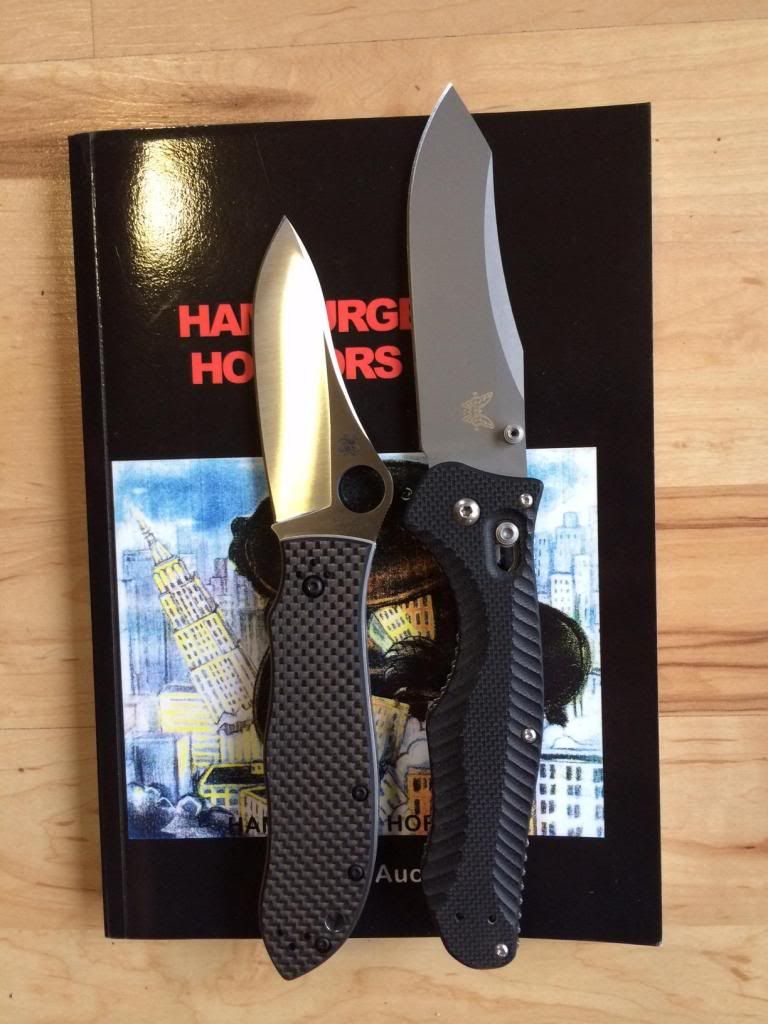

The GB next to my other M4 blade, the Benchmade 810. The 810 is basically just a sharpened M4 pry bar that folds. Cutting tasks definitely go to the GB, but "abuse" is the 810's MO.

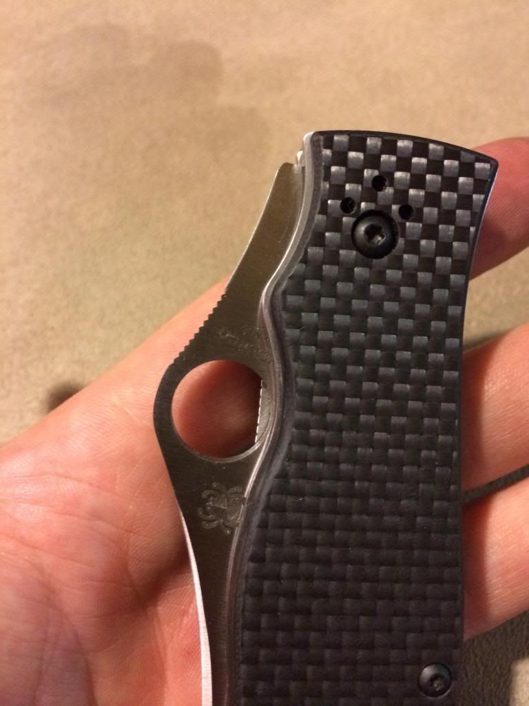

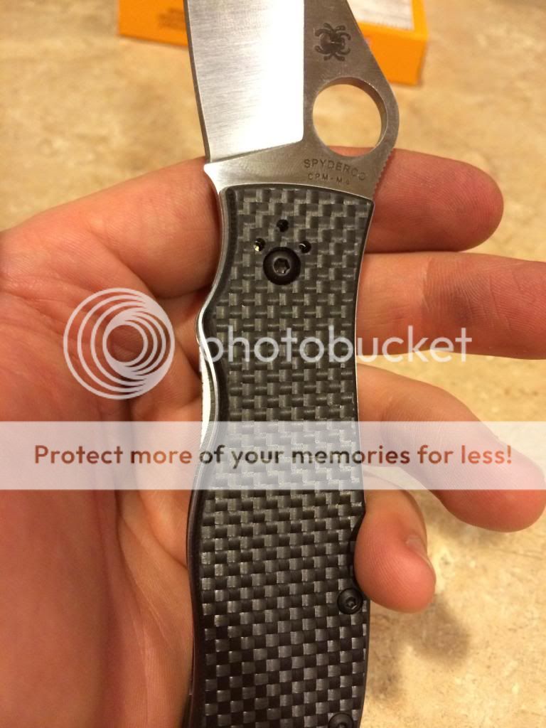

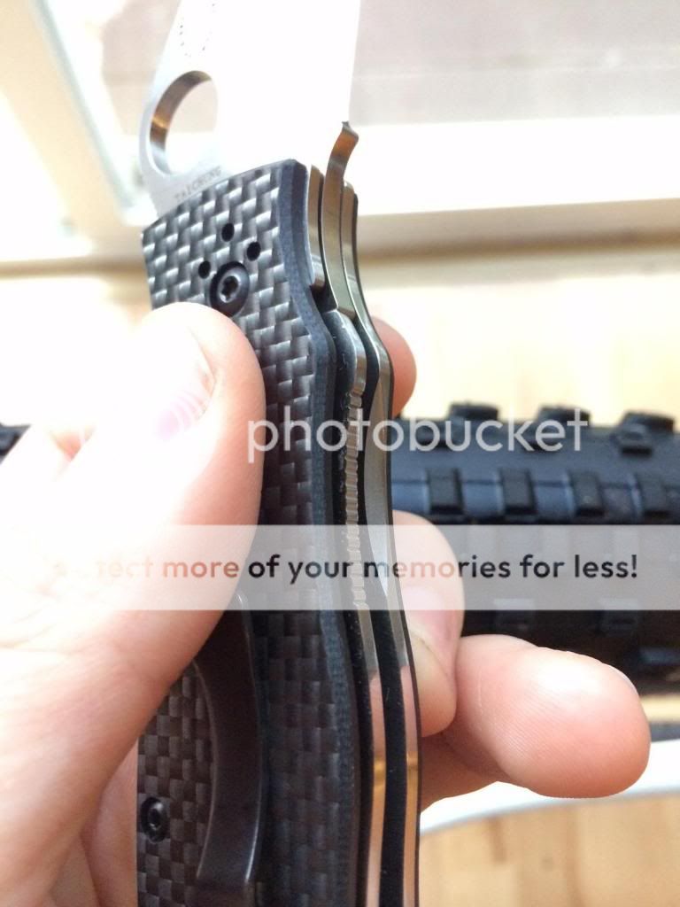

I had the mod done, and it transforms the knife. Not only do you get good access to the liner like God intended, but the Spydie hole is no longer occluded too. Double bonus.

Man, I tried to get along with the lock without modifying it. My dainty hands just couldn't cope. 45 mins with the Dremel and some 400 grit sandpaper really did make this a more usable EDC knife.
Nice mod, but I have to disagree. I got a GB precisely for the no cutout, as previously I have disengaged the lock accidentally and do not want to repeat it again.
OTOH, I'd agree that it does make the thumb skin ripped ;)
YMMV I guess, it's your knife (and mine), most importantly: enjoy!
PS: I got the original non skeletonized liner :D
Nicely done.
I can see it both ways. One of the things I love about the Ti Military is the huge cutout for lock access.
