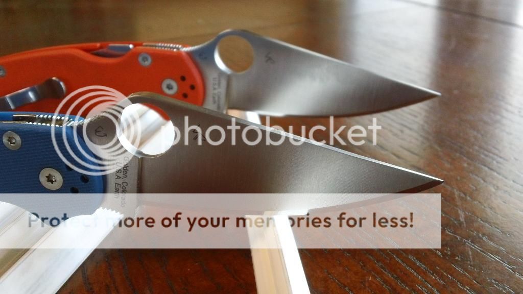

I do the exact same thing. No problems at all. I use the 400 grit stones and they reprofile M390 quickly. Phil Wilson uses silicon carbide stones on even more wear resistance steels as well.
Very nice! Is that the WE system and what angles did you use?

Thanks. If I recall both were 12* per side. I just clamp the MM stone on The Sharpmaker stone. I don't do strokes when I rebevel, I sort of scrub the stone. Jdavis has a video that shows the technique.
