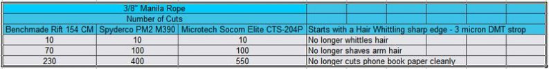

I'm a bit of a steel junkie. I like different steels for various reasons...but I like high wearing steels most of all. So when I saw the Socom Elite Youtube vid of Crimesontideshooter testing the Duratech 20CV, I got interested in testing other variants of M390. I couldn't find any 20CV, but then found out that for 2012, MT released some blades in CTS-204P. In short, I tested my Spyderco PM2 in M390 against my new Socom Elite in CTS-204P.
Test Scenario:
Both edges sharpened with an EP to a 30 degree inclusive bevel with a 3 micron finish. Enough to be hair whittle sharp. When sharpening, there were no apparent differences between the steels that I could tell. I will say, the MT factory bevel seems a bit obtuse...maybe 40 degrees inclusive or more. The Spyderco factory bevel seemed to be right at 30 degrees. I regret that I did not test my Socom BEFORE re-defining the lower angle, 30 degree bevel...oh well.
I went to my local hardware store and obtained some 3/8" manila rope. I would like to have done my test on 5/8" rope since that seems to be the more common practice...but there was none available.

To define sharpness, I made 10 cuts then tested the blades (at the point of use) to see if they would still cut specifically defined items. I tested sharpness by testing 1) Hair Whittling sharpness 2) Arm hair shaving sharpness 3) Phone book paper slicing. I stopped at phone book paper since I consider my knives dull if they cannot cleanly slice phone book paper.

I cut the rope only using the belly of the knife. I defined 2" of the blade with which I would do all my cutting. I didn't want to cut with the whole length of the blade since a longer blade would then out cut a short blade, all things being equal. Also, I would have to cut more rope if I used the whole length of the blade...I'm getting older and that would hurt my poor little hands...
Finally, as a control to make sure I wasn't fooling myself into the results, I threw in a third knife in to the test to force a different result. My "control" knife was a Benchmade Rift in 154 CM. It is convex, hand ground to a thinner edge. Again I used this only to force a different result and realize that the different geometry makes this and apples/oranges comparison. But then again...I wanted a different result.

Results:
If you're the impatient kind, you've already scrolled down to see the "winner". I will say that I'm sure there are variations and "operator error" in this, but the difference is enough that I would say I think there is a "winner" here.
The MT CTS-204P cut longer than the Spyderco M390.
At the end of the test, the Spyderco simply dulled...no chipping or rolling and the blade was in good shape. The Micro tech did have some noticeable micro-chipping. Not horrible...but they were there. Perhaps that micro-chipping contributed to the cutting efficiency and positively impacted the results of the MT ( I don't really know, but it's a theory). I know that Crimsontideshooter found ZERO edge damage on his test of the Duratech 20CV version, but he may have had the factory bevel (darnit again I regret not testing it at factory angles). The BM also suffered micro chipping.

No, not in this test. The rope is not thick enough so even moderate geometry difference would not have any serious impact on the results. But the setup is excellent for the edge retention test. I am actually glad that the author reprofiled the MT. Thus, both steels have equal chances, and it is obvious that Carpenter made super steel again.
Blade geometry has a big factor in those tests
Thank you for the test. Very interesting, but I expected Carpenter's steel to be superior.
Why would expect it to be superior?
I am wondering that also.....
Without HRC testing it's hard to say...
A point in hardness could make that much of a difference in the results.
That said M390 and 204P, both at the same hardness and in like blades should perform about the same..... They didn't in this test so other than blade geometry something else is different, likely HRC hardness and or thickness behind the edges.
Same as S90V and 20CP did at the same hardness (60 HRC) in the same model knives (Para 2's), they did exactly the same in my testing.
36% is a huge difference in performance taking into count the same alloy content of the steels so something is going on that is different.
^ Agreed, I would think hrc is different or the thickness behind the edge to show that much difference
I am wondering if the better edge retention and micro chipping may be an indication of a hardness difference. I cannot claim that CTS-204P is or isn't better than M390 but I do like the MT over the Spyderco for the two specimen I tested.

Something I would have to see to tell what is going on with the edges..
M390 and 204P should be VERY close in performance from the alloy content.
It is just my subjective opinion based on using Military M390 and Whaleshark in CTS-204P, MT seems to hold its sharpness noticeable longer. I think that the difference is in the heat treatment. A friend of mine tested Para 2 S35VN and Socom Elite in the same steel on manila rope. Para 2 did 130 cuts before it refused to cut paper, MT did 200 cuts.

That's a 50% increase... ;)
Could be a number of factors going on to cause that much of a difference like I posted above, or a combination of them.
Just thickness behind the edge alone can really make a huge difference.

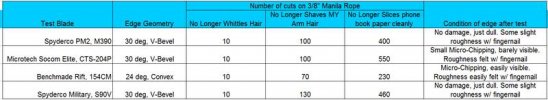

Since there seems to be a somewhat unexplained difference in performance (except maybe more metal behind the cutting edge), I tested my S90V Millie (usually a drawer queen). I also reformatted the table for easier (and more space efficient) reading. From cutting with M390 (and CTS-204P) to S90V, I get the feeling that S90V will keep a working edge for a VERY LONG time. Edge retention seems comparable to M390...but it just seems to have more bite even though it would no longer slice phone book paper cleanly. S90V demonstrated no edge damage, like the PM2 in M390.
I LOVE the fact that Jim has done his rope cutting tests to rank the steels...but I want a better understanding for myself of how good these steels are. Since I'm doing it, I'm just sharing with you guys so you can take it for what it's worth.

I think it's great what you are doing. :)

Thickness behind the 30 deg bevel I measured:
PM2: 0.033"
Socom Elite: 0.030"
Military: 0.030
As before, I am sure there are some measurement errors...but those are pretty close to me.
I think the steel could be equil if given the same heat treat.
My Ultratech is harder than I have ever heard that S35vn is capable of; I would estimate the Rockwell around 62.
If Microtech can do that with S35, I bet they gave a hard treatment to the CTS-204p also (maybe the reason for the micro-chipping)
Two factors: behind the edge thickness (socom's edge is thinner), and HRC. Microtech runs their steel about two points higher.
