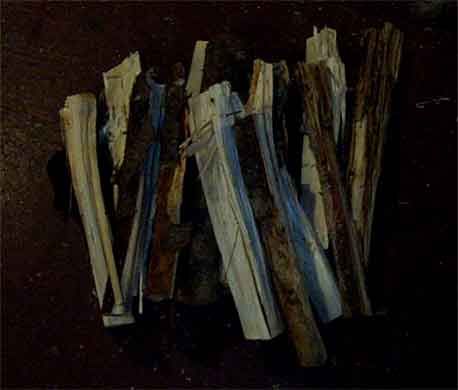

The ones I buy and the ones people (users and makers/manufacturers) send me. I had to hit the Military very hard to get the lock to bend, about 25 ft.lbs many times as I split several rounds of knotty wood. This level of impact energy will for reference will drive a 3.5" nail right into the side of a piece of spruce 2x4. They were also too heavy to use a piece of 2x2 spruce as a baton as it just cracked off, I had to use an actual round. These were heavy elbow swings, just using the wrist was fine :
http://i7.photobucket.com/albums/y269/CliffStamp/Spyderco/military/military_splits_wrist.jpg
elbow :
http://i7.photobucket.com/albums/y269/CliffStamp/Spyderco/military/military_splits_elbow.jpg
final lock condition :
http://i7.photobucket.com/albums/y269/CliffStamp/Spyderco/military/military_liner_bent.jpg
The liner was also mushroomed flat on the top from pressure off the tang. Impressive performance to me anyway in that how it failed and the nature. In its current condition it is still a perfectly fine knife, it is just permanently open. I was also fairly impressed that the tip didn't crack off as I went through two batons during the above because it is fairly thin and was actually sticking right into the baton during the impacts, chopping through them readily.
Note all of the wood was full of knots, I had three wedges carved with the Military which were used to crack the worst wood. I made the wedges from pine just to see if it could be done. They had to be reshaped after every 1-2 logs and cracked off several times, but even a weak wood can be used if it is all you have. The critical thing it to not be hesitant in the impacts, if it is too light the wedge will bounce in the crack and crack off, you need to hit it hard enough to drive it in deep enough to prevent any elastic responce from the wood.
