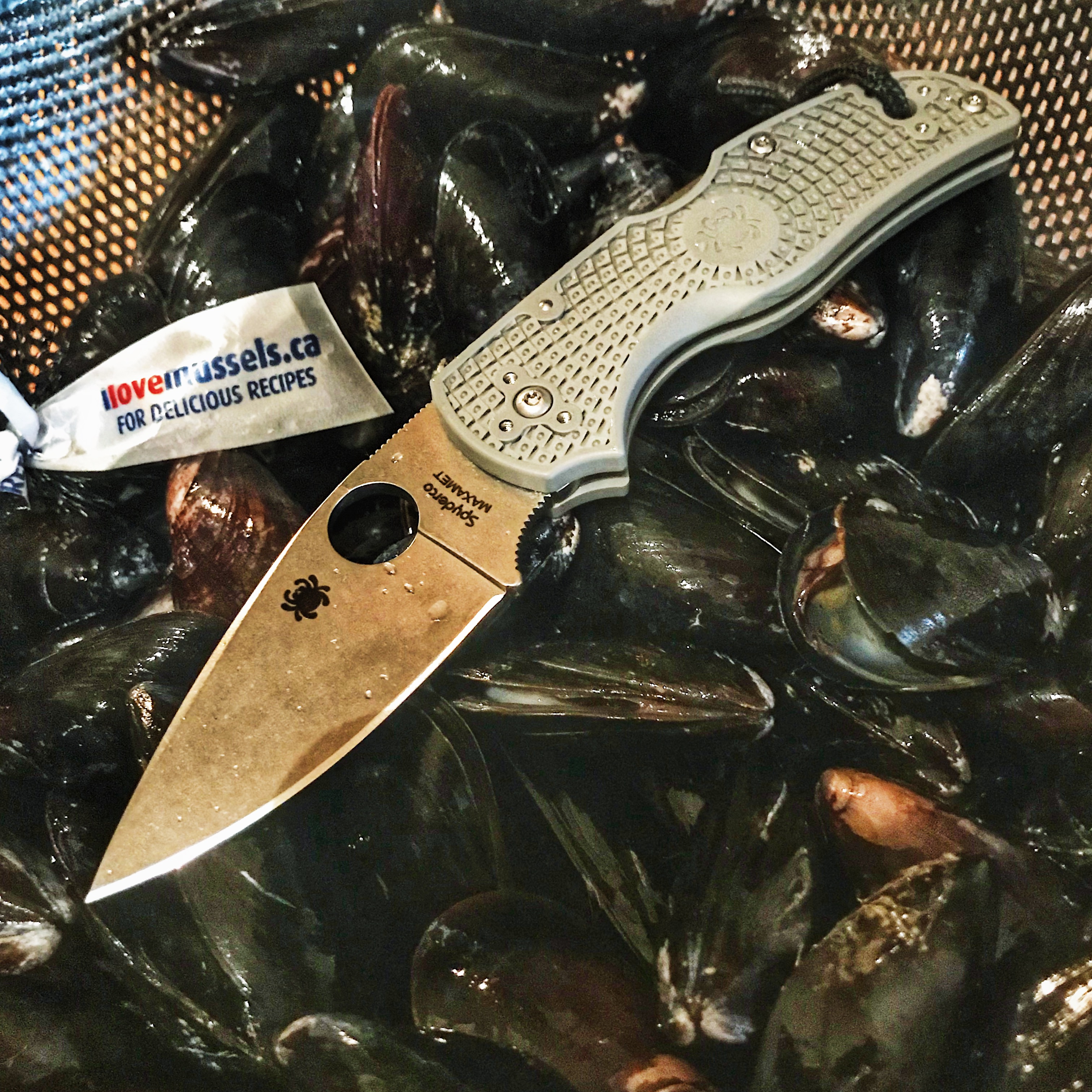

Had this for a day and it helped with dinner today. This steel has an interesting “feel”, it is very aggressive on meat and fat. It’s started to develop a bit of patina after contact with some blood. Used it to open up some bags of mussels and the salt water had no ill effect.
I’m liking this native more than any other native I’ve owned.
Yes stonewashed. It’s my favorite Native blade finish. The edge on the hole are not sharp and the blade feels very smooth.
