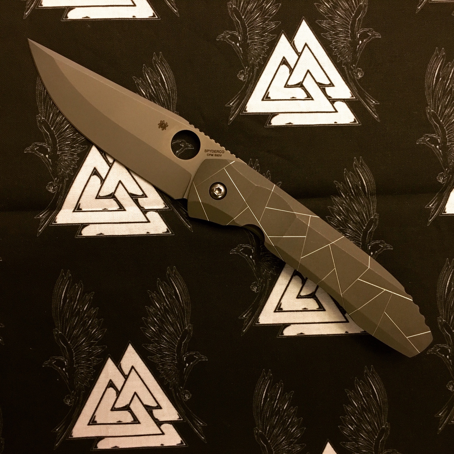

I recently got this Spyderco nirvana. I love the look,feel, and carry of this knife. S90V is amazing blade steel and it being a integral is cool. I really want to keep this knife but it has really bad lock stick. I tried searching the web for a solution. I did put graphite on it and it did make it some what better. But so do I have to do this now all the time or will it go away? If anyone has dealt with this can you please give me some advice. I love Spyderco, this is actually my 36th knife of theirs that I have owned and have only had issues with two others that were fixed by Spyderco hassle free. I want to keep it but is this something I need to send to Spyderco to have them fix? Or is this something I can fix myself?
Does the Nirvana have a steel lock bar interface or is it just titanium that hits the blade tang? If it is titanium then do you know if it's carbidized? If it is just titanium and not carbidized then it will go away in short order when the titanium lock wears into a more suitable position.
No steel lock bar and its titanium hitting the blade tang and from what I have read it's not carbonized. It looks like a lot of other people have had the same issue. The only advice is graphite and I have been doing that but it does not help that much.
Best advice I heard was graphite and flick the snot out of it. Most people said theirs broke in
Send it in to spyderco and let them fix it, they have amazing customer service. Just accurately describe when and how your lock stick symptoms occur and I'm sure they will solve the issue.
Ok I am gonna keep doing that and in 2 weeks if that doesn't help I will send it to Spyderco. I wonder why they didn't put in a steel lock bar insert or carbonize these to begin with. Other then that I really like the knife.
Don't worry. It is a easy fix.
I have fixed two of them in just a few hours. You fingers will be sore, but my technique works. It is best to find a good movie on TV before you start too. Open & Close the ever living crap out of it. Seriously, clean any lube that may be on the lock off with dish soap.
Basically you have it locked open, and use just your thumb to work the lock bar. Focus on the lock bar.
Do this a bunch. If it sounds horrible while you are doing it, it is working. Do this a lot! Then clean it again, and repeat until it is silk smooth. When I started, mine took both hands to close. Also once it locks, push the lock bar hard then unlock, push bar hard several times. It will wear down the surface area in no time. Making it work excellent.
If you put graphite on the blade tang it will slow down the wearing process which will eventually wear the lockbar until it stops sticking. For now just think of the stick as a little side effect of the knife being well made with tight tolerances. It's way better than the tolerances being bad and getting lock rock. Atleast this problem should solve its self.

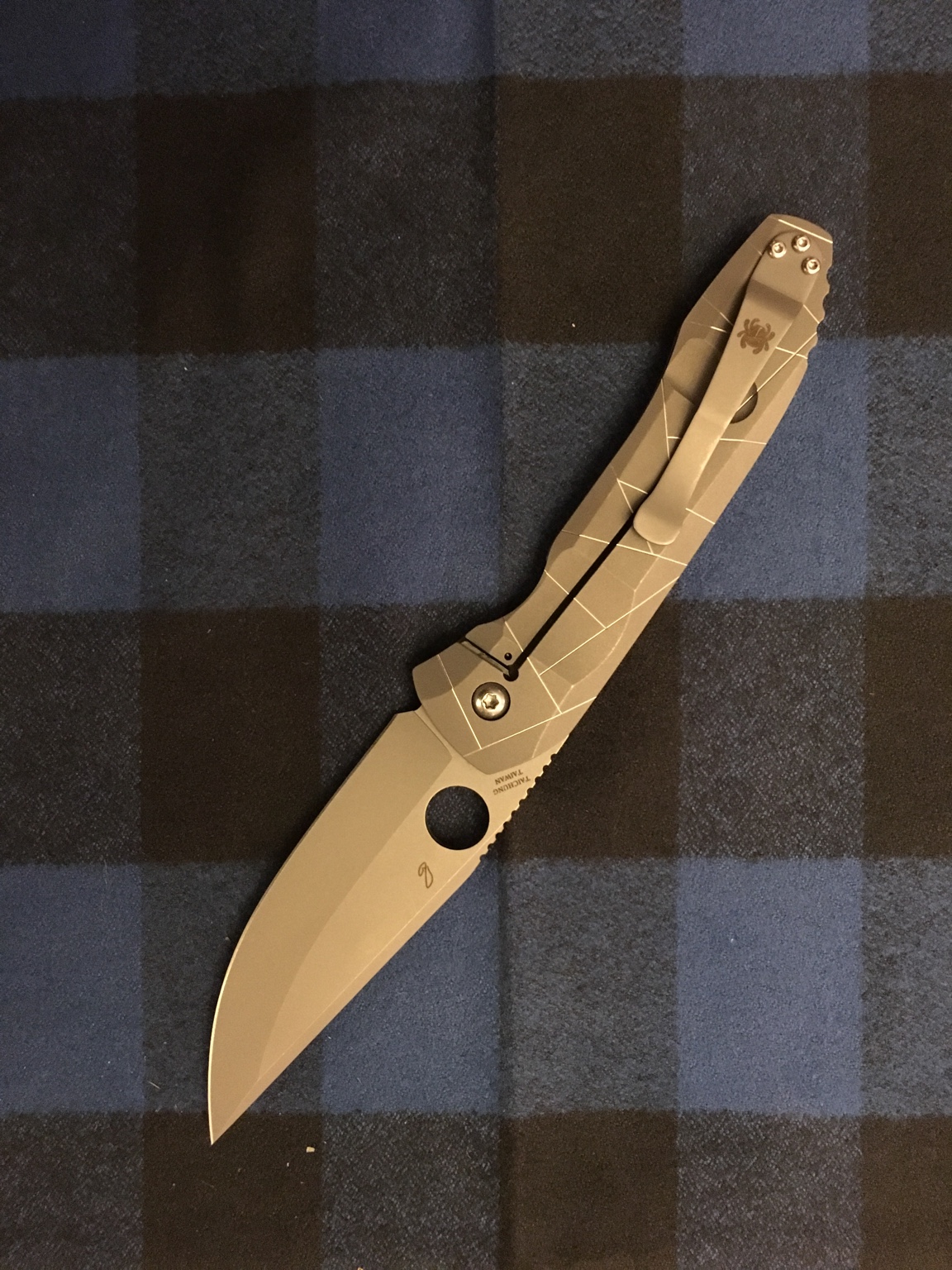

For what ti's worth I had a Sage 2 (another Spyderco Ti framelock) with some lock stick that went away on its own wit regular use. I think yours will break in.
I must have some luck - there are days I certainly don't think so - but I've never had a problem with a Spyderco knife. My Nirvana was fine out of the box, and has only gotten better; I spent a couple minutes the other day practicing, and I can flip it open with my thumb, no wrist action. Closing it one handed is not an issue at all.
