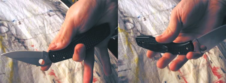

This is for Walking Man, or anyone else who is interested. I didnt want to clutter up that other thread with off topic stuff.
I wanted to show that it is easy to close the knife one handed. I personally think it is as easy to close as a Linerlock.
Here are a couple bad pics of my method of closing my endura one-handed, from two different grip positions. I use the method on the left primarily, and I never use my thumb any more.
(The hand positions are exaggerated in an attempt to show how I disengage the lock, my fingers are usually not sticking out like that. :D )

My Endura also has the Boye cutout, could be that the handle size or shape of the Caly jr. makes a difference, or perhaps our hands are different? Could take some practice, as I kind of discovered this method from endless flicking and messing around with the knife. (I really started playing with it alot after adding Militec) Maybe you could try squeezing the lock with your first knuckle while pressing against the top of the handle with your thumb? Just dont slice yourself :D

I believe Spydercos are designed so that you can point the open knife upwards, press the lock bar with your thumb and the blade will swing down so that the choil hits your fore finger and then you can change the position of the knife in your hand and close it. It is for this reason that the choil is 1 finger wide and left unsharpened.

I close my Cal Jr with a similar method except my index finger is in the hole to push down the blade, that way I don't have to push down the lock all the way down.
