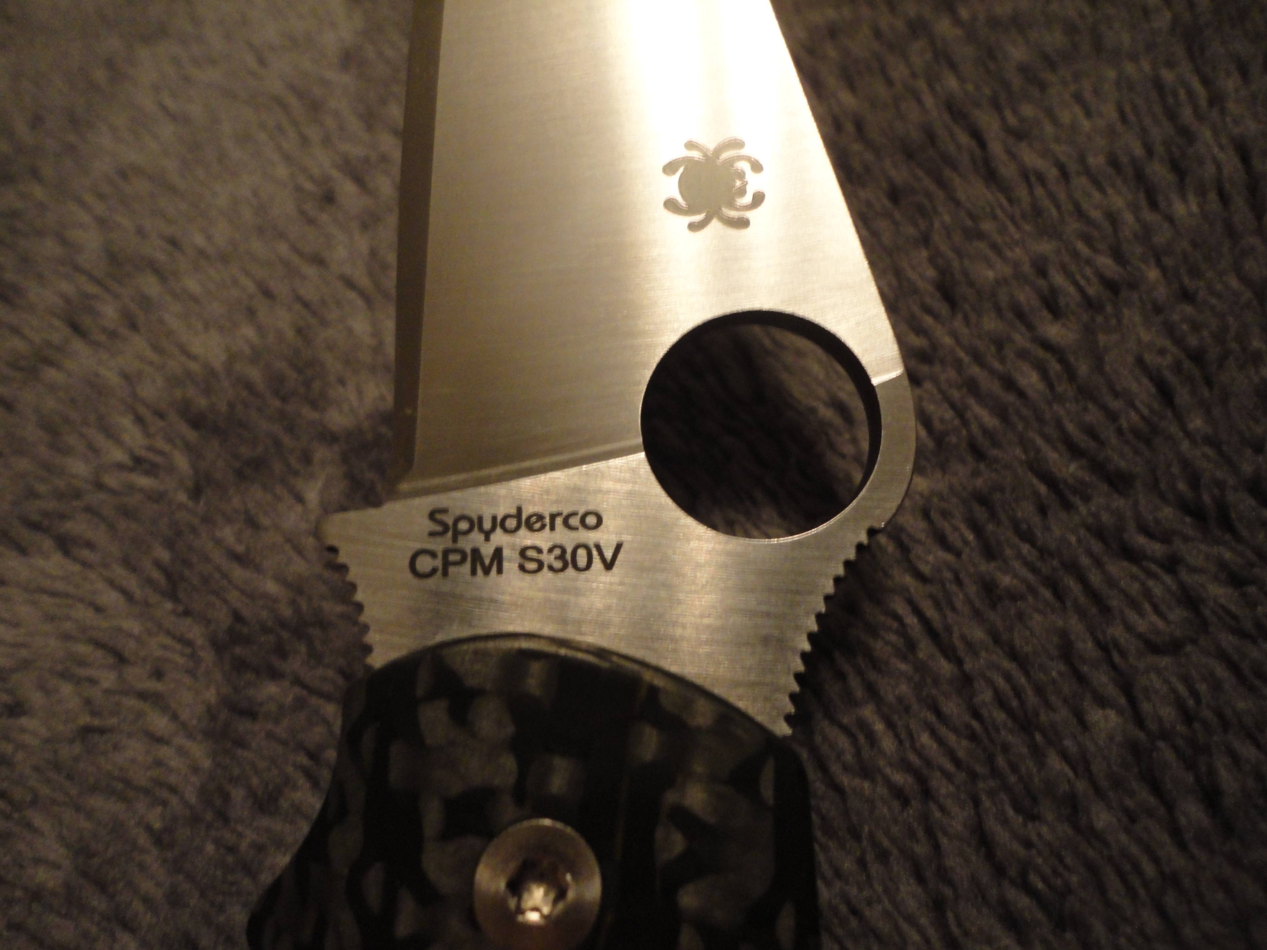

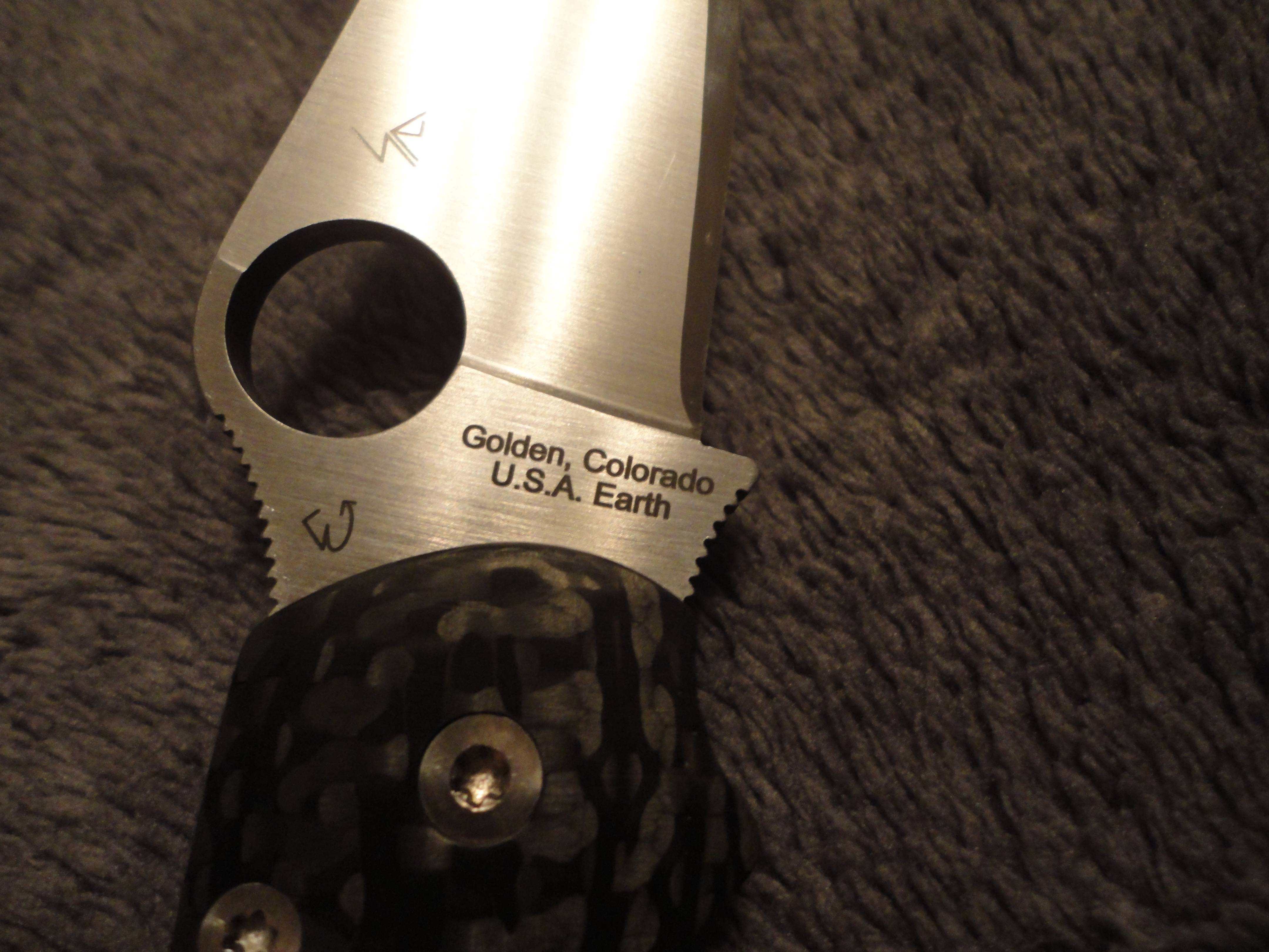

I was wondering if my new knife was a fake or not. It says CPM S 30V on one side. It has a carbon fiber looking handle. Other side says Golden Colorado. U.S.A. Earth
I try and post some pics. Thanks

Well, I just confirmed that fake pm2's in carbon fiber are being sold on the Chinese site that sells lots of counterfeit goods... The pics show the blade marked s30v. This problem keeps getting worse. Unfortunately, I think it is likely that the OP got one of the new fakes.
I think it is a very good fake. To bad, I really wanted a carbon fiber spyderco knife. I guess I should have done more research. I only bought a few things off ebay. I guess this is what I get for an impulse buy. Now I am forever scared of buy any knives off the internet.
I'ts fake, one of the giveaways is the not inclined jimping.
I've seen better fakes tough...

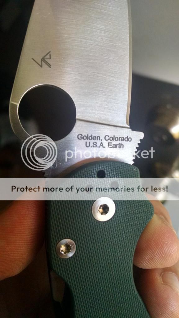

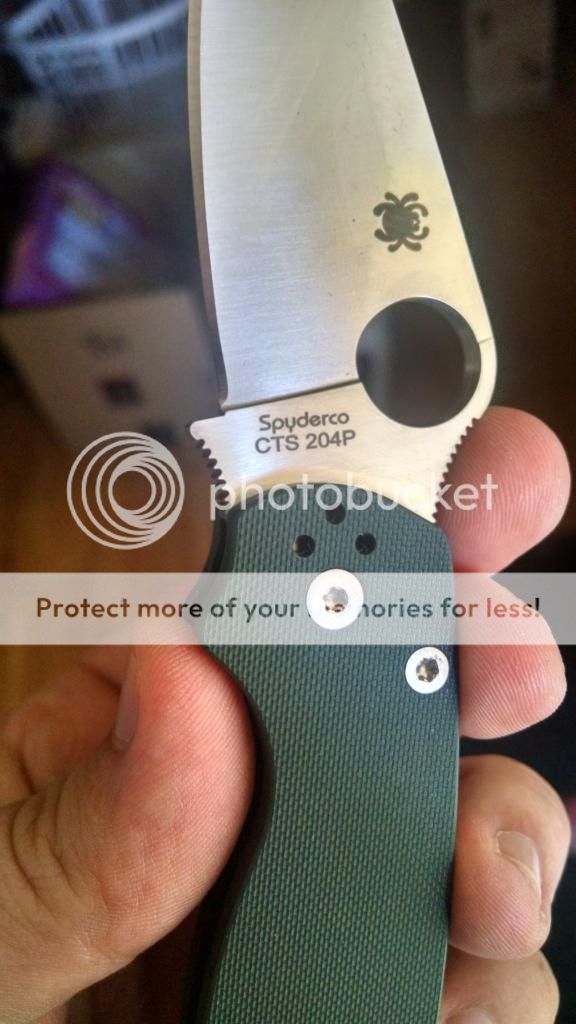

I took a couple up close pics of mine to see exactly what looks different. Here's what I can tell.
- finger jimping on lower blade goes all the way to the handle, on yours it falls short
- FFG line shows lightly above the opening hole, doesn't look like yours does but could just be the pic angle
- there's a comma and a space after 'Golden' and also a space after 'U.S.A.', on yours it looks like a period after golden with no space and also no space after USA
