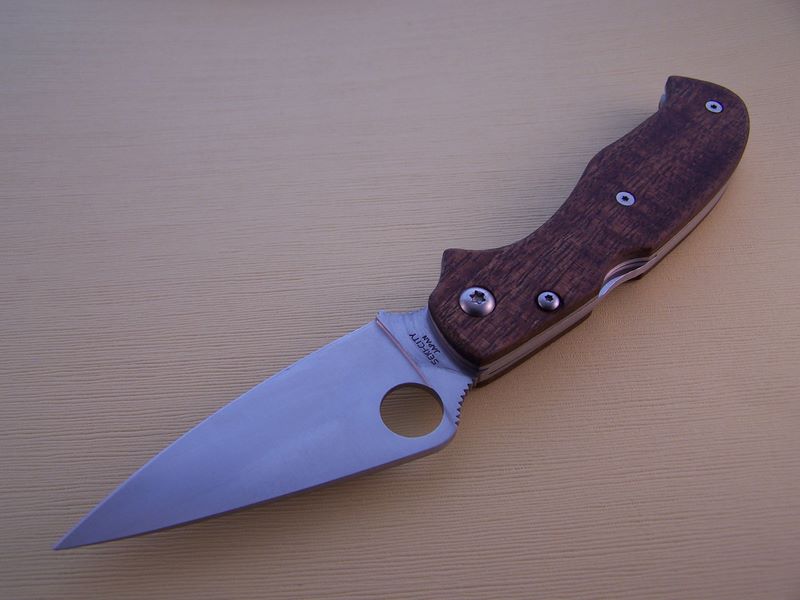

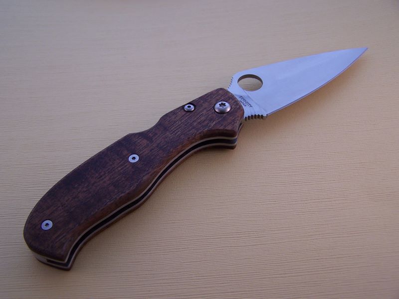

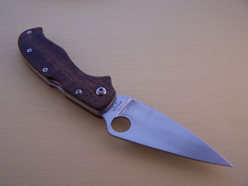

Deacon you are looking at perhaps the single most challenging lock back re-design this guys ever takin' on. There for a while I was like fit to be tied wondering how many more things could come up. It seemed one thing after another but patience and pure stubborn attention to everything that came up one right after another working those out finally won out. Most of the issues revolved around proprietary sizes of both holes and hardware but finally in the end I managed to track down what I needed to do this and the rocker arm barrel and screw set up are all that are Japanese on this shown here.
Final weight is 3.7 ounces compared to the factory weight with the clip on the knife which is 3.1 ounces so it didn't actually gain as much as I expected it to. The tip of the blade has been re-profiled and the Boye detent is milder with a longer half moon sweep now and centered. Lock up is rock solid. The action is smooth and the blade is dead centered when closed with factory snap as it closes and opens.
Not sure what to call this one. Lets call it done and leave it that! :D

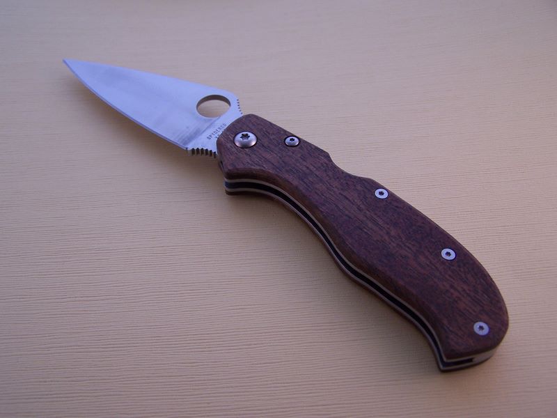

I figured a post side by side with an untouched R2 was a good idea. I may do some additional contouring around the edges on this one yet but I like to carry and use them or at least with one like this keep it handy and use it some getting a feel for it. Once I'm sure of it I'll be in touch for the trip home and squaring up.

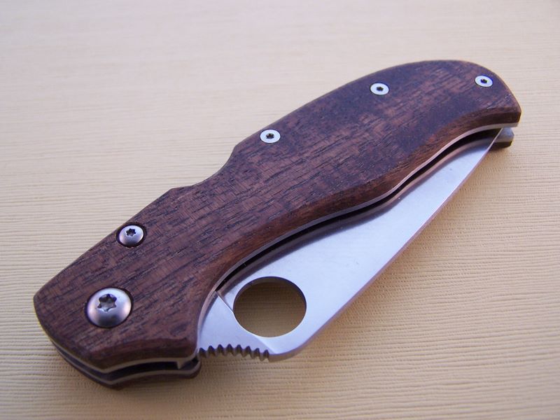

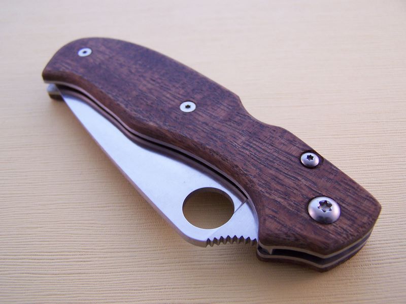

Thanks. I recontoured some and got a much more satisfying bevel around the edges more like your prototype pictures now but knowing how you take pics I'm sure you'll get some that show that better than my camera will. My camera got stuck today on zoom and I didn't even get the whole knife in the shots when it was opened unless I stepped back some and then it would have worked but by the time I realized it jammed it was getting darker out so I may take some tomorrow.
It was challenging. The wood was a easier to splinter and fray than I expected but mostly my later issues revolved around the proprietary hardware and trying to figure out a way to get the factory spring holder rear spacer incorporated into your new pattern. Then the lock bar/rocker arm issue with the barrel, which was the only thing I had that I could use. One side of that barrel I used looks like a screw but its not. The barrel only has one screw and as it turned out that messed with me there some. Then as you may recall from an earlier post, I didn't want to show the three screws holding the spring holder in place in the rear and intended originally to hide those under the scales but in the end it was just not going to work that way. Lockbacks are just different animals when it comes to assembly sometimes and had it had a more rigid washer like a PB washer I could have assembled it and then slid the washers in place for the blade as the last part to put in there but being that the washers are the thin thin thin Spyderco type that are not metal but some other material which I don't know the name for it was not an option to get those washers in place any other way but before you put the sides on. Long story short everytime I thought I had it put together in my mind I'd go to the shop and try and something else would come up.
I hope you don't think I'm complaining. It was just challenging is all. Frustrating at times being here this long but manageable you know? I think this should work out fine though. I'm happy with the end result even if it was a bit tough to get it here. I like the action, the lock up and the feel of it a lot. I'll mail it out to you tomorrow and let you play with it so you can feel it and look it over. Then once I hear back from you we'll square up. I think you'll be pleased overall. I had to shape the handle somewhat more like the original due to the spring holder which I didn't want to remake unless it was absolutely necessary. The factory one is always better IMO so I stubbornly kept that in the design.
