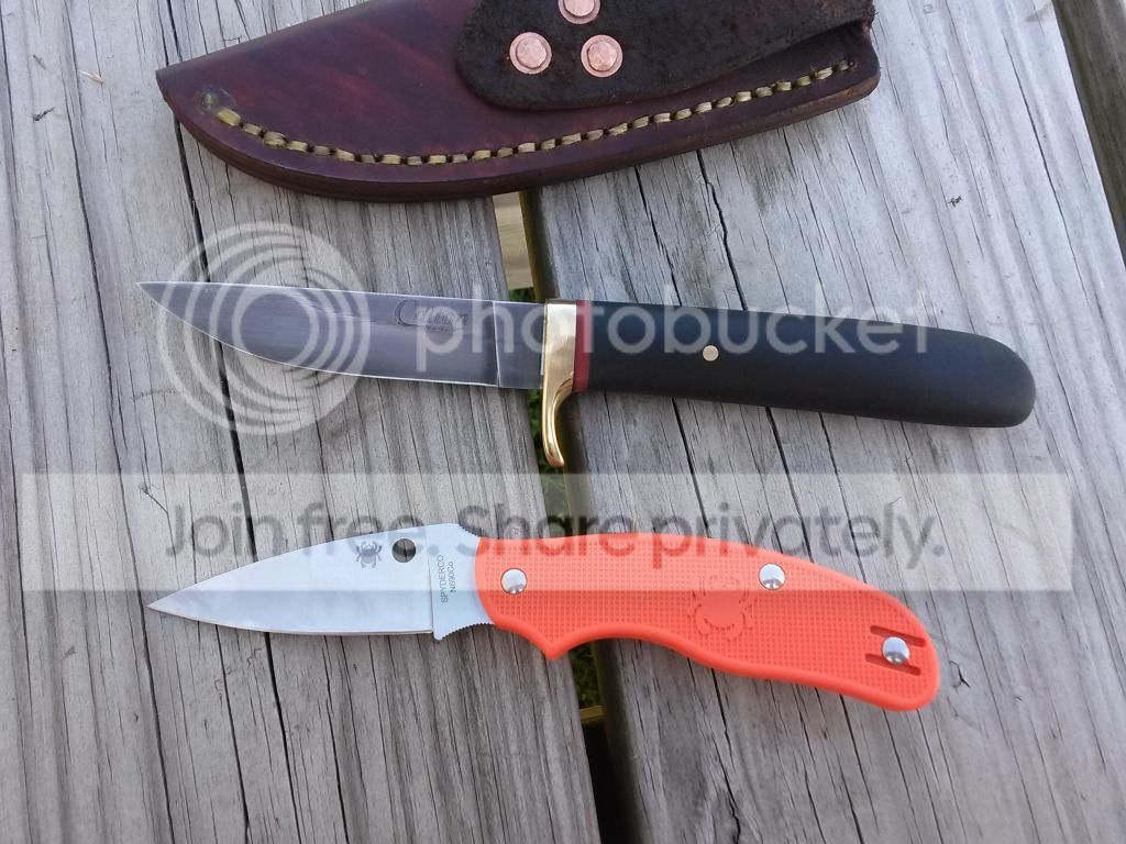

I have some of Joe's work and it is top notch, I wouldn't hesitate to buy more of his work either. His heat treat on 1095 seems great to me, and has done well in the use I have put it through. A few obligatory pictures. This one is .007" behind the edge in areas, which is a pretty large jump in performance. But you can more than likely ask him to keep it in a certain range of thickness too. This is when it was brand new, it doesn't look nearly as pretty now haha.

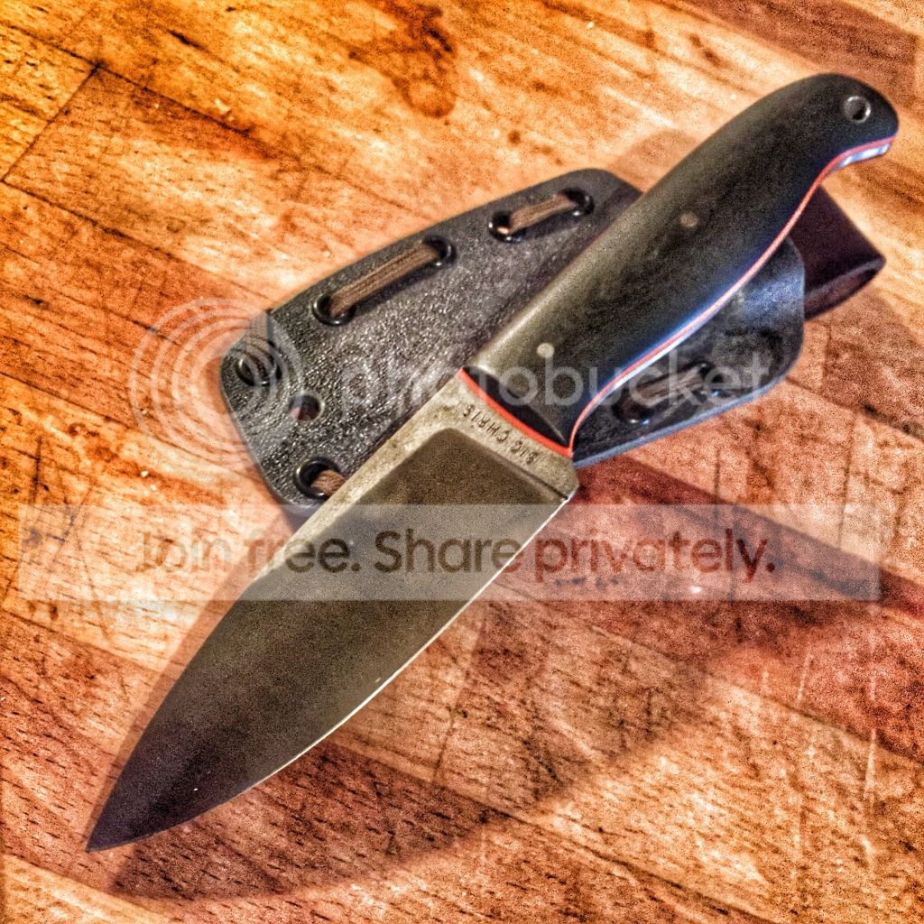

Here's my Big Chris knife, 4" blade in S90v ground nice and thin.
