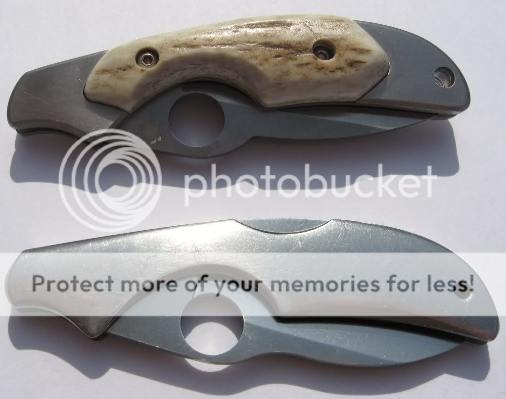

Kiwi 3 compared to the original Kiwi.
The original Kiwi was a lock back made in Japan, while the Kiwi 3 is one of Spyderco's Slipit series of non-locking slip joint folders designed to comply with tightening restrictions around the world on locking blade folders and is made in China.
The Kiwi 3 features 8Cr13MoV blade steel which is a Chinese steel similar in make up to AUS8. While not a "super steel", I have always found 8Cr13MoV to hold a good edge and to be easy to sharpen. Out of the box the Kiwi 3 was shaving sharp but not sharp enough to slice TP.
The 2 7/16" blade is a hollow sabre ground Wharncliffe pattern and the handles scales are inlays stag over a stainless steel frame.
