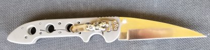

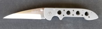

Long before Michael Janich convinced Spyderco to produce the Yojimbo, Bob Kasper had engaged Crawford knives to build a folding version of his fixed Dragon Wharncliffe that would become the Perseco (to cut through in Latin). IMHO it is the utlimate Wharncliffe folder albeit 4 times the cost of a Yojumbo. The Perseco has a 4.5 inch S30V blade and a Ti framelock handle. Bob has been dead a long time now but Wes Crawford will still make you a Perseco. Mine has a SteelFlame dragon clip as a reminder of the origin of the blade.
