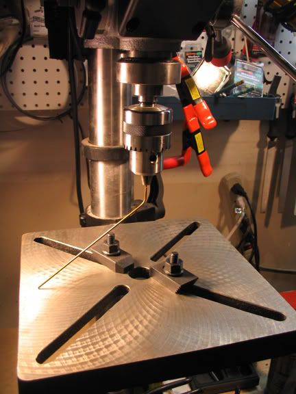

A piece of rod or heavy wire (coathanger).
Put it in chuck, bend till it reaches near the outer edge of the table, then rotate chuck by hand, checking the clearance between the table and the end of the wire.
When the distance off the table is the same all the way around, the table is squared...

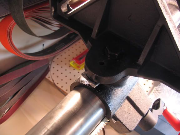

The problem is, unfortunately, most drill press tables or spindles have no method of adjusting the tram. Not like a mill anyway. You may be able to somehow use shims to adjust the table. The spindle on the other hand may be a bit more difficult (not that shimming the table into alignment will be any easier ;) )

I had some pictures that I took while squaring my Craftsman drill press.
First pic - The Bent Wire Test
Second Pic - The table is shimmed with a folded piece of aluminum foil.
