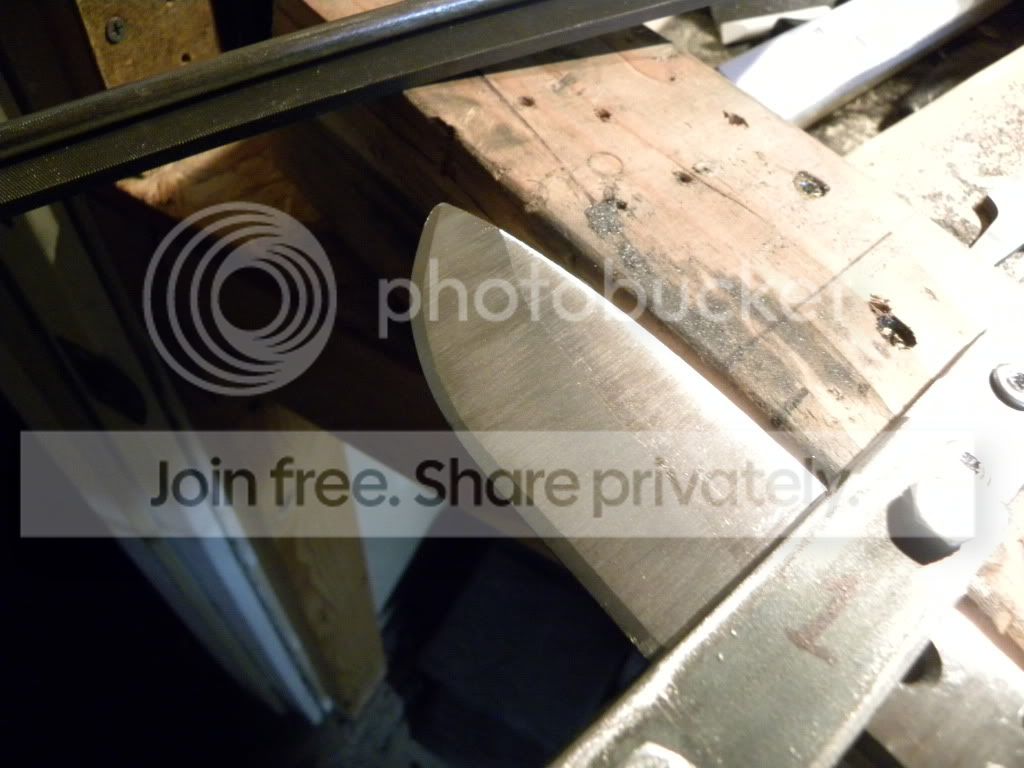

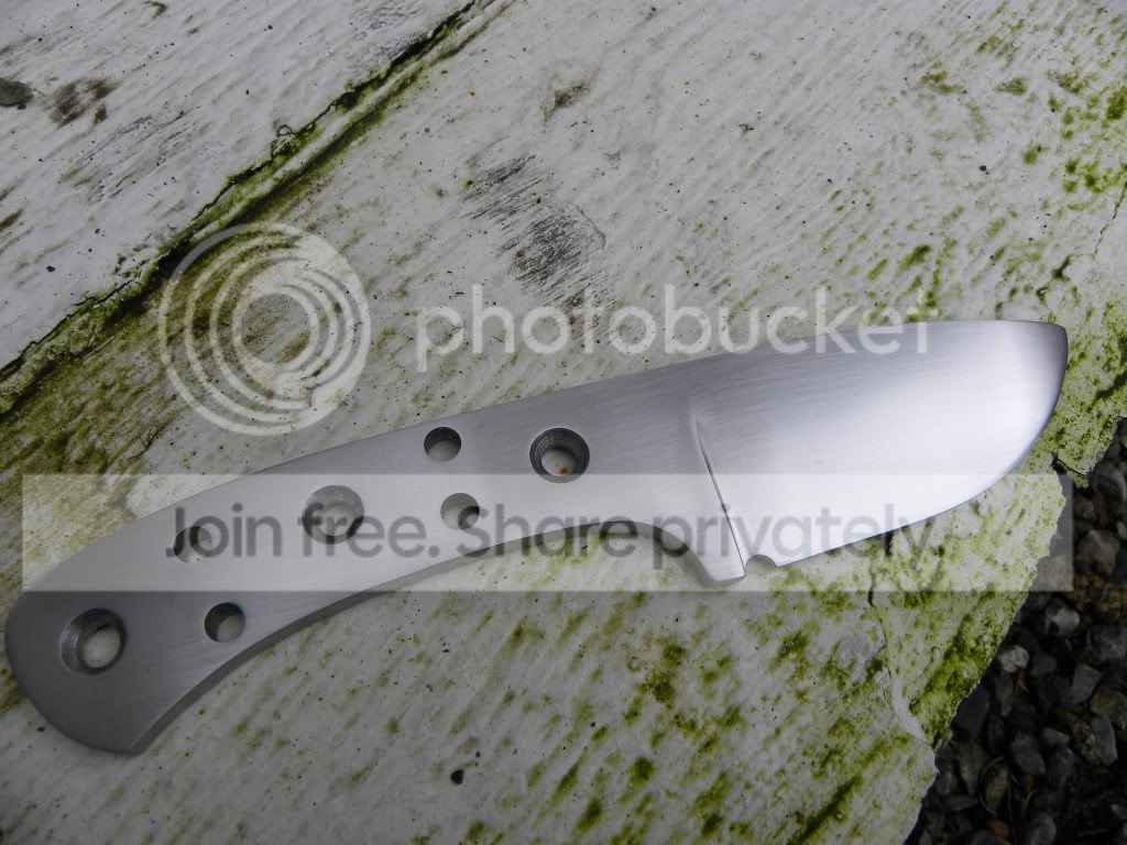

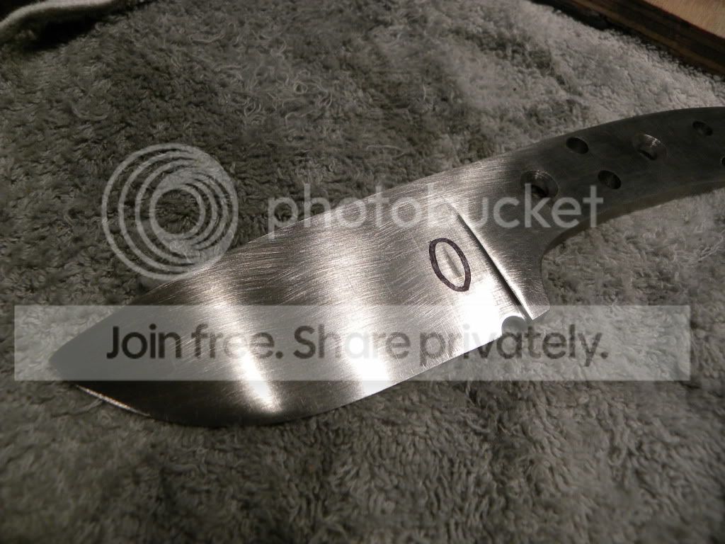

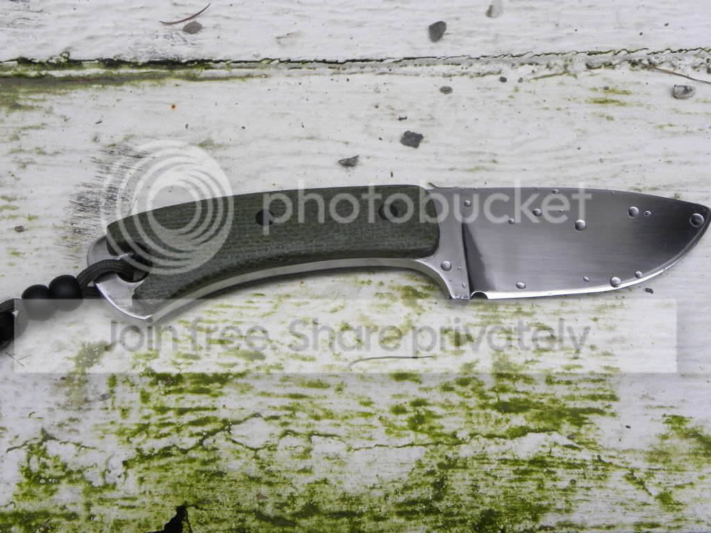

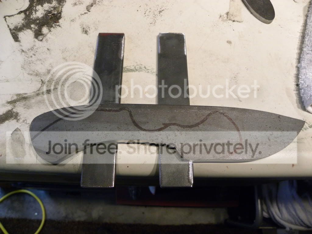

When I first started I made my first 4 knives with files, a hacksaw and a cordless drill. I have a few pictures of the entire process from my 2nd ever knife. Might help you...
I didn't take pictures of drilling holes around the outline of the knife and using the hacksaw to cut from hole to hole. Takes some time but it works fine.

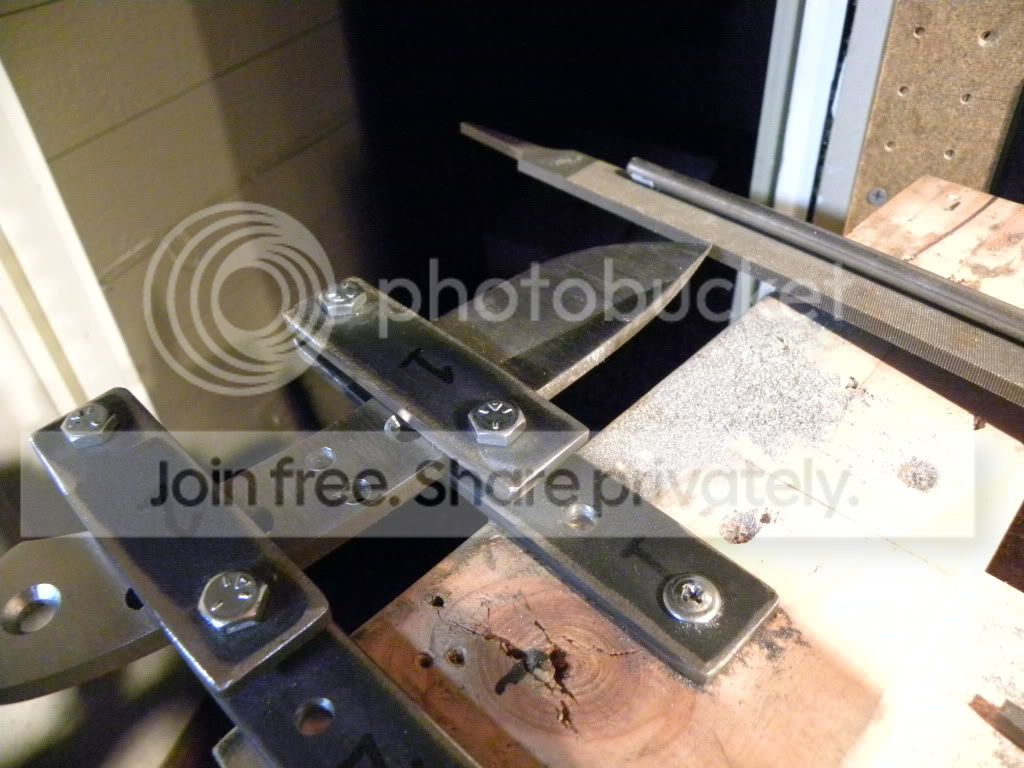

Keep using your files to clean up the edges and get your shape.

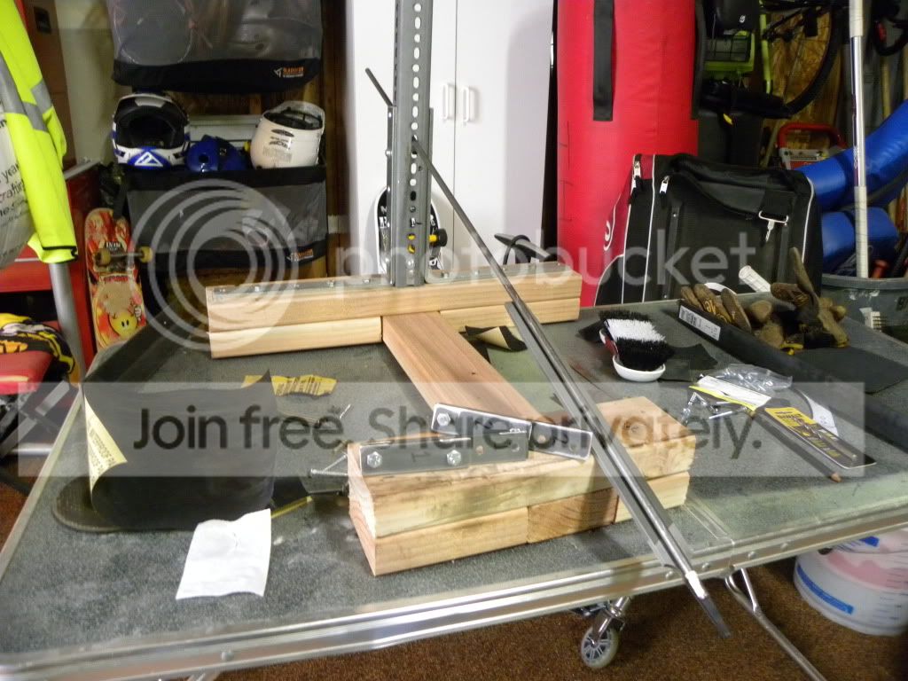

I made a quick homemade jig I could use for my files to get my bevels correct. You could use something like this to set you initial bevels and then clean everything up on your 1X30
Fix any screw ups.
You have the drill press so you wont have to fight with the cordless drill like I did.

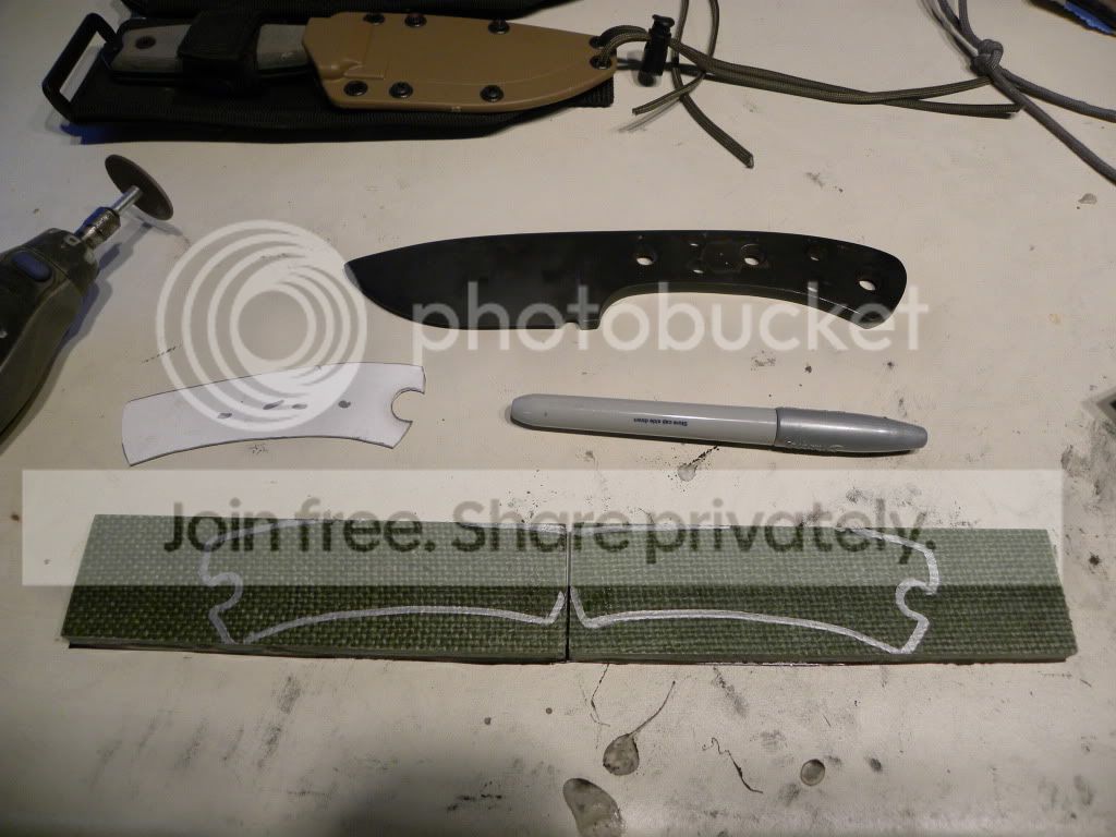

Heat treat it and go to work on your scales.
There is all kinds of errors and screwed up things with this knife, but it was only my 2nd. Regardless, I hope there is something in there that helps you.
