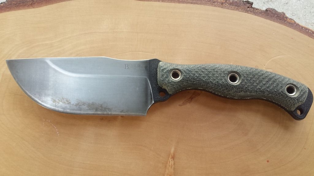

Thanks, if its at least as resistant as 1095, ill be fine. Especially with mustard forced patina. I stripped a BK2 few years back, its still well and kicking.
Some times patina turned out better than others, I sand blasted it few different times and did it over again

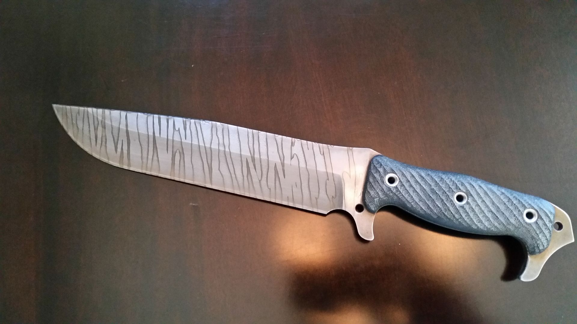

This wasnt finished yet, usually after, id patina the whole blade, and it would blend the strippes a bit and look much better (P.S. this time i left mustard on too long)

That stripe patina looks fantastic D! I'd love to see some step by step pics if you have any handy where you patina the stripes, patina the whole blade, then do the blending.

Thats pretty much the whole step by step there lol
Usually after ill get a paper towel soaked in vinegar, and wrap the blade for few min.

The darker you want the stripes, the longer you leave it on. it looked way better other times i did it, this time i think edges of stripes got too dark, i think id leave it for 10-15 min.
