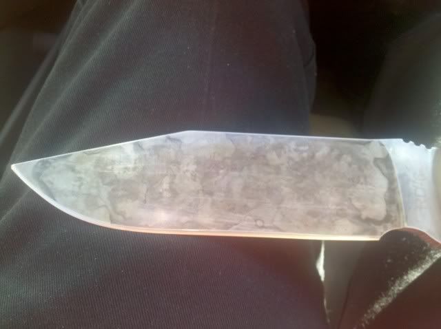

Pics please, I want to see the patina, sounds cool.

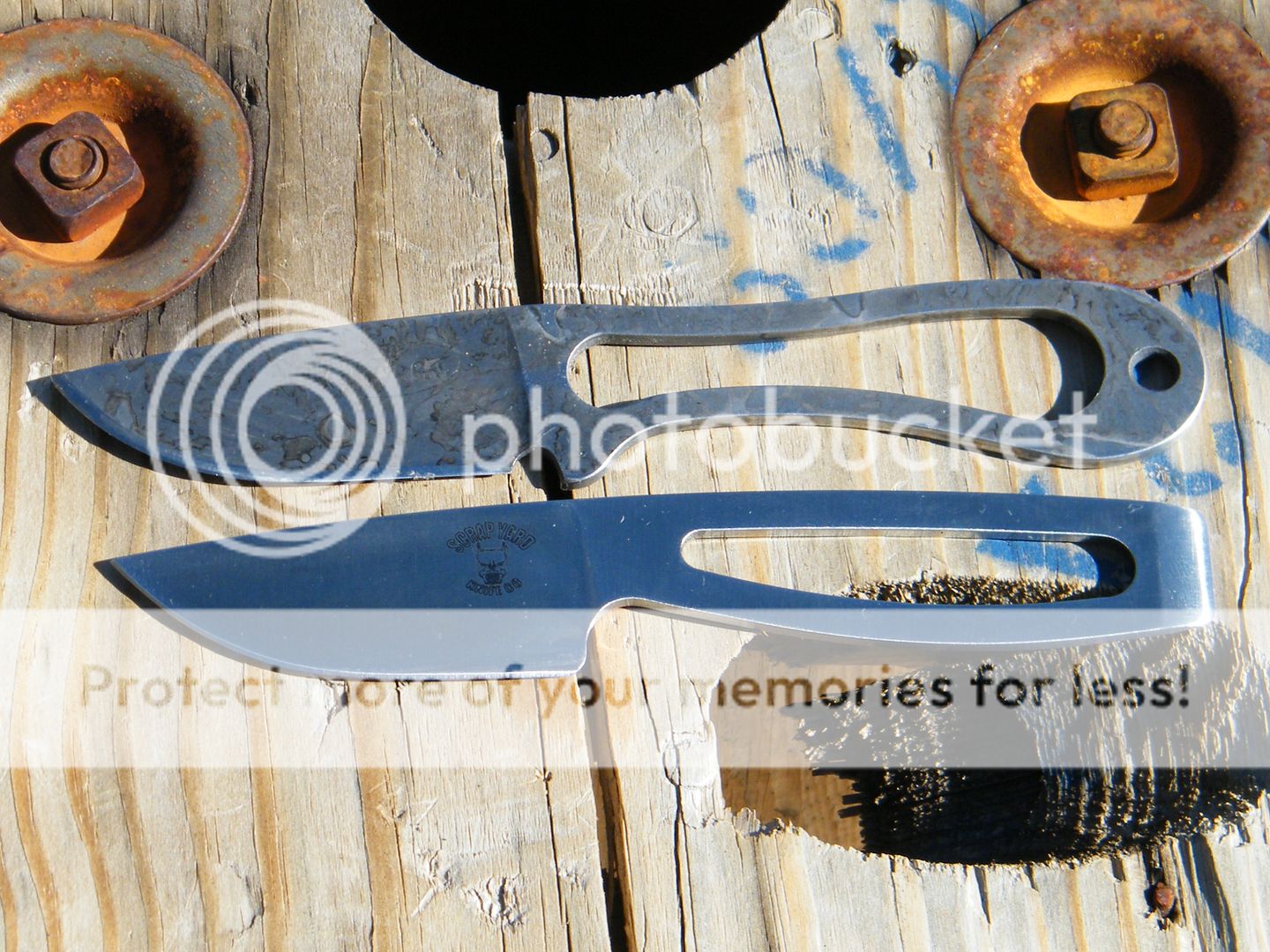

Finally got some pics, its amazing how hard it is to get the staining to show up.
The first picture is my beater knife (Ontario RD6) which i recently applied a patina to.
:D
Since this is Swamp Rat thread I added my SR101 steel for fun! :cool:
