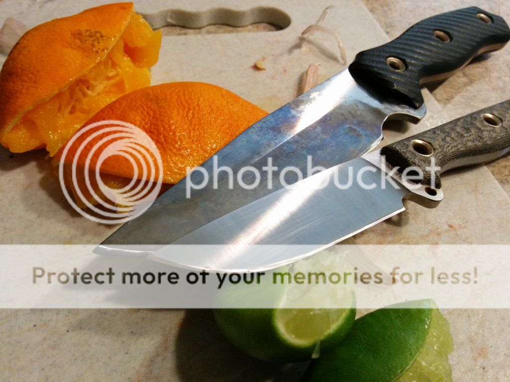

The difference between SR101 and INFI in this area is stark. In this photo is RMD LE vs AMS. The patina on the RMD was not forced, nor did I do anything to try to make that happen. It's just from regular use - obviously, there is more and faster oxidation when cutting citrus. But the AMS has cut many limes, oranges, etc and no oxidation at all. I actually really like the look of the oxidation on the SR101. Gives it character!
