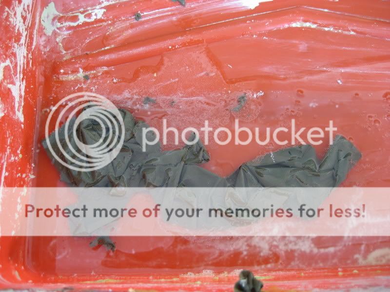

I have used the product pictured in the aerosol can. Worked great for taking the od green coating off my ASH-1! Coating peeled off in a sheet.

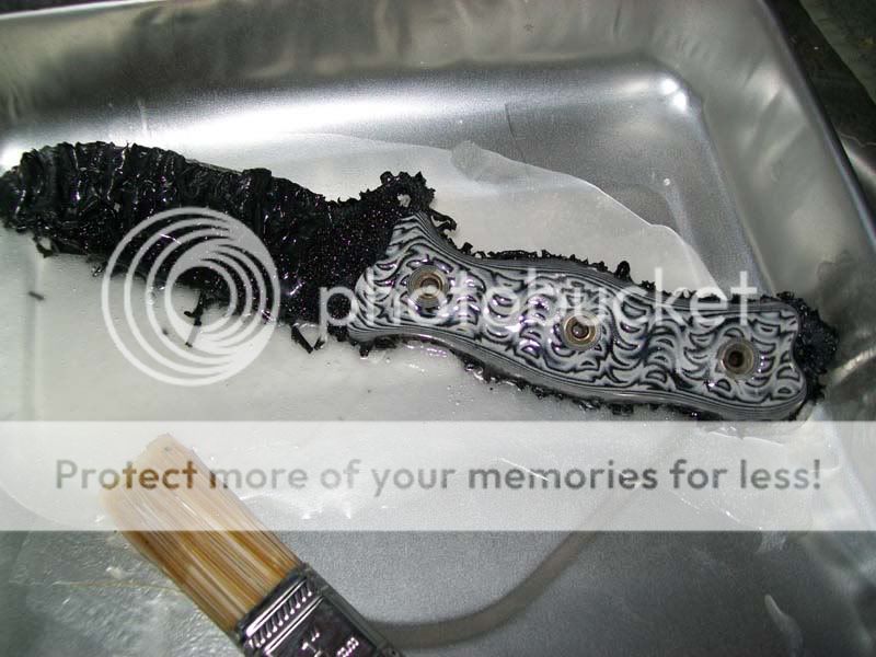

I used this to strip the coating off of one of my hellrazors
I soaked the hellrazor for about five minutes and the coating bubbled off clean and easy. When you do use a stripper, do it in a well ventilated area, preferably outside. Wear a good pair of chemical resistant gloves to handle the knife before you wash it. The stripper will cause a chemical burn if you do not wear the proper protection. The grips were not affected by the stripper.
It's really easier than you think. Any of the products mentioned above work great. The best I've used was the Klean-Strip paint stripper. If you leave it on long enough, all you have to do is rinse the coating off because it just washes away. You can't mess it up.
^Great photos! That is a great product. Submerging the whole knife may be overkill but it sure gets the job done. I prefer the aerosol version that foams because of the reduced cleanup. What did you do beyond stripping the coating?

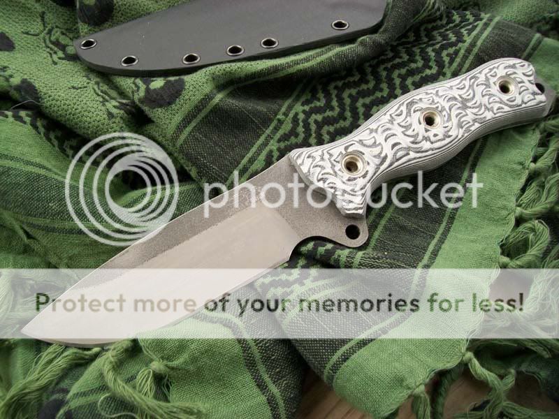

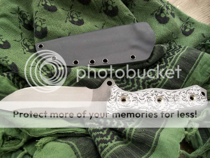

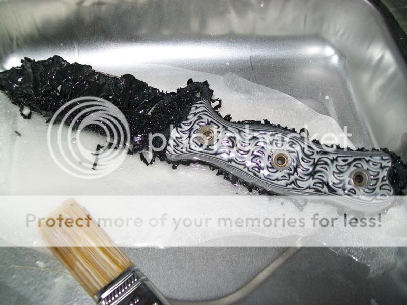

The hellrazor whent from this before stripping
After stripping, a dull grey, plain INFI finish
To this satin finish by Garth at the Busse Spa, and a new set of slabs
