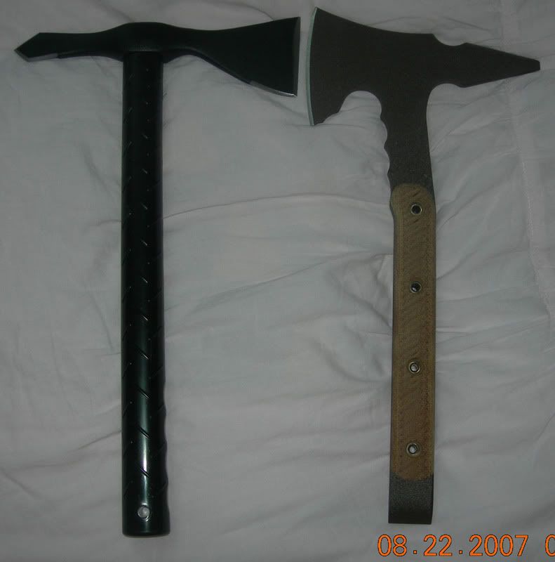

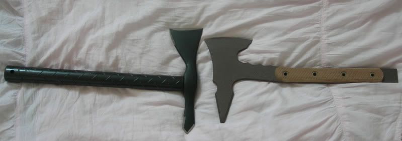

Side by side...
Weight/Lively- CrashRat (aka CR, sometimes called Crash Axe CA) is heavier total, but feels quite lively, more so on horizontal cuts than vertical, due to handle design most likely. VTAC is even more lively in almost all situations, but on a full chop, its harder to stop the VTAC... maybe because the CR has more weight in the handle and not all just at the head? see last pic. (this was based on low grip... with a slightly elevated grip the weight begins to diminish on both
Blade. CR more blade face, and is much more blade like, while VTAC has more reach and edge is much more axe like than blade like.
Grip. Overall, both excellent. The CR has the added utility of the full tang to the pry bar crash tip, but this gives you less usable length to grip on... VTAC is about .5" longer and you can use all of it, where the CR you have to grip up higher. Working on both with a 'choke up' grip is comfortable, however the VTAC is fairly useless to choke up on for finer work with the type of blade it has IMO.. while the CR can be used for smaller jobs mo problem.
Durability... both have great reps, but will reserve commentary until i can find the time to abuse them,... maybe in the next two weeks hitting Cabin in Big Bear :)
Fit and finish are great on both... I can see where the seam on the grip of the VTAC is joined, and looks like it was sanded a bit by the QC guys... or maybe selling vender?
VTAC comes with a nice kydex lined courdura sheath, CR does not come with sheath.
SRKW- life time warranty on everything. Rc 55-57
ATC - life time warranty on head (will likely fix whatever you need, and I read somewhere they offer sharpening for $20 to bring it to a blade... Rc52-54.)
SRKW ~$210
VTAC ~$110
IB

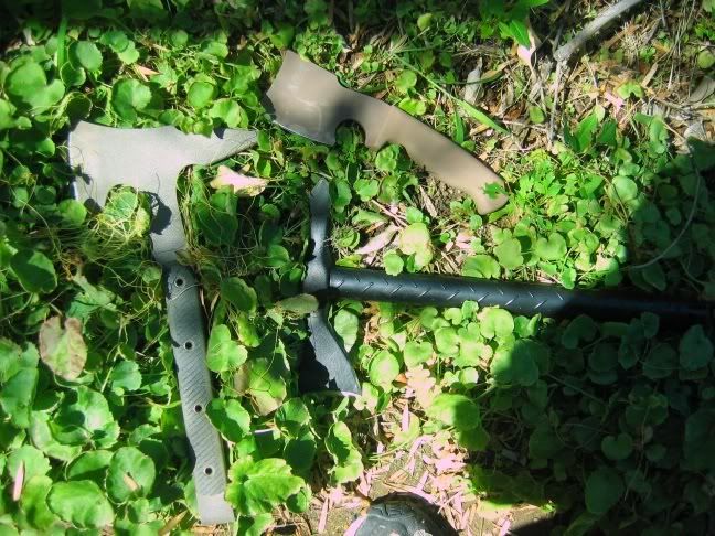

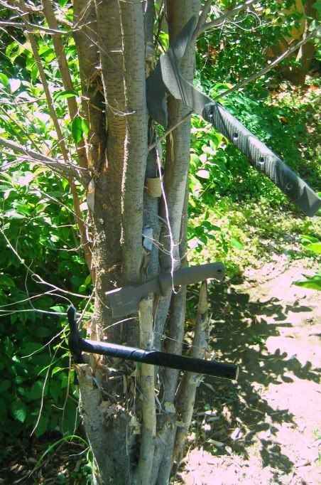

My Big Bear chop day was postponed until mid this week... but last night my dad calls to help him clear out 3 dead Ficus, about 25# tall, and not more than 8-10" diameter, with lots of 1-2" shoots around. Shoots were live, while the trees and the shoots on them were all dead.
Instruments...
VTAC
Crash Axe

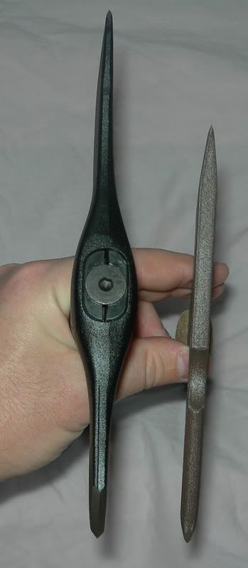

Ratchet (SRKW).
First, the Ratchet was really sweet. Nicely convexed and polished (a bit beyond factory)... it would actually bite(sink) fairly well... it was really satisfying to use... I only wish i though of batonning it while i was out...
low hand vibration transferred, especially considering the size. Live stuff it snapped right trough, and it would angle cut nicely into the dead stuff, and did cut in perpendicular as well, but not too deep. Verdict, a nice camp/truck/general use blade, with tons of 'general use' potential
(see pics of it in a Chuddy Bear sheath)...

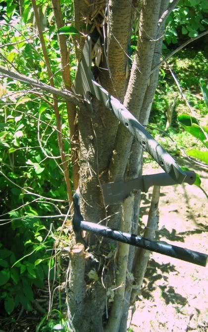

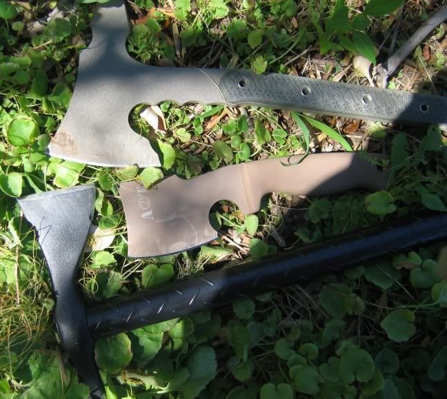

Next, VTAC. Comfortable grip, but finding a consistent swing was tough.... I would chop high, then low. then on target then anywhere else... not nearly as precise as I thought it was. On perpendicular hits, i would just dent the tree (blade not very sharp, and has a large angle edge)... To make angle chops into the wood, I was surprised to see how well the VTAC chopped. Again, accuracy was very difficult for some reason (maybe the purely round shaft grip?) but it sure sunk in and did its job... up cuts, down cuts, you name it... working well. (note the wood was so hard, I could not drive the spike in... dead and full of minerals, especially down low).... Overall, very comfortable to use and handle.
Next, the SRKW Crash Axe... Maybe less comfortable to hold and play with in the kitchen, but while working with it... i found it to becomes even more comfortable than the VTAC. Less transferred energy into my hand (I guess because of the greater weight, but still i expected the VTAC to be softer with the synthetic shaft eating vibration)... Also, i noticed accuracy was awesome... I could chop and chop and chop hitting the same place at will.. the grip shape I am sure has much to do with this... Perpendicluar hits sank well (while the VTAC did not)... and angle chops sank well also... Again, the spike would not sink in the dead stuff. In the end, i was surprised how lively the axe became while actually using it... it really grew even more on me the more I used it. Plus, the weight makes it a brute... first swing, chop 15%, next chop, advance the cut to 25% of the diameter, third swing... zero cut progressing and the wood just splinters and fractures like I hit it with a 20# sledge... That was cool imo... as hard as the wood was to 'cut' it proved very brittle and did fracture under the force... this changed the difficult dry hard wood chops into a satisfying day of wood busting...
I feel I was able to swing the VTAC faster and the lightness shined... until impact where the Crash Axe would sink deeper. Overall I love them both...
But the strage thing was just how consistently accurate i was using the Crash Axe.... and how in just playing with it it felt the heaviest, but in actual use, the weight felt like it disappeared the quickest... Go figure.
I will have more review soon (after Big Bear) and maybe I will make a choice of favorite then...

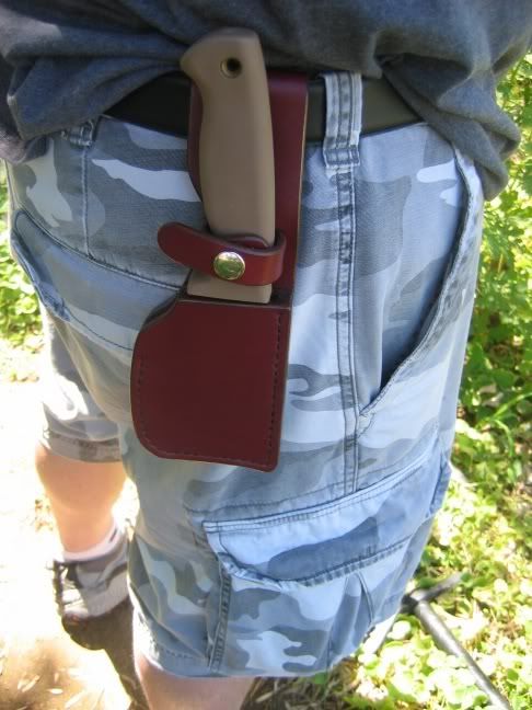

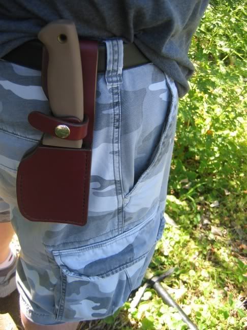

(btw, I have been carrying the Ratchet for 2-3 days now, and find it really sweet for an edc. A bit clunky at times (while in the sheath) but in the hand... it does have nice reach, a blade under 3" (especially important in times like now when i am visiting California).. and you really can grip it in so many ways to use it in so many ways...)

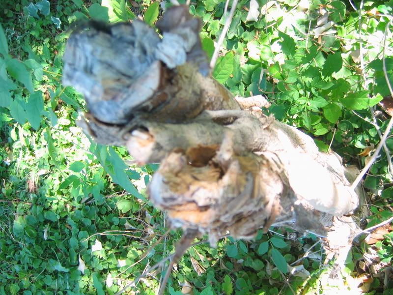

Once i got all the wood laid out on the ground... taking them down into smaller 4' sections by chopping straight down into the wood with the floor supporting.... I saw the cleanest cuts and way way less effort with the Crash Axe, which is to be expected I guess... but at the end of around 3 three hours... the Ratchet could use a re-hone (just mild/minor touch up)... the VTAC looks unchanged (still factory dull), and maybe surprisingly, the factory edge of the Crash Axe still shaved hair on the back of my hand... NICE

That little tool you have (the tan-colored little number in the sheath) has me excited!!!
I have a friend who was an Army Ranger (he led a group of Rangers), and often was involved in hand-to-hand combat. He spoke of gouging out eyes, snapping a particularly fragile bone in the neck, etc. he also spoke of an edged weapon he favored that he described as looking like a small cut-down meat cleaver... Your tool sure fits his description!!!
To be blunt, my search for such a weapon is what eventually led me to buy a 'Cold Steel' Vietnam Tomahawk, ATC VTAC, and then eventually led me to this wonderful forum!!!
PLEASE!!! can you tell me the history of the little weapon, and where can one be purchased...

I am not finding ANYTHING when I search 'Google' for 'ratchet'...
Even here, I am not finding usable info as to the history or much else on this tool...
can anyone here point me to someone who would be considered a 'guru' on this 'ratchet' thing?
I REALLY want to know more...
swamp rat knife works, ratchet... there are a few versions, including a 'pauls hatchet'...
you can learn more about them on this very forum in the busse and swamp rat subforums... they are rare but pop up every now and again on the fs forums here, and on the big auction sight... there is a tan/tan ratchet identical to mine on the bay right now, with 2 days left... hope its not wrong to mention...
