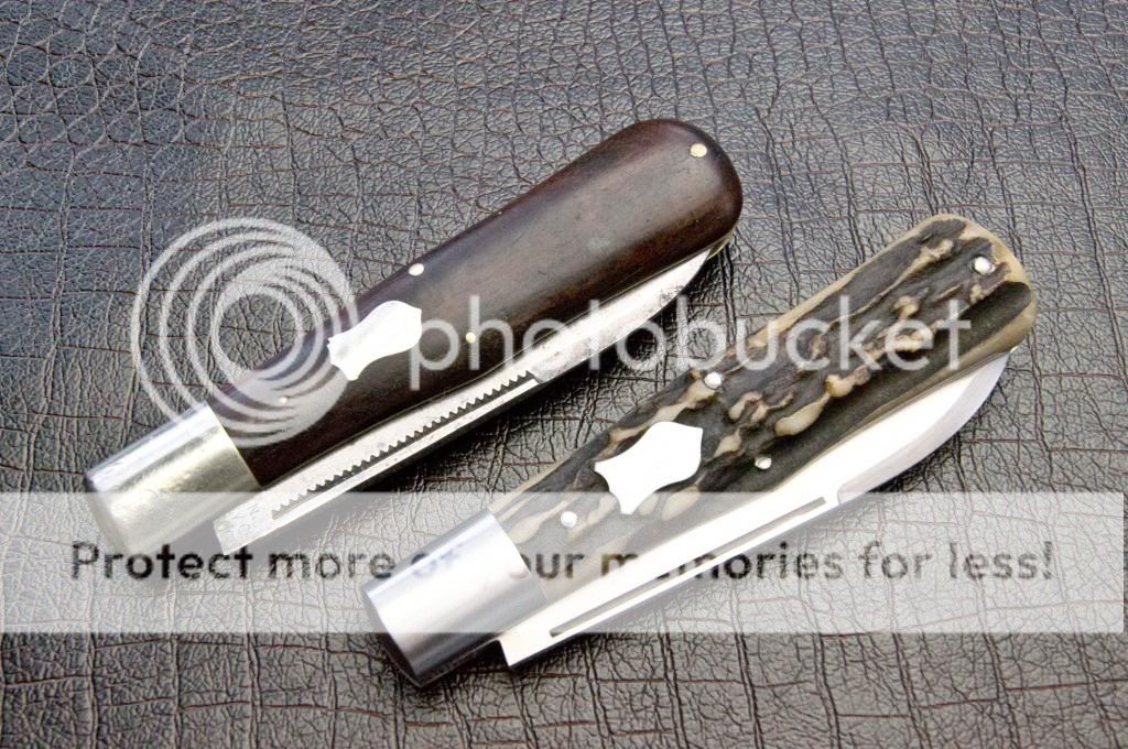

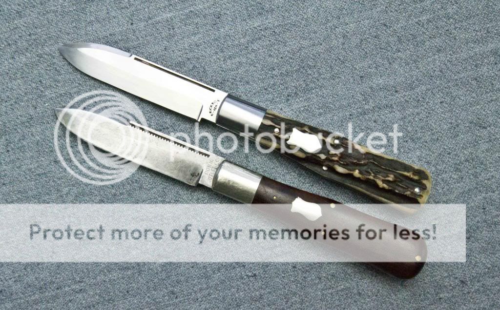

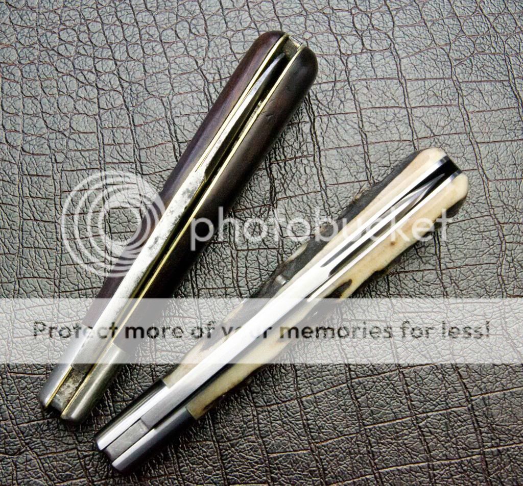

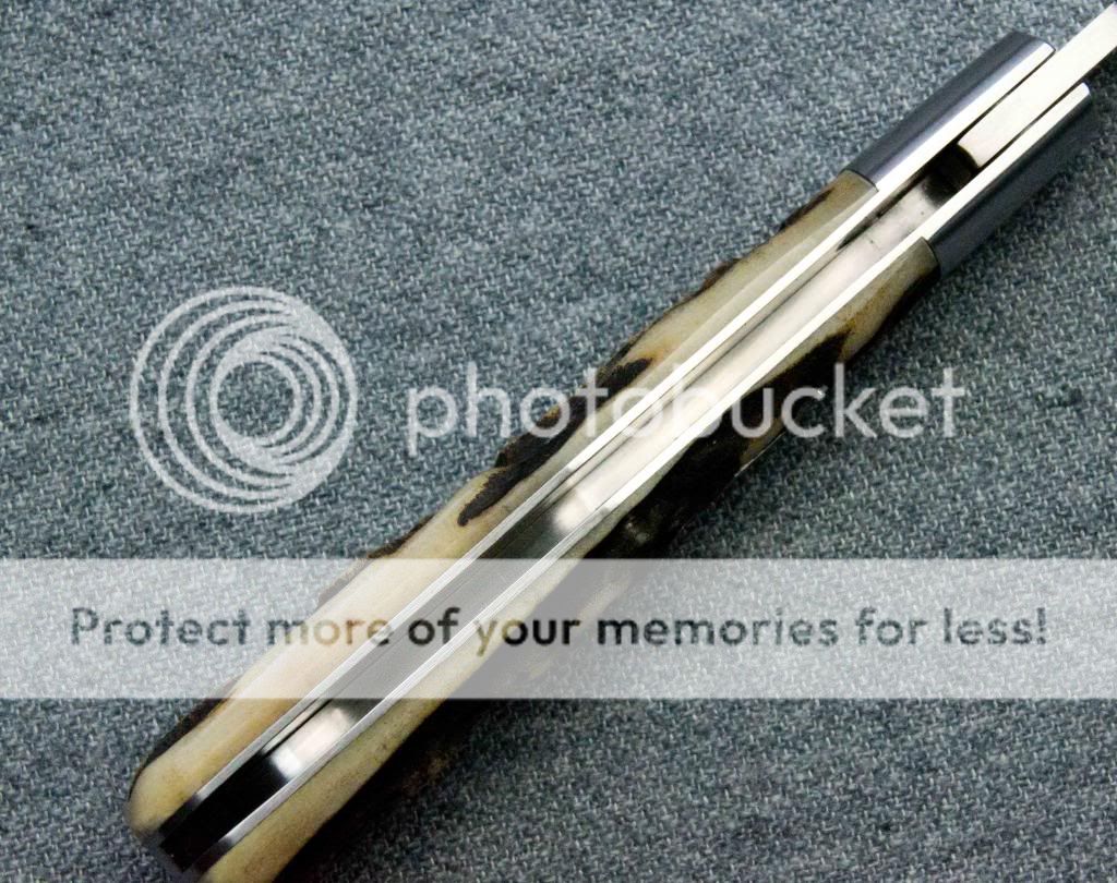

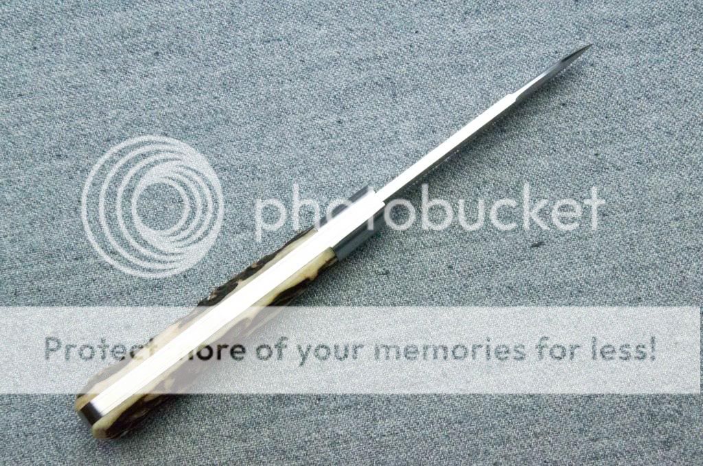

10 months ago or so Mike Robuck had sent me a few knives to look at. One was a stabber jack marked Conn. Cutlery Co. A very cool knife that I decided to put my spin on. This rendition(going to the Badger Show, not for sale) is pretty true to the Conn. Cutlery version with some changes. No match strike pull on mine along with being covered in stag.
One of the intriguing aspects of these stabber jacks is the heavy saber ground blade. If you look at the Conn. Cutlery Co. version you will see the lack of a kick. The back portion of the sharpened blade rests on the backspring acting as a kick, but also dulling that portion of the blade and leaving a cut mark on the spring. When I built my version I could not get over that aspect and decided to make mine with a kick. I think I still captured the flavor of the kickless blade of the Conn. Cutler version while avoiding the pitfalls.
3 3/4 closed
CPM-154
Stag covers
416 integral bolsters/frame
Thanks for looking and feel free to post pictures of your stabber jack!
I like the integral bolsters, like on the original Barlows. I'd call that an improvement. My NY Knife Co, like your Conn, has separate bolsters, though oversized.
Mine also has a substantial kick.
Great workmanship- I can appreciate it because I just re-bolstered a shell-handled Barlow.
I think you nailed it Ken.
The 'kick' you added is unobtrusive, and as always, I love the swedges.
Very nice Ken, subtle work on the kick too, a beauty as always :thumbup:
Agreed!
Had you not mentioned the kick, I probably would have missed it. Very subtle alteration that provides function without interrupting or in any way distracting from form. :thumbup:
That knife's a beast, however. I s'pose given its description, that's a compliment? ;)
Nicely done once again, Ken.

Thanks for comments, very much appreciated.
Sarah,
This pattern is commonly referred to as a Coke bottle, or perhaps :eek: more correctly swell center.
The knife while only being 3 3/4 in closed length comes in at 2 7/8 oz. The knife is stout with a pull to match. While smooth, and not a thumbnail buster, the weight of pull is heavy. Appropriate for the pattern. I think one of the interesting things about these knives is the straightness of the blade in relationship to the frame. If you look at many jacks the blade when open will have a slight downward attitude. I am not sure of the marketing strategy when these knives were coined "stabber" but it does make sense to me that the point of the blade is very much in-line with the frame.

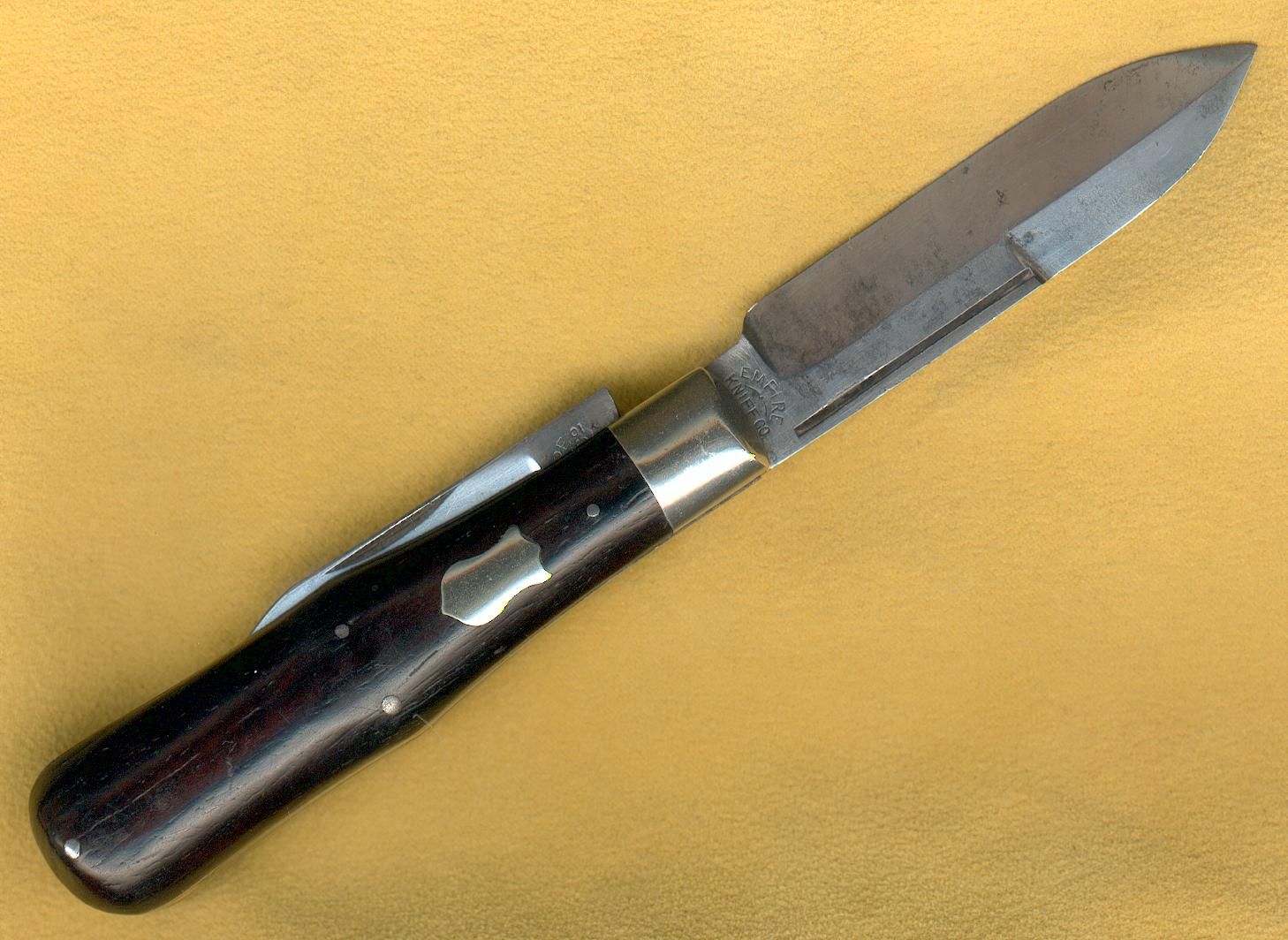

Since you invited us, I'll post this one, with a question to all.
If it has a pen blade, is it still a Stabber Jack?
Empire
Looks great Ken. Did a great job still giving it that "Kickless" look /feel while
adding a kick to it.. Saber grinds are on point! I love saber ground blades, just adds
that "look" to the knife... Congrats!
