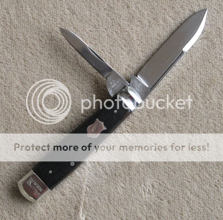

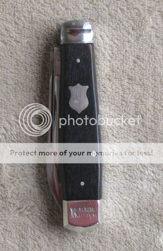

Here is a similar pattern, I think a coffin jack with a stabber type blade with a pen secondary. I took some pictures of this Keen Kutter for a good friend a while back. I think they were ebony covers. It has a more standard looking kick, a slimmer blade, and of course a capped end.
