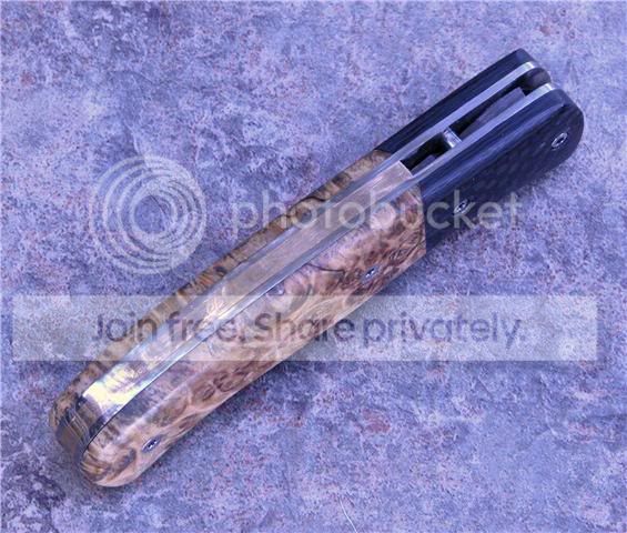

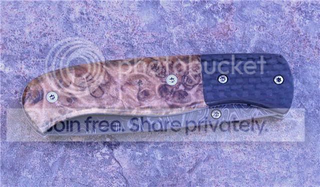

I just received an email from Joe Sangster with photos.
WOW!!!
That's a great looking folder! What do you guys think?

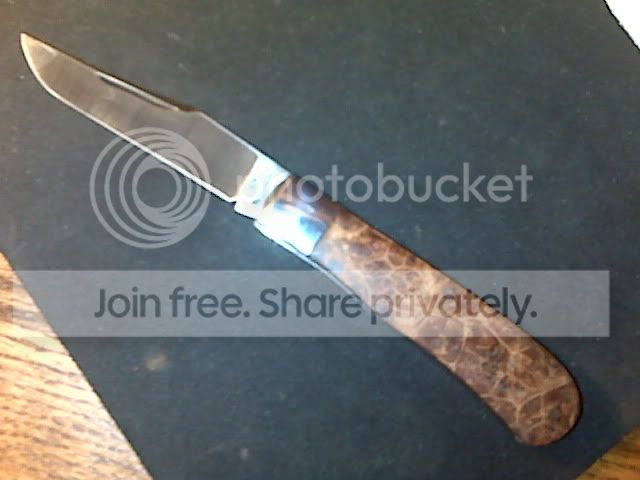

here is what i did
the blade is from a kit knife however i scrapped the rest of the kit due to poor quality and made my own. This is my first folding knife. still could use a little work but this is going to be a user.
The wood is beautiful and the pictures do not do it justice but let me caution you before it is on the kife it is a brittle as a saltine cracker. However on the knife with epoxy it feels sturdy.
it is a lock back
about 4"closed
7.5" open
440c
bolsters are satiless finished at 600 grit
redwood underground burl
needs to be sharpened a little better but i will get to that
let me know what you think as this is my first folder
mg
Great looking folder. Your comment about the scales being brittle was a concern of mine as well. Especially with pieces that do not have long grain for strength. With burl grain going every direction it does not have the strength to be bendable, ever stabilized. But it sure looks good. I think the finished results are worth the extra care needed working with this wood cut so thin.
i agree it is impossible for it to be as strong as wood with a directional grain but the look is great. On the knife it feels plenty sturdy but you have to be very careful putting it on

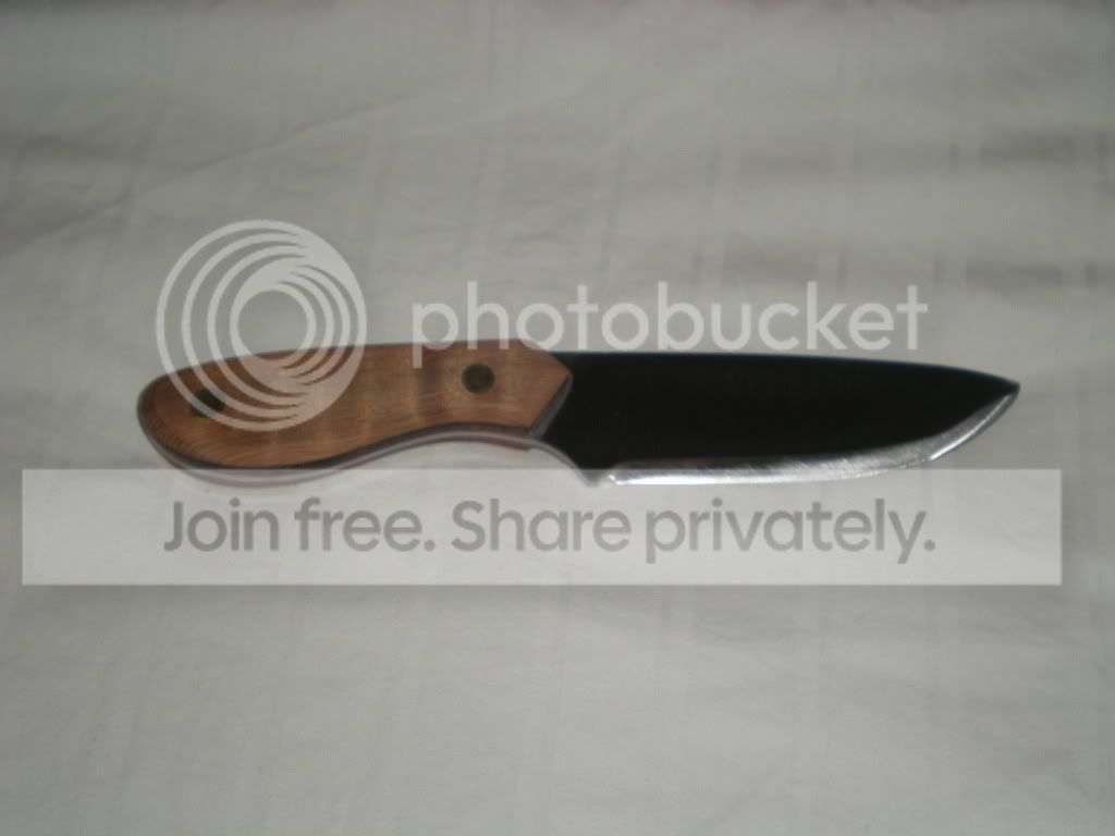

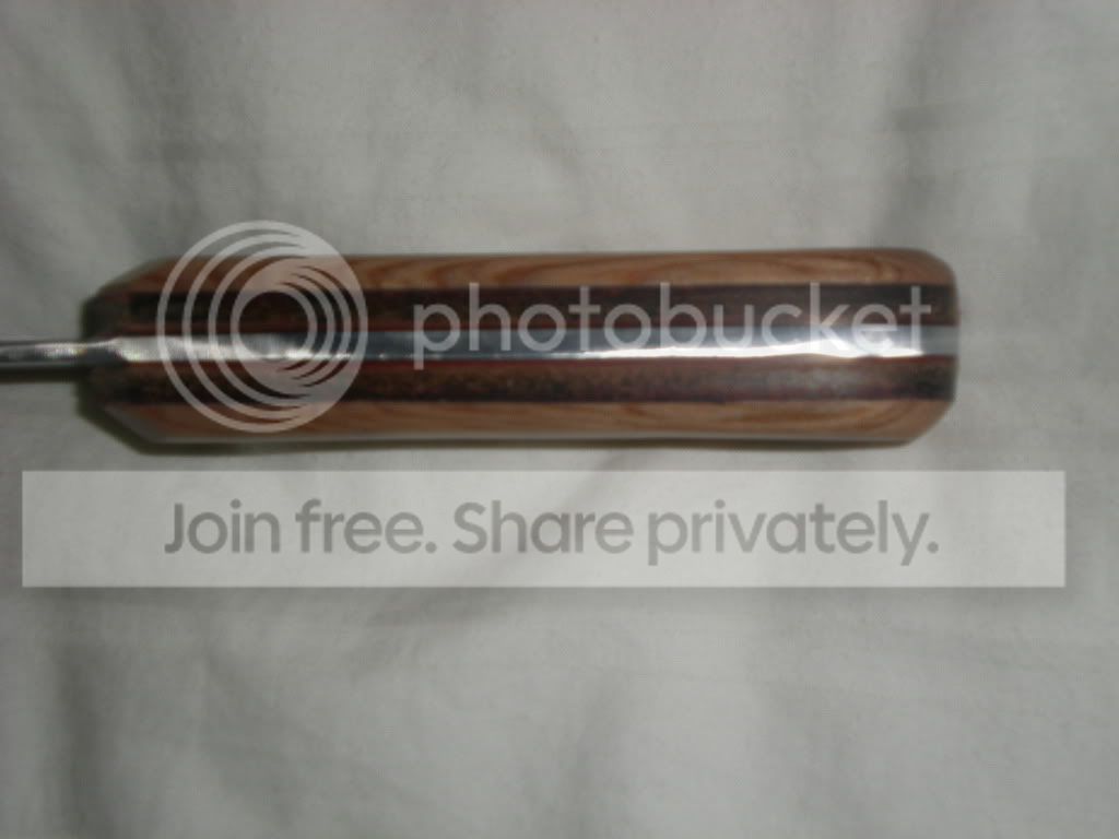

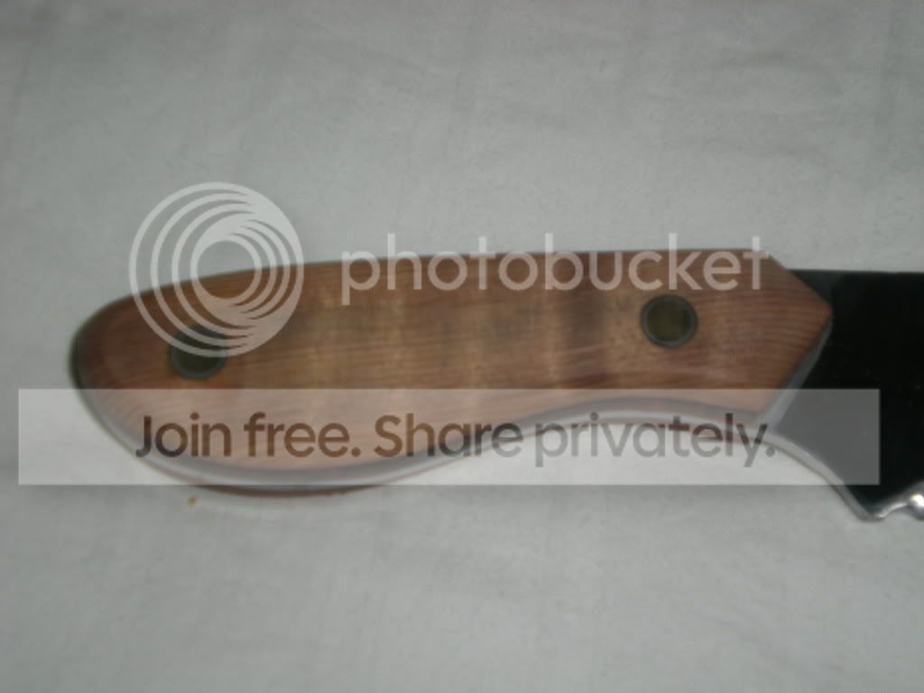

Mark was nice enough to send me some scales for a couple folders I have - nothing custom (or even all that nice) but I was very interested in trying out his stabilized wood. Of the 2 sets I glued up one tonight and the other I need to thin some more before I can move forward with them. One set was too small for either folder so I used it on a fixed blade (hope you're cool with that Mark!) with leather liners. I am a complete noob at this so there were many mistakes along the way and I really hope these turn out.
Regardless of how they turn out I can give my eval portion of working with Burl Source's stabilized wood.
Initial reaction was that the wood felt a little light, but these are small scales so couldn't quite tell how they'd compare to non-stabilized scales. They sound like plastic when you tap them and definitely smell different when you sand them. Though these are small there seemed to be full penetration through the wood with no areas of differing impregnation. The wood was clear and consistent. With a spritz of water the grain really popped out and showed great coloration and contrast in natural colors (something that I've noticed from other stabilization processes is that the colors almost seem muted).
After sanding to shape before applying to fixed blade I thought these sanded just like wood scales of the same size but were nice in that they didn't splinter or check like most wood can when using a disc sander. They sanded beautifully and I'm stoked once the epoxy cures to finish this set up and see how they finish up. I will post pics as soon as I finish up the knife, probably not till friday as I'm in class all day tomorrow.
Thanks again, Mark, for sending me the scales. Sorry it's taken so long to post any results, life kind of gets in the way sometimes! Also, like I mentioned, I am a complete noob at knifemaking but have done my share of woodworking in the past (I make custom wood portable Chiropractic adjusting tables) so I hope my review of your stabilized wood is what you were looking for!
I was trying to find this somewhere but do I need to finish stabilized wood at all or just take it up to 2000 and wax? I don't have a buffer. I like how these particular scales look (finishing some black willow right now) and will try to get a pic up tonight of them at 2000, again, this is on a fixed blade...
Taken to 400:
Remember, I'm a noob and these were supposed to be folder scales so I had to add a fairly thick liner and couldn't line up the grain exactly how I wanted it... These sand so well and at 220 felt smoother than some wood feels at 400...
