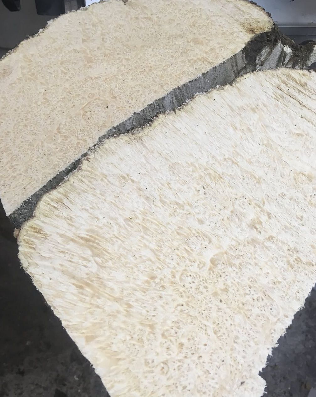

Finding and Sourcing Maple Burl​
Now let’s talk about the wood itself.

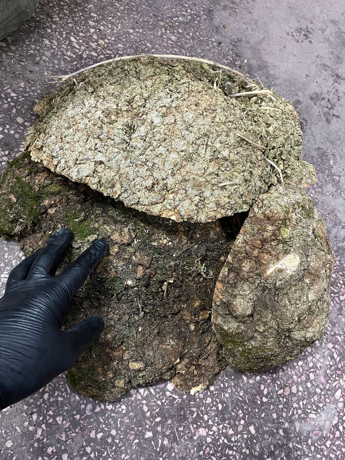

Sure, you can buy dried burl blanks on eBay or Etsy that are already ready for stabilization. That’s one route. We usually go the other way and harvest our own material. In this case, we’re working with American maple burl - specifically box elder maple. It grows fast, the wood itself isn’t especially strong, and the trees don’t live all that long. They break easily, especially in wet areas or after storms. Because of that, you can often find fallen trees with usable burl in river bottoms, shelterbelts, cleared utility lines, or park maintenance sites. A lot of cleanup crews have no idea the burl has value, so it gets tossed. That’s where a lot of good material comes from if you’re willing to look.
In our case, we had a wind-fallen tree with a large burl on it, so there was plenty to work with.
Cutting and Preparing Burl Blanks​

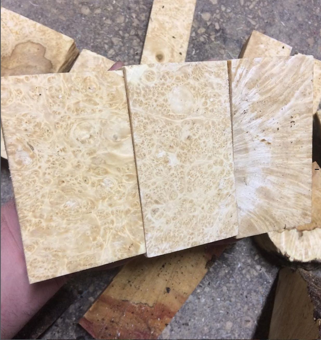

We cut the growths off the trunk and keep only the useful burl sections - basically the dense rounded portions. After that, the material goes back to the shop and waits for resawing. I use a bandsaw for this, mostly because burl can be awkward in shape and height. A table saw can work too, but depending on the size of the material, you may run out of cutting depth fast. Once the burl is opened up, that’s when you really see why it’s worth bothering with. The figure can be absolutely wild.

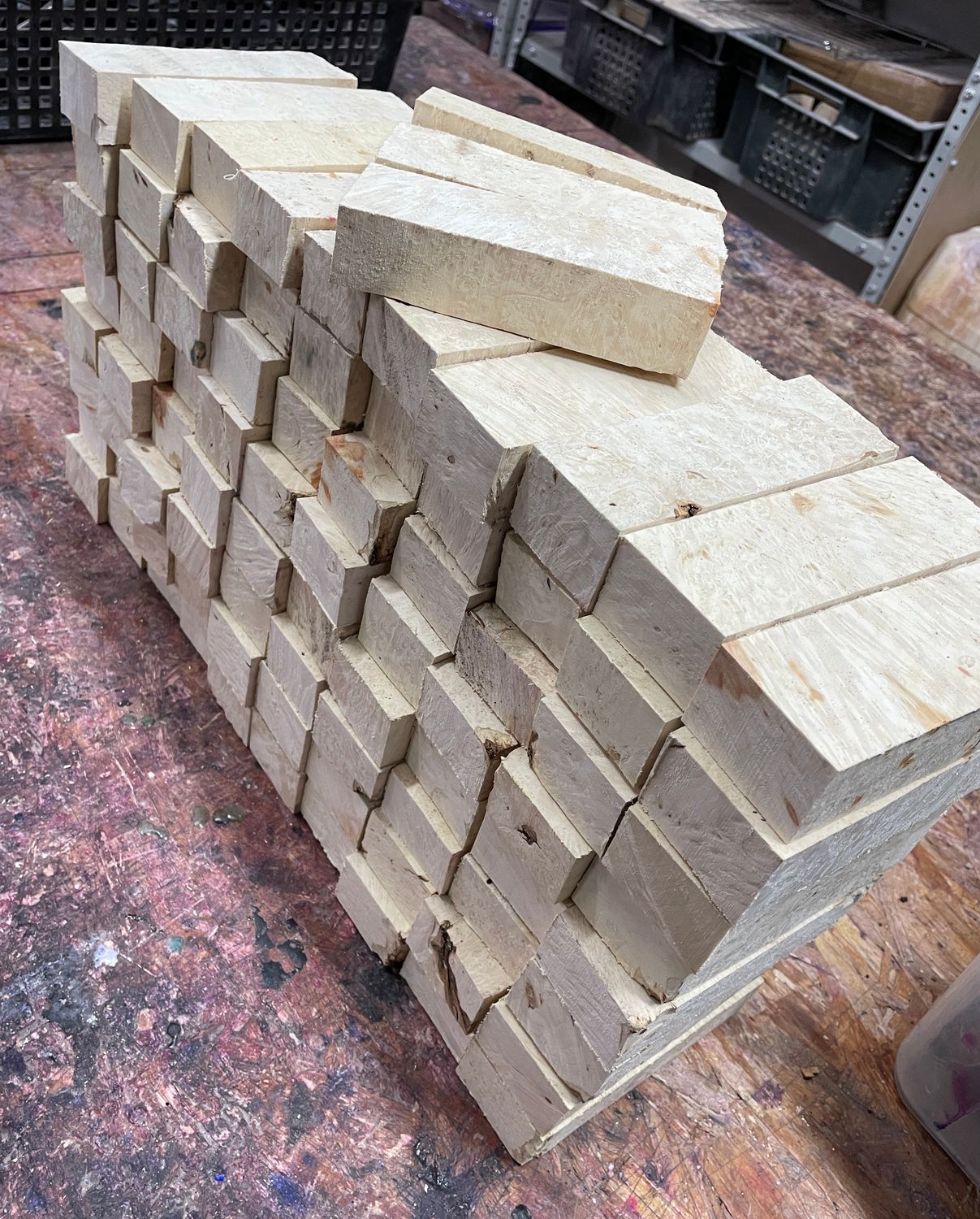

After that, the burl gets cut into blanks depending on what it’s for.
For pen blanks, we’ll cut around 5.1" x 1" x 1". For knife handles, the size I use most often is about 5.1" x 1.75" x 1.1". I dry the material as blocks, not as finished scales, so I leave 0.1"-0.12**"** extra per side to account for shrinkage during drying. That extra material matters more than people think, especially with burl.

Drying is one of the stages that people try to rush, and that usually comes back to bite them.

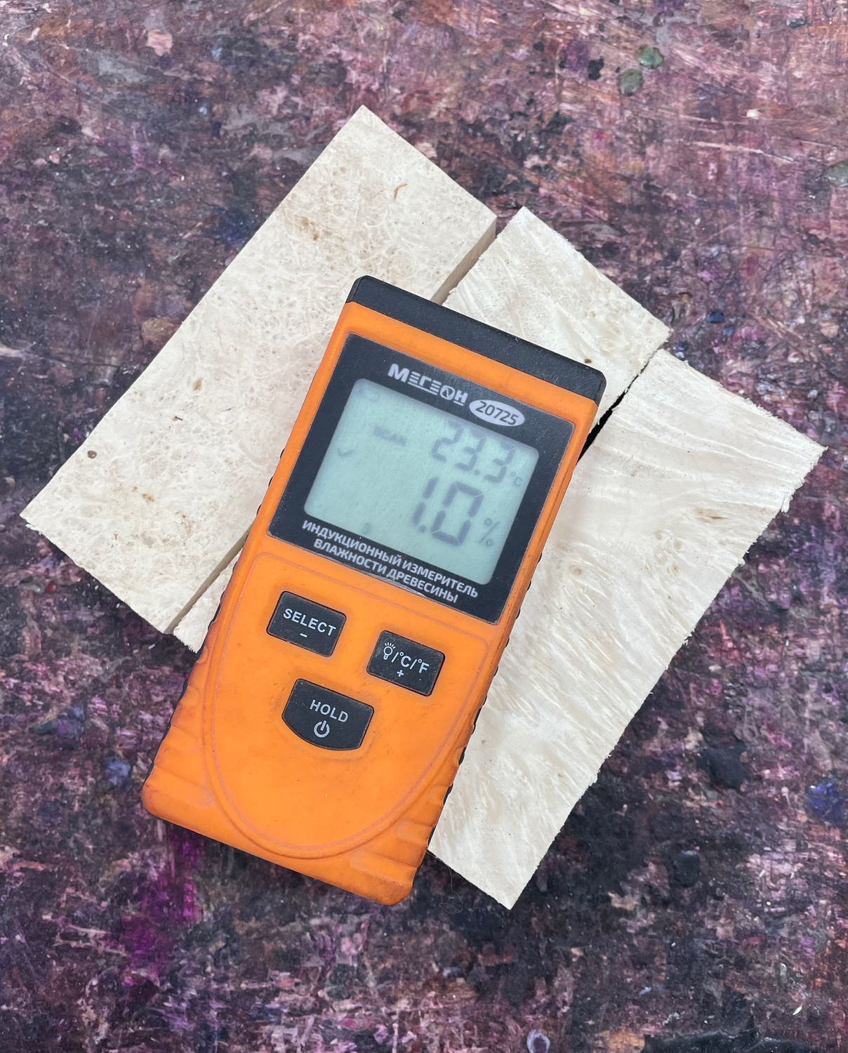

We dry these blocks in a homemade infrared dryer for about 2 to 3 weeks at a relatively low temperature, around 40-45°C. The point isn’t speed. The point is to get the moisture out without checking the blanks to pieces. If you push temperature too hard, cracks show up early and the blank may already be ruined before stabilization even begins. After drying, every blank gets checked with a moisture meter. For stabilization, moisture content needs to be in the 2-4% range. Standard woodworking moisture content – something like 8-10% - is not good enough. If there’s still too much water inside the block, you create problems later during heat cure. That trapped moisture can expand and split the blank, and it also prevents the resin from properly occupying the wood structure.

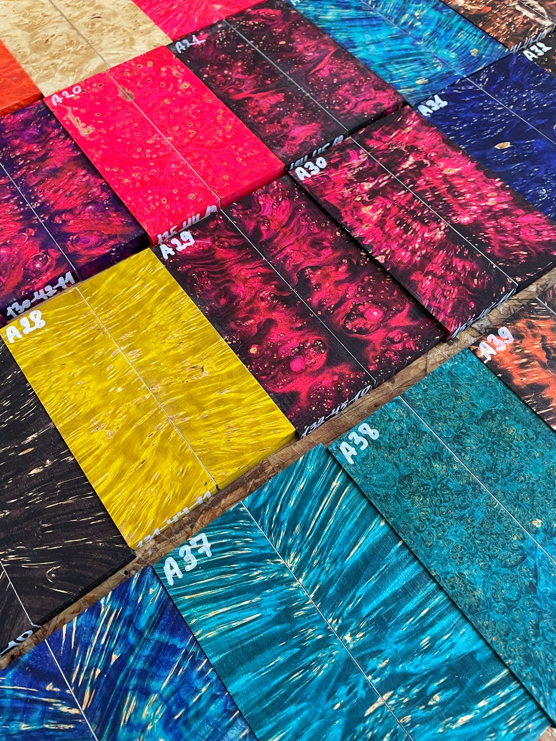

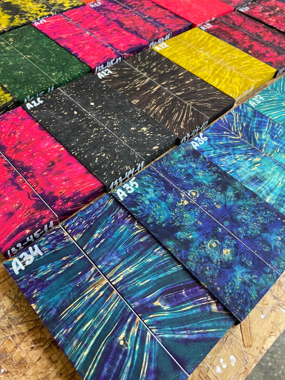

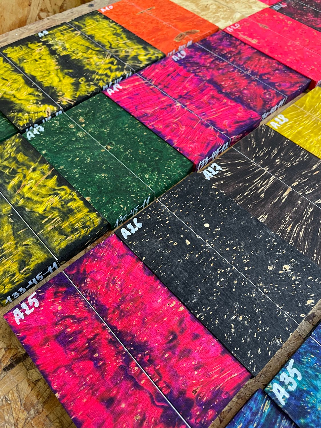

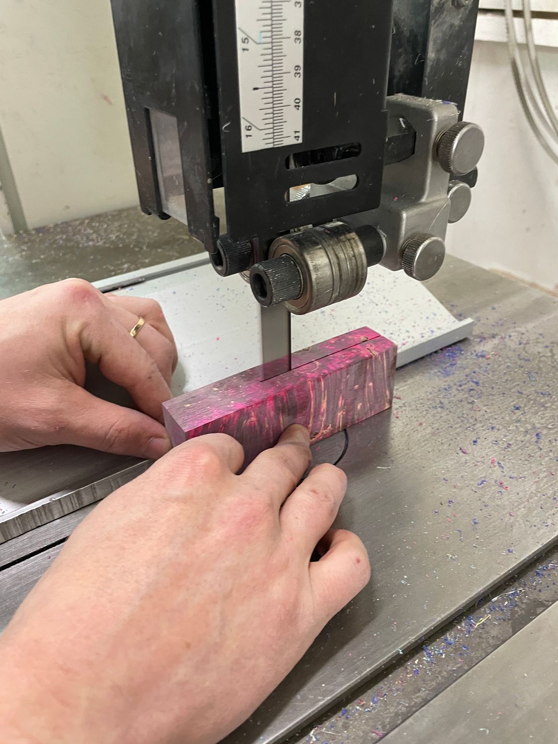

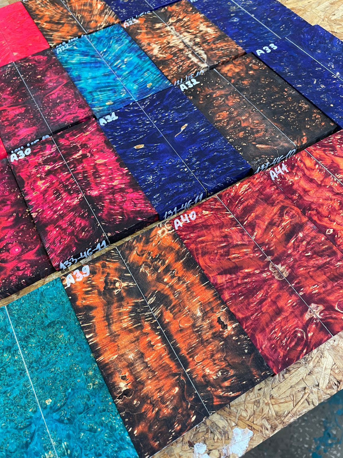

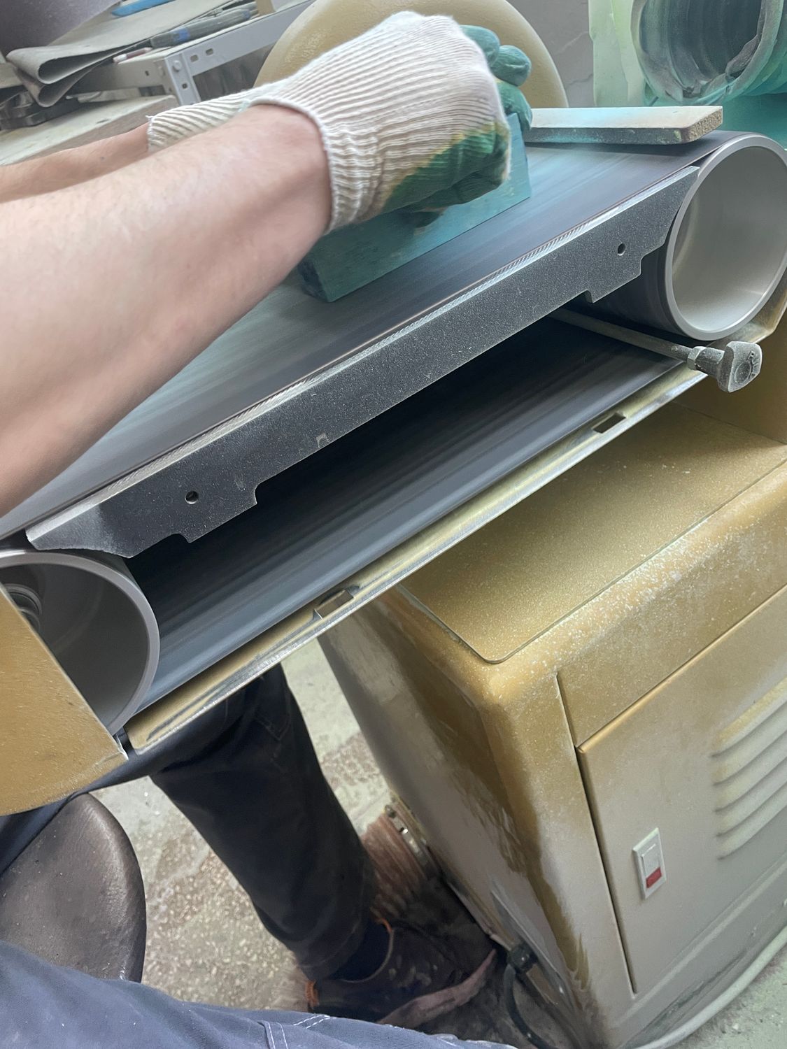

We grind the blocks on all sides, usually starting with coarse 40-grit just to move quickly through the resin crust. Then the block goes back to the bandsaw and gets sliced into scales. After that, the scales go through a surface grinder so the thickness is even. Once that’s done, we wipe them with Danish oil to open up the figure and really show what the burl is doing. That’s the stage where the final look becomes obvious. You can actually see what it’s going to look like on a knife handle.
Final Result and What to Expect​

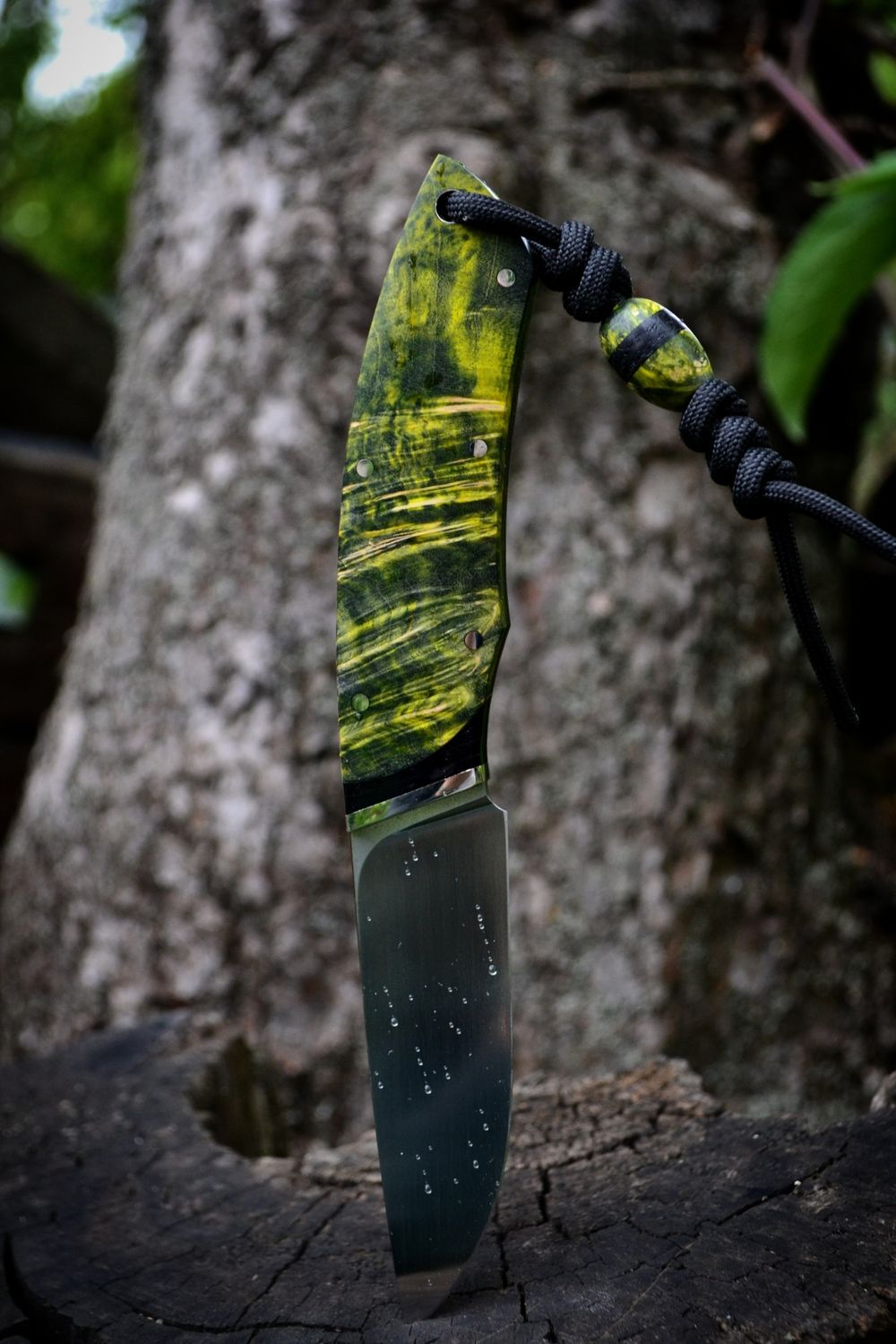

And yes, at the end of all this, you really do get something noticeably different from raw wood: more density, better moisture resistance, and a much cleaner, deeper look in the figure.
