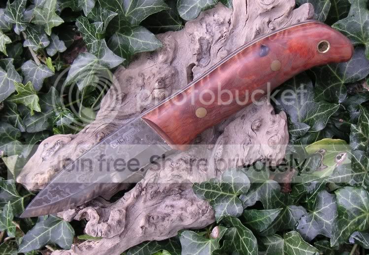

I was lucky enough to collect quite a bit of curly redwood from the grounds of my old highschool. It is much too soft to work as is, so I have tried getting it stabilized but with only mixed success. The initial batch, sent to the WSSI (who I have been very happy to deal with and who have done a great job on all the other wood I have sent), showed poor penetration in scattered stripes in the larger blocks of heart wood. The sapwood was pretty solid. I sent another batch in smaller blocks, and while that was better, there are still areas in the heartwood that haven't taken the resin.
I also tried a guy here in the UK who started using US stabilising gear. He did a couple of samples but said that the heartwood didn't stabilize properly while the sapwood did.
I saw that Burlsource recommended K&G for stabilizing redwood and I was hoping that he, or someone else, could elaborate or offer their experience of working with redwood stabilized by K&G, or any one else for that matter?
It would be nice to be able to use this wood given the quantity I have and the source.:cool:
Personal knife showing stripes of wood that are still soft and unstabilized, picking up a little dirt and looking grayer than the rest of the handle :(

Are we seeing a reflection of the wood in the blade or is that some sort of special finish on it?

I did a kind of vinegar/polyacrylamide gel etch on the blade, just for fun. It looks good, but isn't really durable.
