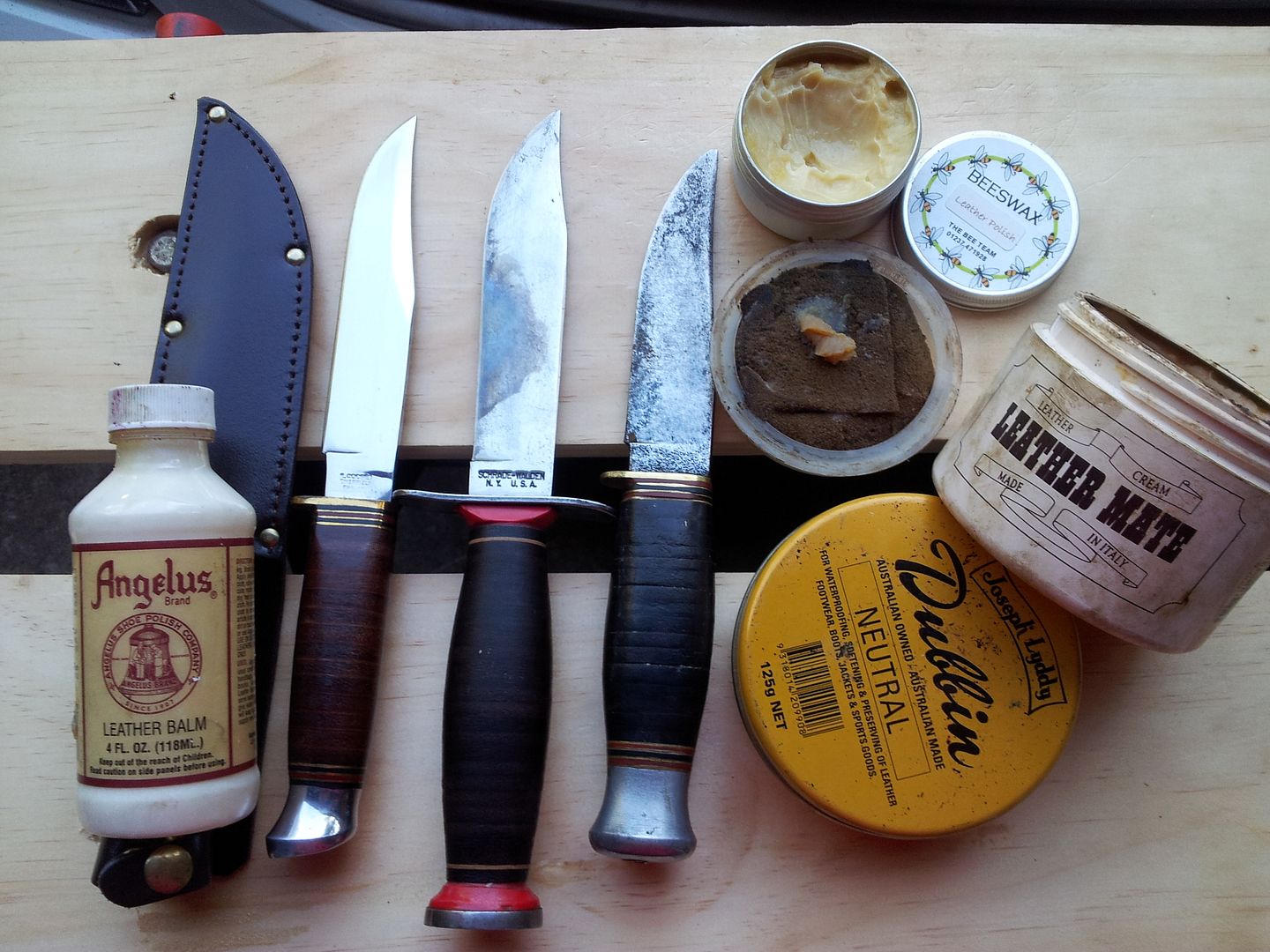

Ok here we have three stacked leather handled knives L-R Reg cooper bowie about 5 YO,Schrade D2 hunting knife and an unknown beater that was found in a laneway .I use it in the garden.
The Schrade was a bit dried and rattlesome when I got it but the leather is now tight and good. The beater was in appalling condition having been outside for a lenghty period.It too is now tight and has loads of life left in it.
Here's what I use on them -mostly beeswax products with the exception of Dubbin/saddlesoap.
I like the leather to feel slightly sticky. If they get wet through . Apply plenty of balm in a thick coat . Leave overnight and buff off in the morning.
NB iwouldn't use all of these at the same time just whatever is at hand-all are good.
