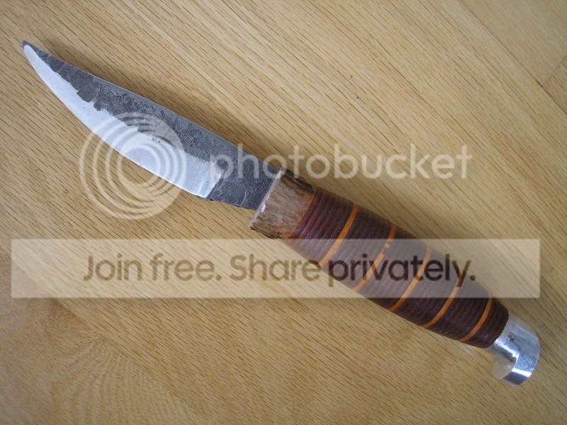

DB One thing that really helps over the life of the knife is for the leather washers to fit the tang. You don't want them loose prior to gluing. You can use spacers to dress it up and they should fit the tang also. I fit them one at a time and keep them in order if the tang happens to be tapered. If the tang has a threaded end that is round I use a hidden pin to keep the butt cap, washers and spacers from twisting. This is one I finished up about a month ago.
