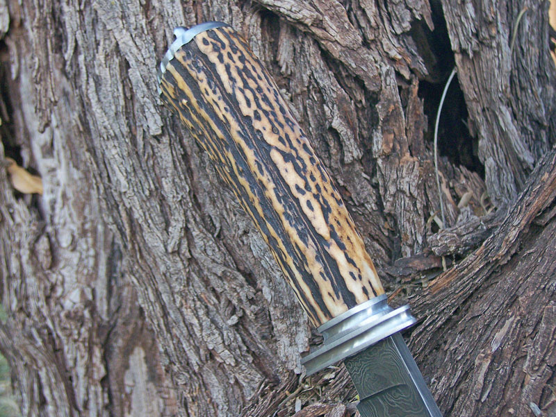

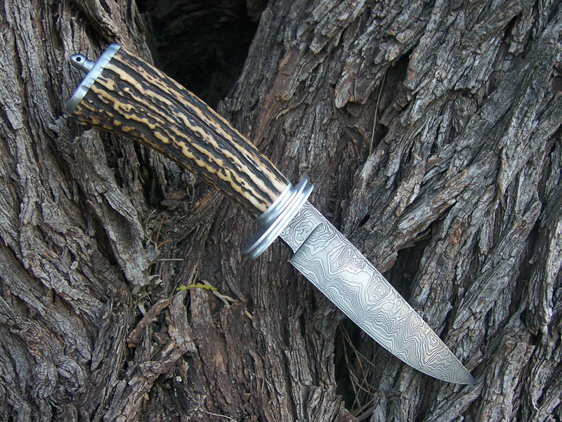

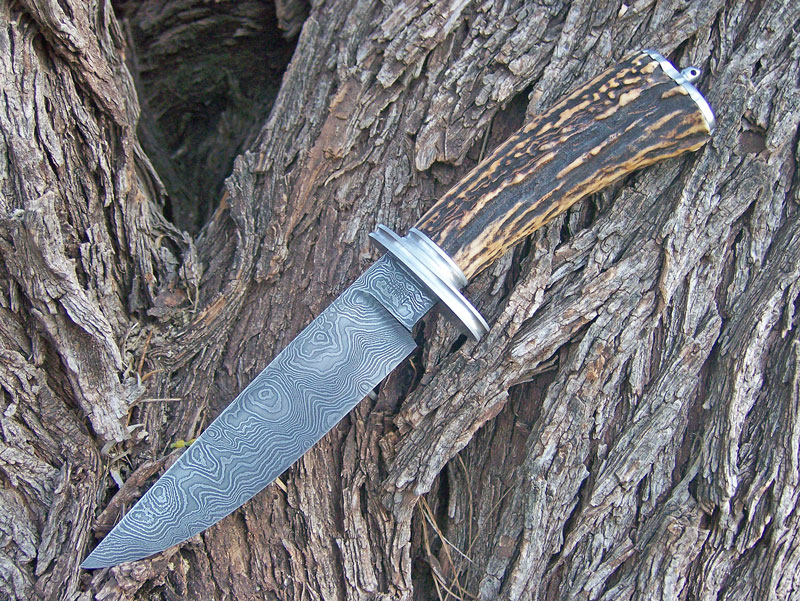

Howdy folks. Here's the latest one from my shop, another knife with a lot of "firsts." This knife is my first takedown, my first turned finial, first fluted guard, and first contoured butt cap. The blade is random carbon steel Damascus that I purchased off the Knifedogs classifieds about four years ago. The furniture is all 416 stainless. The handle is Sambar stag. Overall length is 11 inches. This one will be on my table at the Lone Star show April 12-13.
Why is it I can put a knife together, but can't remember which way to turn the phone for a video? :)
[video=youtube;3cdooFzWrO4]http://www.youtube.com/watch?v=3cdooFzWrO4&list=TLBV5bXucU6lk-Cg4bhDqPncBa0KWx4xL2[/video]
Thanks for looking. Critical feedback welcome.
Jason

I find both the guard and spacers to be a bit thick, and the guard too large for this knife.. I'd also like to see the fluting extend closer to the edges so there isn't so much unfluted material left. I think a little contrast in materials between the spacers and the guard (maybe blackg10) would enhance the look as well.

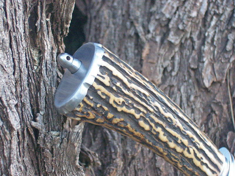

If I were to buy, the first thing that stands out to me is the lack of the makers mark? Also, agree with Bladeplay74 about a contrasting spacer. Third, combined with the stag and damascus, the face of the butt plate needs a little something. An etch? Maker's mark? I don't doubt that pics do not give a real sense of the fit and finish of this amazing piece. My opinion on further embellishments are simply something I would look for if I was to buy it.
