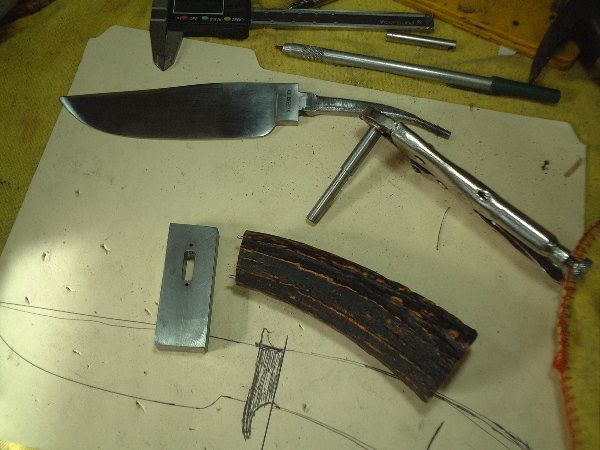

Gorgeous bowie, Nick! Very nice treatment of the butt there. Here's another, similar way I thought I'd contribute to the thread, from some (terrible) process pics of a knife from 2010-ish. Threaded tang end, counterbored stag crown, brass bushing made on the lathe, corby-type nut made on the lathe. Of course everything was polished up afterwards...

Salem- thanks for the photos man, that's awesome!!! :thumbup: I like how that leaves the option of it remaining a take-down too. Way cool buddy. :cool:

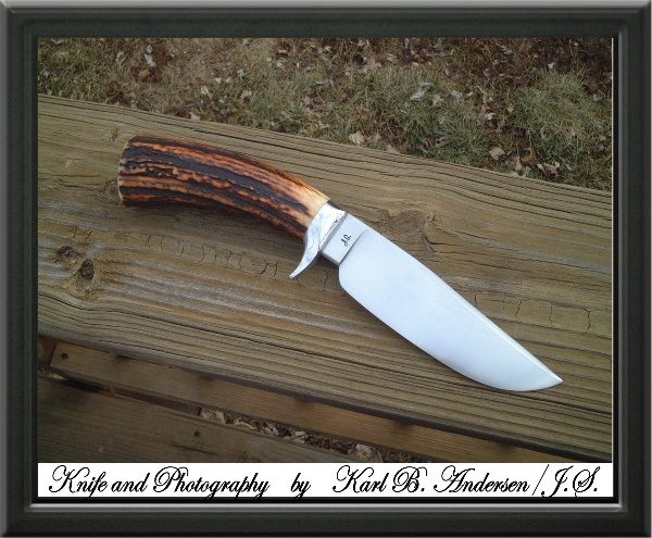

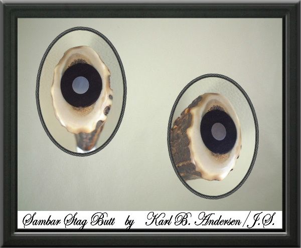

This is one I did in '08 right after I got my JS.
I drilled a 7/8" hole about 1 inch deep into the stag.
Turned a piece of Blackwood on a wood lathe.
Inside the blackwood is a steel ring sitting on a ledge upon which sits the "shoulder" turned onto the finial seen in the first picture.
Of course the stag was pinned to the guard.
Right up to the end, I could take it apart at will.
When all was complete, I epoxied it closed and then filed off the finial flush.
As I recall, I wrapped it in a piece of leather, locked it in my vise and drilled it with a cordless hand-held drill.
No reason to over-think it. ;)

That's a beautiful knife Karl. I like the two-tone, bulls-eye effect you created with the blackwood.
I over-think most everything. ;) :D
Personally, I don't think I could put the counter-bore in the stag with a hand drill and not get some wiggle... hell, I'd probably end up with an oval shaped hole :o LMAO. :D
With the stainless mating directly up to the antler, there's zero allowance for any gap- that's why I went with the boring head. It was the best option for me and my abilities... or lack thereof, LOL. :)
