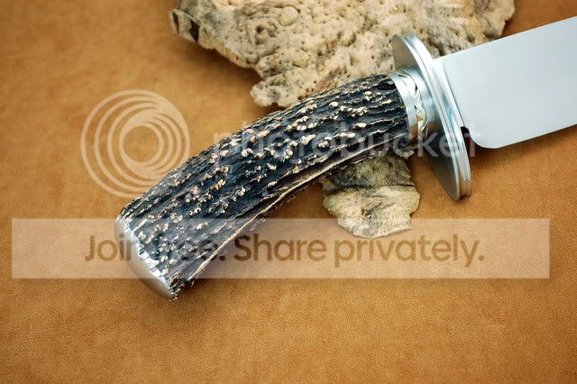

Just finished this one today.

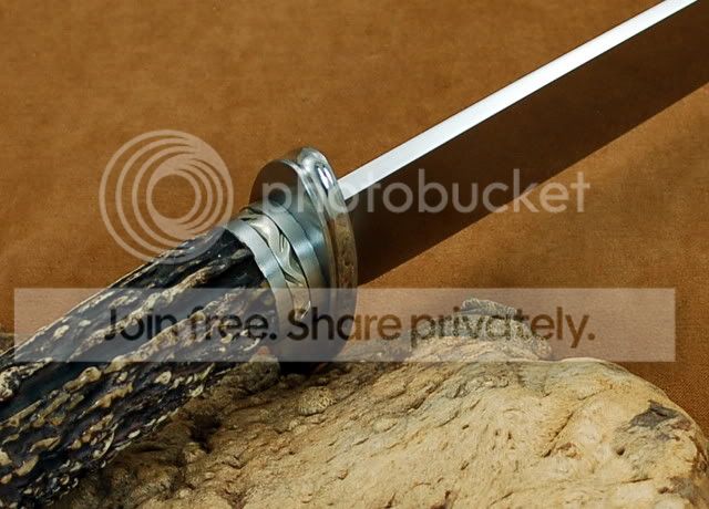

The finish on the blade is 2000 grit and 3 rub downs with flitz. The 3rd pic shows a pretty nice mirror finish for 5160. Wendy pointed out a "small" hesitation in a finish stroke. I put a lot of time in the finish so I will put a couple more strokes to make it right.
Wendy is my best critic and encourager.
Comments Welcomed.
elegant and beautifull. love that stag enough popcorn to mmake it interesting but not too much to make it uncomfrotable (at least form looking anyways)
Funny how your wife can always find a wrinkle in that otherwise great finish isn't it? Great looking knife David and nice stag.
Very nice. I like the double curve ricasso.....same style I use. Nice stag and very clean lines.
Darcy:)
hey man, that one is cool. I haven't been around lately. Love to see that knife. The butt cap matched to the stag is really nice.
kc
I normally don't like stag but this thing looks beutiful! Excellent job!

Here are the spec's,
5160 steel, Forged to Shape with distal taper Blade.
Blade has a hand sanded 2000 grit finish. No Buffer used.
Blade length to the guard is 9.75".
Blade height 1.75"
Overall length 15.625"
416 Stainless Steel Guard, soldered.
416 spacers.
Filed nickel silver spacer.
Filed 416 Stainless steel butt plate.
Nice piece of India stag.
Razor Sharp.
