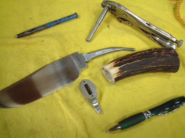

A couple people asked to see the butt end of the recent Stag Hunter.
Many of you know, as well, that I prefer through-tang threaded assembly.
I like to "pull" the entire handle material assembly toward the guard shoulders.
I like a nice, tight assembly.
So, I incorporated some of my take-down methods into a stag handle.
To accomplish this, I first needed to alter the stag handle.
I used a 3/4" carbide burr and shaped a hole into the handle material.
Then I turned a 3/4" round of African Blackwood.
I cut a piece 1 1/2" long and used Marine Epoxy to set it in place in the Stag handle.
Drilled a hole in it and inserted a stainless sleeve for the threaded pommel screw "shoulder" to set against so that during repeated assembly/disassembly the shoulder was only grinding on steel instead of a shoulder in the Blackwood. Just like my take-down assembly in countoured handle materials.
You can get the idea from the photos here.
Hope this helps!

Great looking knife. I do have a question though. I'm sure it will be a dumb one but I can't figure it out from the pictures.
How did you tighten everything down for the final fit? I can't see any way to tighten the female part. Or did you tighten it all down and then grind the butt flush??

Oh, absolutely! That screw was about an inch longer than the handle material. After the epoxy set up, I just cut if off and filed it smooth.

Okay, my turn, how do you take it down then?
You don't! It's a fixed assembly.

Can I pester you for more intel? For the life of me, I can not figure out how to drill for the handle and guard alignment pins. Drilling the first two holes isn't a problem, but then how do you line up for the other two holes????????????
