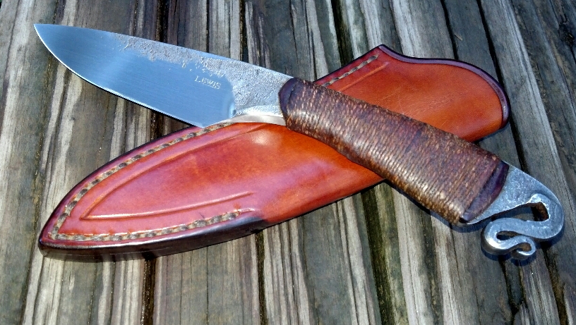

Looks great my friend! You've come a long way in a short time according to this knife. A bunch of good choices made. I would personally balk at covering Mr Culpepper's stag with cord, but the customer still demands custom right?
As Rick mentioned above, here's another example of a forged knife where the tang was both tapered and inset to make room for flush wraps at either end. I knock them in hot then dress with a small mill file before HT. Not too difficult if you measure and mark well. I don't care so much what it looks like on users but can tell you they will wear much better than those where the cord stands proud. Steel or horsebutt bumpers all around make a big difference in heading off future handle problems in rough use knives.
