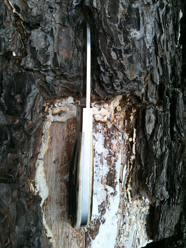

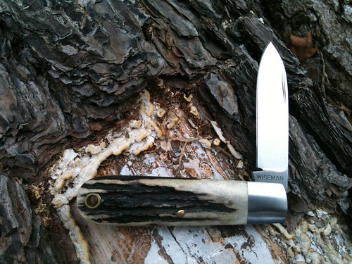

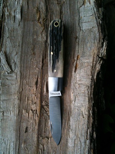

This is the second prototype of my Gentleman's knife for Kaufmann Mercantile. This one is stag with a thong hole.
3 1/8" closed
5 1/2" open
Stainless bolsters with mill relieved liners
3/32" thick D-2 blade and spring
Medium pull
Half stop
Spring flush in all 3 positions
Premium grade stag from Culpepper inc.
SOLD
Thanks for looking,
Gene Wiseman

Gene, from what I can see it looks pretty darn nice, but where you put it and having it stand up rather nthan lsaying across the page takes away from it. Frank.

Thanks, They seem to change the way you do things on flickr every time I go to use it and I couldn't figure out how to rotate the image.
