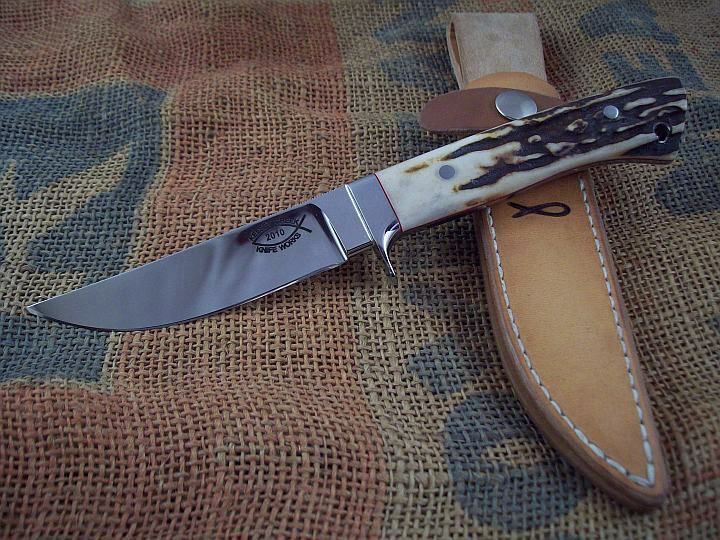

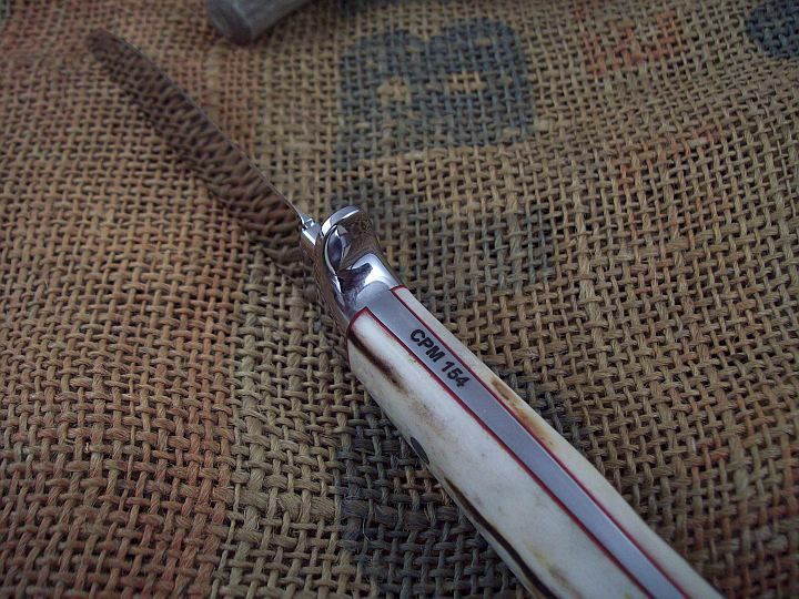

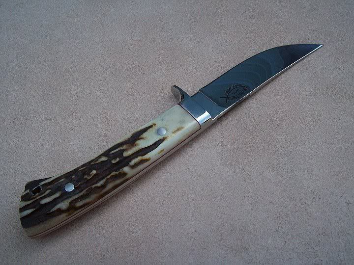

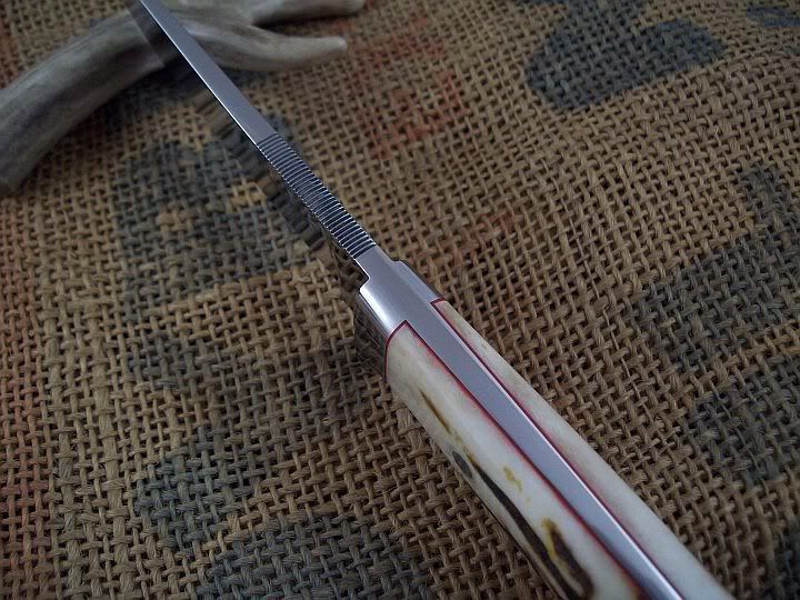

Thought I would post this pretty little trailing point hunter I just finished.
Knife sports a tapered tang with sambar stag scales, backed up with a .015 bright red liner. Blade length is ~ 4-1/8" L.
Stock is 3/16" CPM154, hardened, LN cryo'd & 3X tempered by myself :)
I hope you guys like it ........
Thanks a lot for checking out my work :) :thumbup:
:cool:
so clean. Nice stag and the liners have just enough pop.
She's a beauty buddy:thumbup:
Nice to see that you're keeping busy David. ;)
Another example of the flawless Wesner fit and finish .... incredible work! :thumbup: :thumbup:
That's a nice clean looking little hunter. I'd be proud to have that on my belt.
