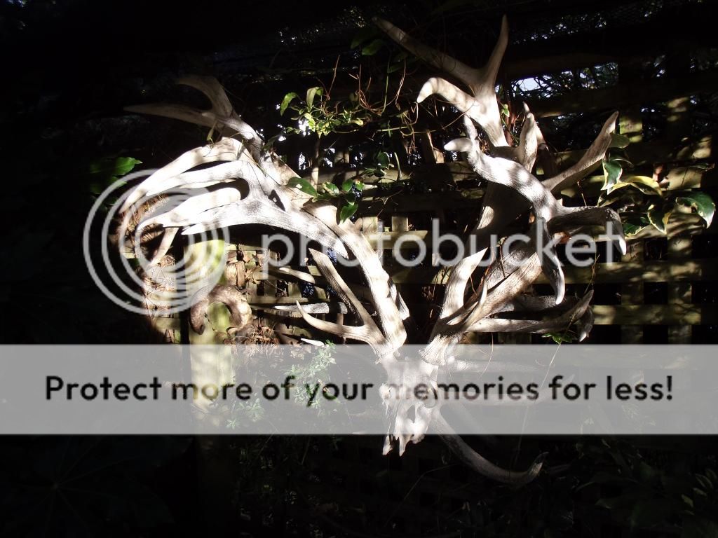

Jon: No Sambar stag deer died to give us his antlers. They are all sheds picked up by farmers, generally, brought at various collection points and then distributed. All collection of Sambar stag ended about 10 years ago with one final distribution.

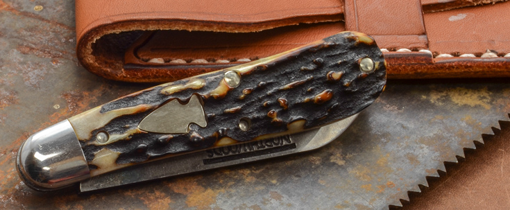

It is in fact a Northwoods Burnside Jack, and I imagine it will arrive sometime next week. I will most certainly post a few photos when it makes it to Cleveland.
It will be my second Northwoods. My first - a green camel bone bullet jack - arrived yesterday. I was really impressed with the quality of both the design and execution. The bullet jack is just a great knife for my rather small hands. It's going to get a lot of use.
YES! Antler from a living Sambar Stag it is :-)
I had to see a pic, this from the KSF site
