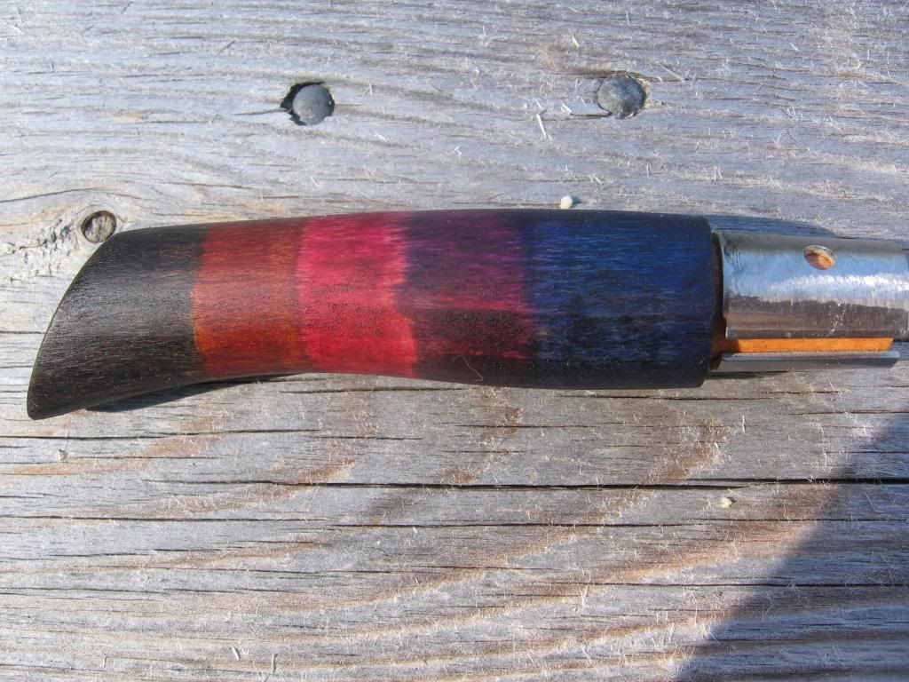

I have been using Fiebings for over 40 years on everything from wood to bone to antler and more. I have seen great results with RIT dye but I'm really not a fan of soaking wood or bone in hot water. Fiebings is eiether oil or spirit based, I use both but I think the spirit based dye sinks in a lot deeper into hardwood than the oil. Not sure the dark brown comes in spirit dye. The medium brown is a red brown, the dark brown is a chololate brown. Tandy carries Fiebings. Just added a pic of an opie handle dyed with Fiebings spirit dye, 1 coat per colour, the brown is the medium brown. Hope it helps.
Best regards
Robin
