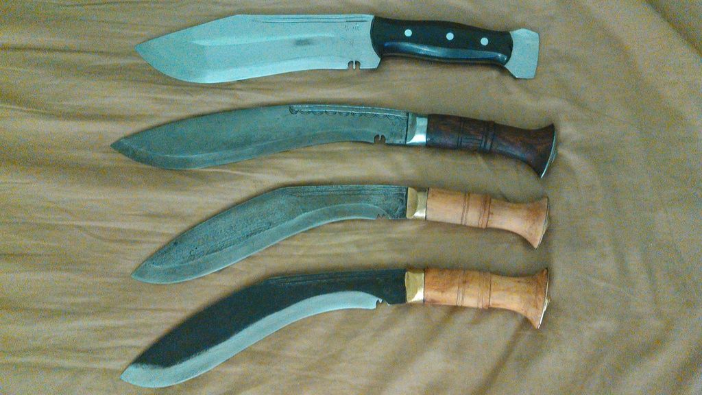

I took the scale off my newest KLVUK, because it will see mostly kitchen duty, and also off my Tamang, mainly just for looks. It wasn't quite as quick as a 10 min soak and it rubbed right off, more like 20 min, then some scrubbing with vinegar soaked steel wool and paper towels. The results were great though, and still much easier than grinding the scale off, which I did on another KLVUK. Left a nice grey etch, showing the temper line on the Tamang.
This is a bad pic, but it shows the KLVUK and Tamang in the middle, with another KLVUK and my AK Bowie to show both forge scale and "normal" steel color.

SingleGrind: How does the straighter profile of the tamang stack up against the more down turned profile of other blades? (Getting off topic again, I know)
First I love that tamang! And my KLVUK looks very similar after the vinegar treatment.

Jackal, before I get off topic, I forgot to mention, all those khuk handles above have only been treated with nice clear mineral oil. All but the Bowie have probably 10-20 coats of it. I just keep coating once or twice a day til they stop looking/feeling so thirsty, then only a coat every now and again. The Bowie is both new, and horn handled. I slathered on a thick coat of oil and let it sit for a few days. Seems good for now... I'm no expert on horn though.
Now to wander; The Tamang. I really can't say enough good things about it, and can only summarize by saying, get one. The more gentle curve brings the center of gravity out farther from the hand, and makes the blade more tip-heavy. That makes it an awesome chopper for things like tree limbs, large shrubs and undergrowth, not necessarily chopping down a tree, though it could do it no doubt. It's not a chopper the same way a similarly sized AK would be.
I like to describe it like a Super-KLVUK, because it can do everything the Keshar can do plus more. It's a little heavier than a KLVUK, and also a bit longer. The handle on mine is pretty slim, which helps the ergonomics. The weight is just right. It just feels wonderful in hand, and is such a pleasure to use. There's a thread on the main forum I did called "Weekend with Tamang and Tibetan Short Sword" where I rant and rave some more about how much I adore this blade :)

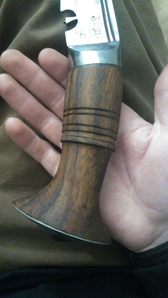

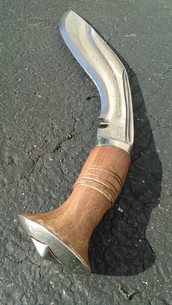

Let me see if I can find the pic I took after sanding the DC, and one from after "contaminated" BLO treatment. I snagged one cuz I knew it wouldn't stay that light no matter how hard I tried, but again, it still got way darker than it should have. Basically back to the color it was before I sanded it.
Ok, found a before sanding and a pic from when it was new, but I don't have one of after. I'll have to take one later. For now, here is new and untouched, followed by sanded.
And for comparison for now, this one is a picture of the blade after being used, but before sanding and treating. The handle looks most like this now, but is even darker. All in all, I still wish I could get that pretty blonde color back, but that's alright. Good amount of the reason I only use crystal clear mineral oil now though..
Edit: Alright, got another pic. It's gonna bother me endlessly that these are out of chronological order, but I also don't feel like redoing half of this post. The pic with the black on the blade and my hand is from before the handle was blonde. Easy to tell, the blade is tarnished in that pic.
Anyway, here's what it actually looks like today, as captured by my phone's terrible camera.

You need to definitely not use anything contaminated and it's best to seal it. Otherwise the oil in your hands especially when your hands are like your photo work into the wood and oil in the handle and it gets darker and stained.
This is where Tru Oil or Varathane something that seals and gets hard wins the day. It doesn't allow stuff to penetrate it and has a much better chance of staying blonde.
FWIW I love the look of that Thamar handle, it sings.
Bawanna, I do like it a lot, and know the blonde is hard to keep blonde, but I still liked it better before :)

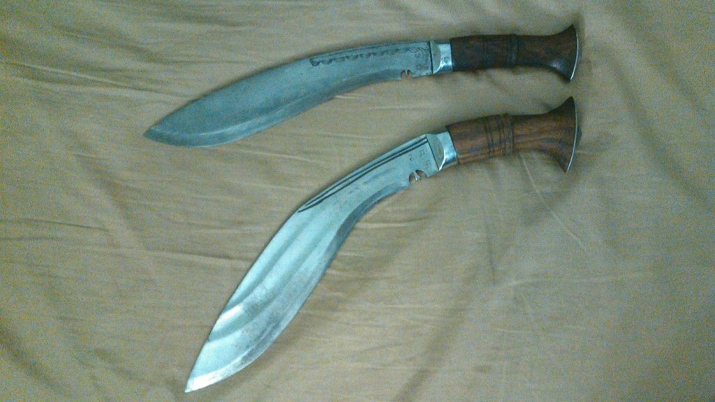

Got a couple pics, including a comparison with the Tamang. I'll post those here, but add my solo DC handle pic to my above post, to keep that together.
Here is what I meant about the Tamang handle being slim, though the Dui Chirra handle is also quite beefy. They both feel perfect though, despite my smallish hands.
Jackal, you asked about the straighter profile of the Tamang compared to other blades? My DC is about the most curved khuk I've got. In this pic, I made the bolsters parallel. They feel about as different in hand as they look.

You say the straight profile is great for chopping. I thought that the downward curve was was made them better choppers? Is there something I"m missing?
No, I tried to figure it out myself, because that's what puzzled me the first time I swung it at some wood. Maybe that it gives a bigger arc for the blade to accelerate during the "flick" motion, or something as simple as that my Westerner approach to swinging a blade fits that knife more naturally.
Don't get me wrong, the Dui Chirra can outchop the Tamang all day, but it has extra weight and length as well as more curve. The Tamang easily outchops a KLVUK, and is as easy to use and versatile, while the DC outchops the Tamang, but is a little more difficult to use and gets a bit tiring after a while.
I guess one thing to keep in mind is that a lot of the chopping the Tamang excels at is sideways or at funny angles. Chopping away at an overgrown shrub or scraggly tree. You can swing it in funny ways because of, I don't know, some magical property about it. But whatever the reason is, it's a joy to use, and it works like a charm with hardly a peep.
After more thought, I'd have to guess that I'm onto something with the angles and acceleration thing. The Tamang has probably 30-40° more "wrist-flickability" than the Dui Chirra, to get technical about it. Bear in mind that the khuk is straighter than some other khuks, but still more curved than a hatchet or machete. That little bit is all you need I'd say.
