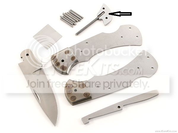

Thanks. I was thinking of making the type with the pin stock (?) that is used for the spring. Not sure what the correct terms are yet. I ordered the book The Lockback Knife: From First Design to Completed Folding so I should have the correct terminology down soon. This is the best pic I could find as an example. What is the material and does it need to be heat treated also?
Yeah, that part needs to be treated like a spring and spring tempered. HT'd to 50 or lower. Material can be whatever you feel comfortable heat treating that has the properties you want (i.e. stainless or non)
I think knifekits sells some stainless leaf spring material that's hardened already, but I'm not sure what it is or how good. It's flat, not round, but that's irrelevant.

Yes 45-50 HRc. This could be a heat treatable type stainless or a cold rolled non-heat treatable type like 301 bought as 'full hard ' condition.
