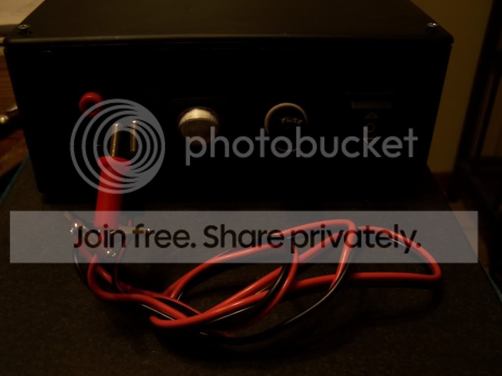

Ok I have gotten a few Emails about the etcher I make so I thought Id post a pic of one here just for the heck of it so Yall Can see what it is that I offer.
This one Is a basic etcher 24-28v ac and dc depending on your local power companys outputs.
The other one I make has an extra switch that switches the voltage from 12-14v to 24-28v but is basicly the same layout with an extra switch.
Yep, thats it. Mine has the extra switch. Rusty does a heck of a fine job on these. I have a buddy who has a 400.00 unit and this does the same thing. Love mine.
