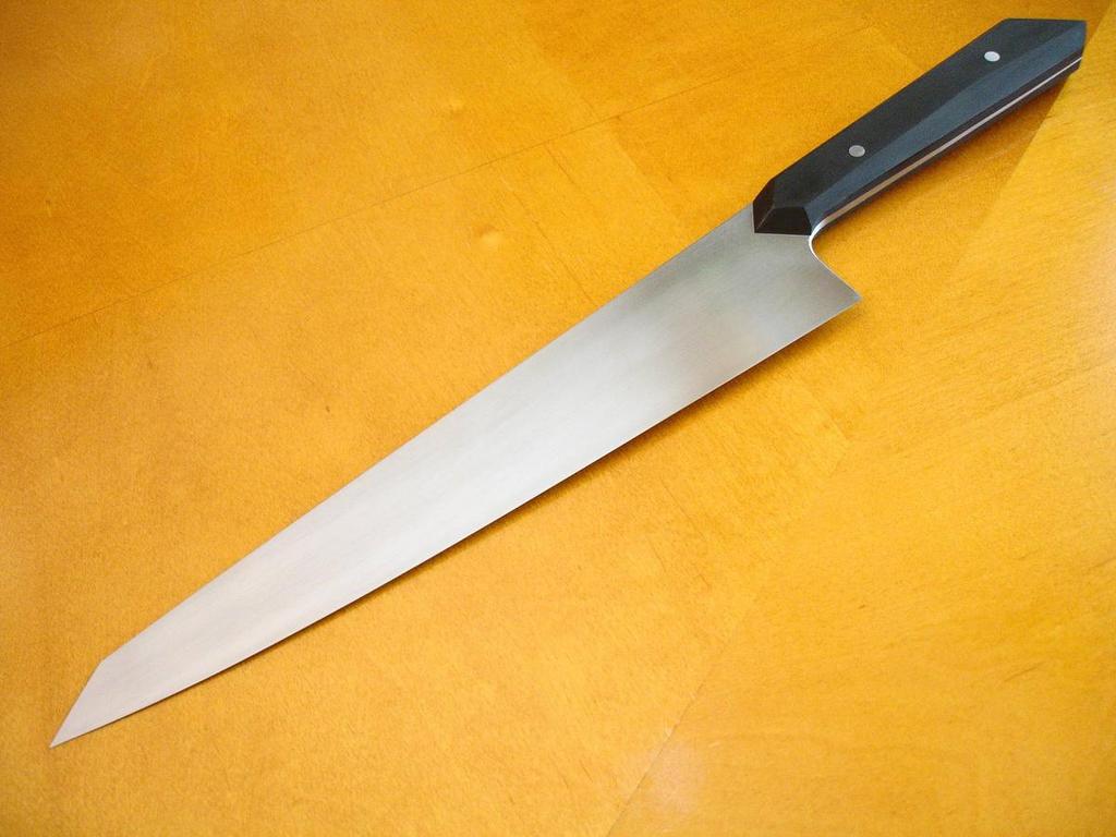

I make mostly kitchen knives - knives that will see every day use, regular sharpenings, inevitable thinnings, and maybe some modifications. Most of the customers for these knives don't particularly care about finish, as long as it works the way as it should and holds up. I'm thinking of having them finished up to a slightly dirty 220 or 320 - they'll look fine, with the scratch marks going parallel down the blade, but with some other lingering light scratch marks maybe showing up different directions.
What are your thoughts? I know we all love the beautiful, practically flawless finishes on here, but for a knife of this circumstances I would rather put the effort into performance and save time and cost in the finish department. Fit would be tight, sharp corners rounded, etc.
Here's an example of a gyuto I did with a slightly dirty 320:
You can see that most of the scratches go parallel down the blade. If you hold it in person and angle it with certain lights you can see a series of light 220 or 320 going diagonal or whatnot.
I've been told by a lot of customers/potentials that they too agree that the finish doesn't have to be 'flawless', and they would prefer the time and cost savings in the circumstances. Upon any inquiries I would ultimately be clear that the finish would be as I described.
Agree or disagree?
Personally, I see surface finishes as a direct reflection of craftsmanship. I think a 320# finish is fine, but maybe a belt finish that is uniform would look better. I am in no way saying your work is sub-par, from what I have seen you do good work, why take a short cut on the finish? Maybe go 220 and then scotch brite?

My opening post was mainly focused on intentionally disregarding those diagonal/other scratches.

It's not a better finish, just different. Most people like how a hand finish looks, but they don't really go anything regarding how a knife will cut.
Any finish should be consistent. To my mind, the whole point of a handmade knife is craftsmanship and attention to detail. "Leftover" deep diagonal scratches from a previous grit are a sign of the maker not giving a hoot... that's bad. Various shallow scratches from use are just character marks... that's good.

I guess one of the thoughts that makes me ask the question is that with a very glamorous looking knife, people are hesitant to use it to its fullest potential. I know there are people out there who use very, very expensive kitchen knives no problem, but a lot of people are intimidated to thin a knife or use it the way they would really want to because of how flawless it was. With regular sharpenings a knife would need to be thinned - I'd be scared to thin a knife with a crisp finish, much less a san mai or damascus/etc. My train of thought was this: if I put in the extra time/work to get the finish crisp, it would increase the cost of the knife and maybe introduce this issue I'm mentioning.
Maybe I'm looking at it the wrong way, and should consider a belt finish/scotchbrite for a quicker option for finish, but not compromise and end up with a sloppy knife?

... not all knives need to be finished out to a perfect 3000-grit finish. However, whatever grit you decide upon should be CLEAN. If it's 1500-grit, it should be CLEAN. If it's 280-grit, it should be CLEAN. If I have already taken the time to take a knife to a "dirty" finish at a certain grit (meaning all scratches are at the correct grit but are not uni-directional), then I feel that the extra effort required to make things clean is well worth the results. I would almost always prefer to see a clean finish at a rougher grit than a dirty finish at a higher grit.

Thanks for the thoughts everyone! I really appreciate it. I figure if I want to offer a low cost option for a finish, a machine finish or forged might be the way to go. If I go with a hand finish, then I will do it right and get it clean.
EDIT: McNealForge - it's black paper micarta. Good stuff for an inexpensive, no-frills and durable handle. Looks good too I think.
I find that it does not take that much longer to get a clean 600 hand sand than a dirty 400 hand sanded finish. One point of hand sanding is that if it's done well, changing direction with grit size, no larger scratches are left behind, yielding a finer and more consistent finish that is less susceptible to corrosion. I find that a 600 grit finish is pretty easy to repair any light to medium scratching on as well.
