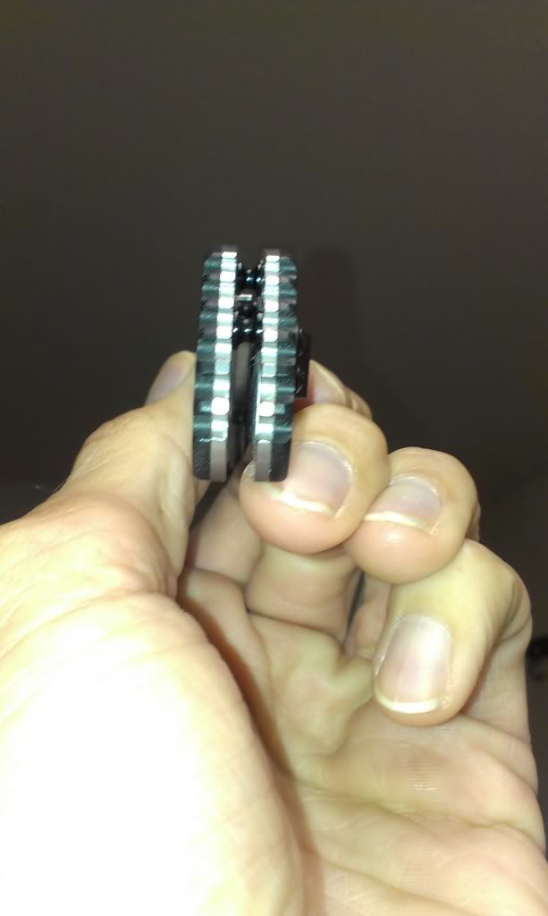

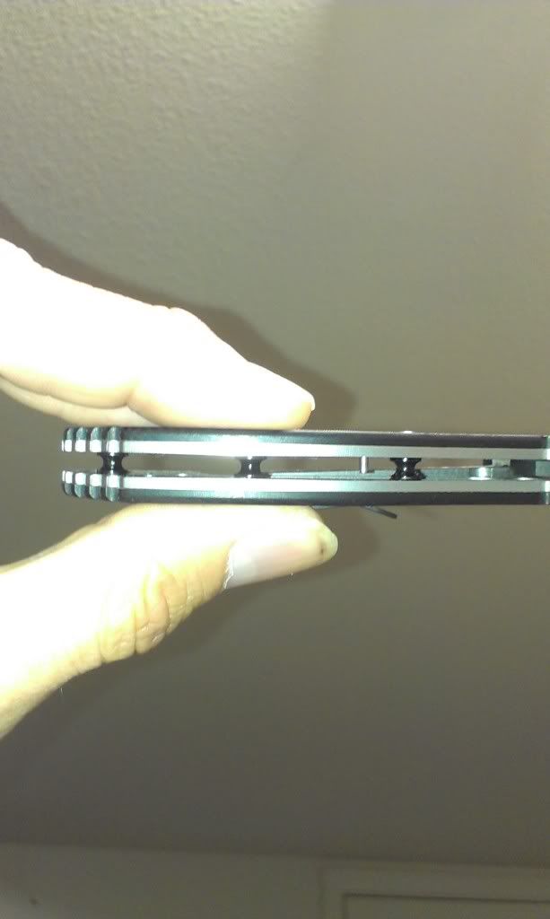

So I got to looking at the standoffs in a Blur that I have (it's junk) and they appear to have, not only the same measurment in height, but also the same size hardware.
Has anyone ever tried to swap the standoffs into a ZT?
The standoffs are nice hourglass shaped, and even better, black.
Before I go tearing them apart I figured I'd ask. It's worth a shot. :)
That pic kinda makes them look like they don't fit, but they do.

+1 for blur standoffs! :thumbup: I fixed my 0350 from a bad centering, my stock plastic back spacer on my 0350 started to get deformed from use. It was the logical way to go instead of sending it back in to ZT a 2nd time for the same problem... mine feels smoother and the tolerances are more in favor of this thick blade between the liners now with the blur standoffs. I think it should come like this from the factory. looks way better IMHO

That's great to hear. I just ordered a Blur from Dave to do the same, hope it helps. I never really considered it'd help the centering, was going for the looks. That'll be a bonus, if it works, for sure.
And jhyde7585, I'll be sure to post results about that fit. I'm guessing it won't fit without some pretty serious modding. And I'll also try the Knockout unassisted, as I have one of those coming too.
