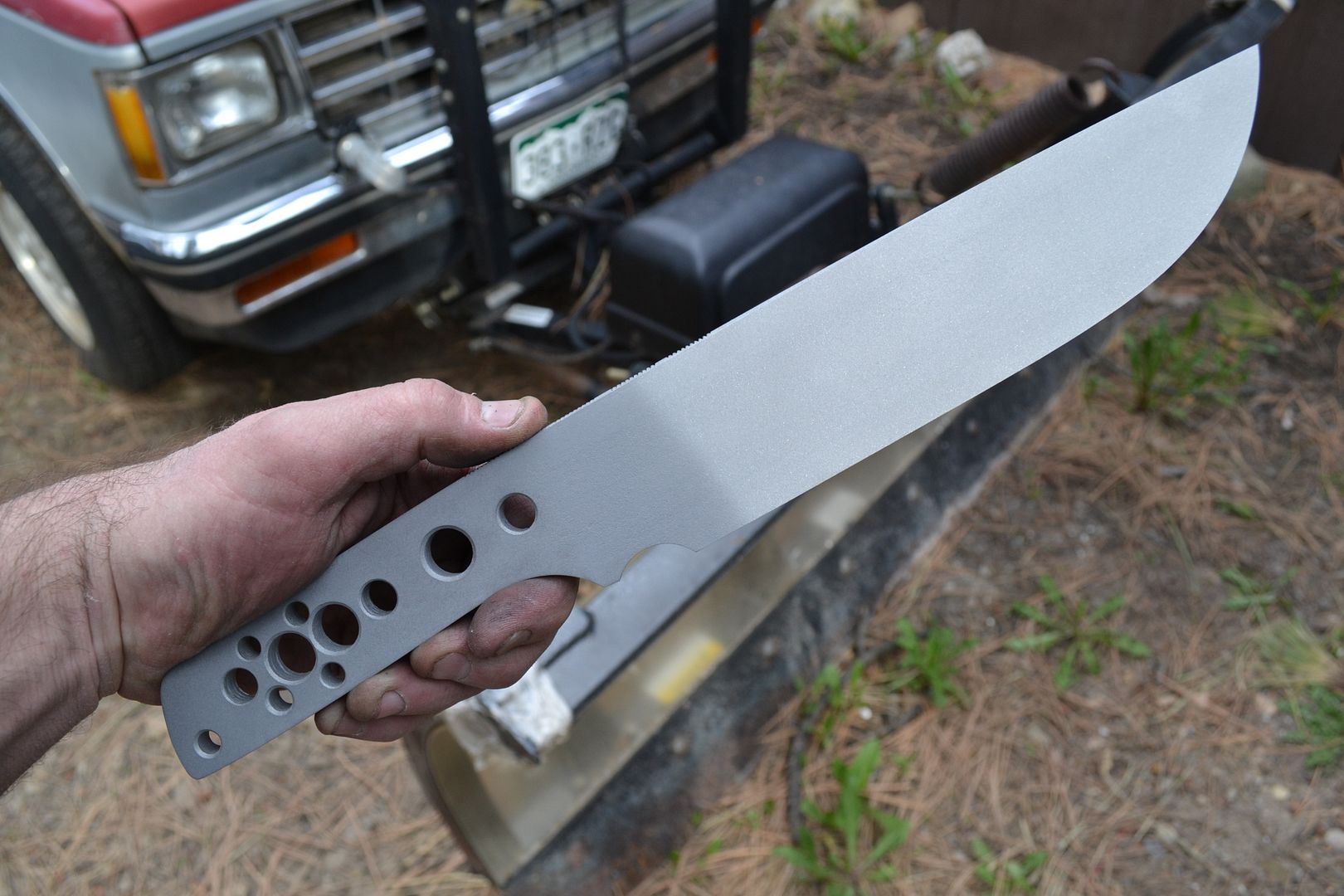

I spent my morning hand carving a copper menuki (handle charm) for a yet to be made tanto... it came out pretty cool but I needed to do some serious grinding! I busted out an 8' piece of .36" 5160 steel and got to work!
.36" thick 5160 Steel
8.5" Blade, 5" handle
Jimping - buffed, blasted, buffed, blasted... will be sanded, buffed and blasted more for the most comfortable traction possible.
This one has a ways to go but I thought you guys would enjoy the pics... it will be for sale too!

I used a chop saw to cut my stock then ground to shape, I'm still considering a bandsaw. :D The checkering file/guide is pretty rad I must admit!
Usually profiling is a quick thing but with .36" it is serious! Even with a 40 grit belt it took a while and left a pile of metal...
Those are big holes too, 1/2" on the large ones... the lanyard hole is 1/4" and looks small. I'm using .375" SS tube to secure the scales....
It's funny,at first I though, "oh no, it was simple" but about 20 tools and many processes were involved. It has been fun I'll say that.

I'm hoping to get a HF/other bandsaw or a Swag stand and porta-band... either setup would be nice. ...Good for anyone on a budget. I have cut most of my steel with a carpenters saw and metal cutting blade! The KMG grinder eats metal like crazy but a saw is the way to go.

... I like how you placed the holes for lightening it up.. even if they don't get seen, I like the symmetry.. random holes sometimes are too close together and in my mind create weaker spots in some cases.. EXTREME PRYING cases, but meh..
Thanks! The strategically placed holes really help with balance and lend for a strong construction.
