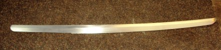

The wakizashi blade is now formed and will be worked with a sen/rasped/ filed/ground down to almost final shape. When it's cleaned up, a few photos will be forth coming. Blade length from tip to muni-machi is right at 20.5 inches. Blade width there is about 1.25 inches. The sori (or curve of the blade) built in is about 3/8th inch. After yaki-iri (heat treat/creating the hamon), it should increase to around a half to 11/16ths of an inch. Hopefully, it doesn't crack and cause about 25+ hours of poundy-poundy to go down the drain.

As you can see Kamidog, the blade is not yet really straight and even. Taking the high spots off with a sen. I prefer the Portuguese made Sandvik rasps for all the rough shaping. Will remove 2 inches from the tang if I'm able to get through all the snow that fell today.

Have the blade all draw filed now, Danny. Took a mite longer than anticipated. Now to let the corners of my fingers heal up from all the pressure splits in the skin. Still pulverizing the clay, sand, and charcoal. Hope to get one of the two clay types mixed this weekend. Knee deep snow fell day before yesterday and today saw another 8 inches. Sending some to you in Texas as you need the moisture down there.

Ready for applying the two clays ---as soon as I get the ingredients pulverized and mixed together.
