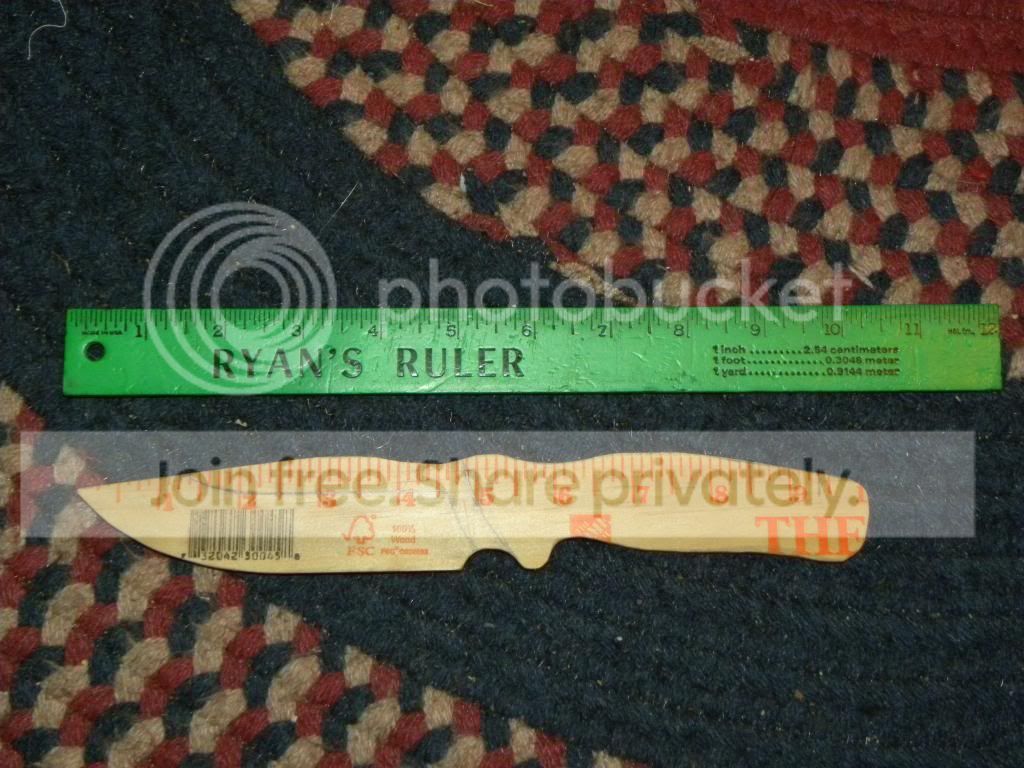

I'm waiting on my steel to get here (cpm 154) to start making my first knife. I sketched out a design and put it on a thick yard stick. The knife will be 10" overall with about a 5" cutting edge, 1.5" wide and 5/32" thick. Do you guys think this is too much for a first attempt? (If I fail half way through, I'll have enough to try something else). Here is the pattern I have so far.

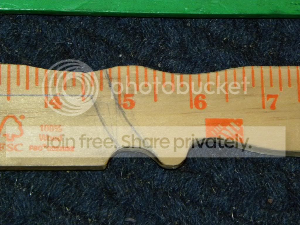

I have the grind lines drawn and the handle scale lines. I want the front of the handle curved and the grind line (not sure what its called where the bevel ends and goes to full width) to match to scales. Would this be hard to achieve or just take extra elbow grease with a file? Here is a close up of that area:
The angled plunge will be harder than a simple straight plunge, but should still be ok with files as you have lots of time to correct errors. Personally i would take a bit of the swoop/hump out of the spine ahead of the scales, but that's just personal opinion. How do you plan to heat treat this knife? Its not like carbon steel and needs precise temps that are very high and controlled soak. Overall i like the design aside from the spine of the blade, but again thats just a personal thing maybe. The whole package looks very "Busse Ratmandu-ish"
Yeah that swoop looks like it needs swage running up to it.
I think you can probably pull it off if you don't get tired of filing first. like Grayzer said, files give a lot of time to make correction. So much time that I said screw it and ordered a belt sander half way through my first one, and that was with doing a large part of the work with an angle grinder :/
I agree with the spine part. I was debating whether to do this or just keep it flat and slightly angle down towards the tip (like it is now at the front). I might just end up keeping the spine flat in the center of the knife, we'll see. Ha I actually did use the ratmandu features to do this. I actually was going more for a mix between an Esee 5 and a Ratmandu but it turned out more Ratmandu-ish. Maybe with a flat spine (or flatter) I'll end up with more of the Esee/Ratmandu mix. I actually already have a belt sander that I plan on using (actually its my fathers that I'll be using. That was also his yard stick I used :D ).

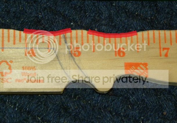

What I think is needed is removal of the camel hump. The spine will be far more comfortable and hand friendly if it is a smooth curve from the handle to the blade. Taking out the whole dip-hump-dip will greatly improve the looks and function.

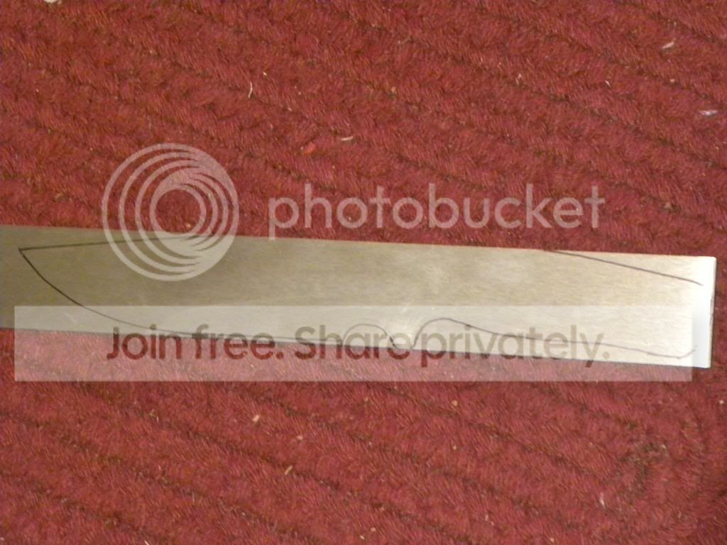

So I got the knife cut out and profiled today. I still need detail work and perfecting but I'm happy with the progress today. I did add maybe about a 1/4 to 3/8 inch to the handle and it fits perfectly in my hand.
It looks good! Take your time and do it right! BTW edit your profile. You never know one of us guys with a grinder etc might live in the same town etc.

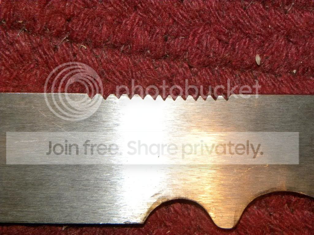

Any tips on what specifically to pay more attention to when taking my time and doing it right? Ha like the jimping I just tried to do. Here is my first attempt at it. Obviously its a bit crude and uneven but it gets the job done and I'm ok with it on my first knife.
You may want to take. Few passes off the top of that knife to flatten out that jimping. My concern would be how sharp it is, kinda looks like it will eat up your thumb if any pressure is applied to it. If you look at most other comfortable and functional jimping, you will notice that much of it is very flat with just enough groove to give a bit of traction without removing part of your thumb.
