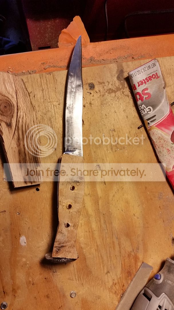

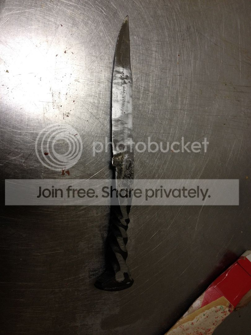

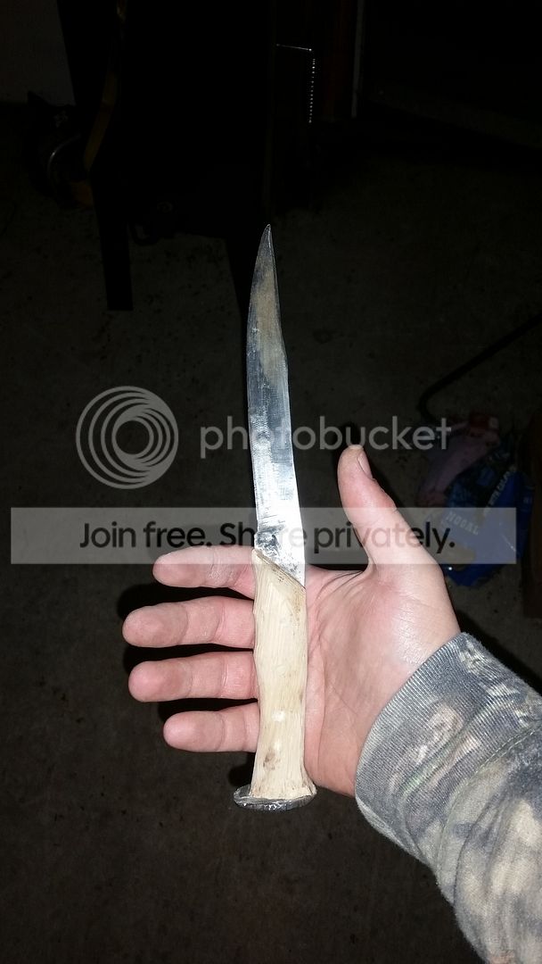

I have been a chef for the past 9 years. Used all kinds from Victorinox, Mercer, to my current (and expensive) set of Wustof's. Hate to say it but they didn't cut it for me. Had a dishwasher chew on my ear for a few months about bladesmithing and after an insane amount of looking into the craft I was some would say "bitten". So after this kid gave me a rail spike he pounded on mercilessly and twisted I had a base to learn shaping with. In the end after much trial and error I ended up with a fairly decent 6 1/4" hunting knife. Now that I have my forge to working order and refurbished many of the local restaurants knives I have some flat 1095 on its way to become my next project. That said I am looking to get a wild hair and do a rookie mistake by my first start to finish blade being a sashime. The bladework aside I need to know for the sycamore handle intended for this what is the best sealant/oil base to make it 100% food grade? Thank you for being patient through my dribble and look forward to any and all feedback.

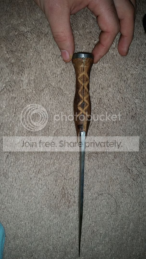

photo.php

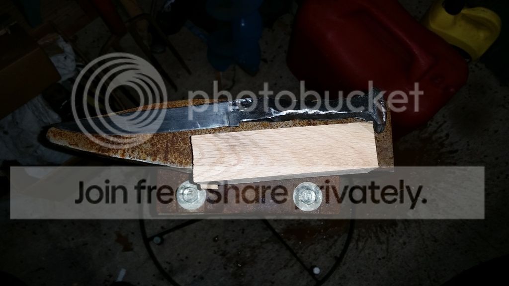

Hunter carved out of the beaten up rail spike. Torched Red Oak handle cut out of a bit of firewood

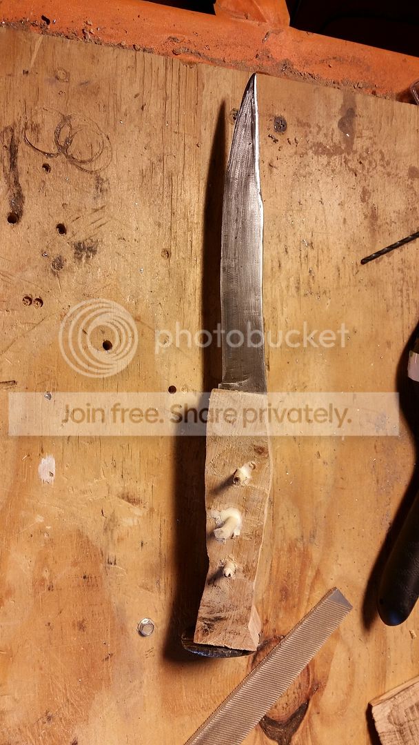

this was the result of my first grinding with a bench grinder and dremel. Come a long way and now have much better tools
