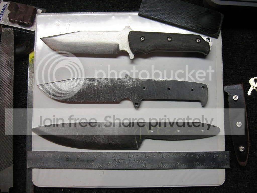

I've been wanting to make my own knife for years, so I finally decided to buy a piece of steel and get busy. I bought a large piece of 1/4" thick 440C and got started. Well, I'm not even fully done with my first knife and I'm already hooked. So I've started two more. The second one is the other half of the original piece of steel and the third is an entirely different piece. So far, I've only been using a drill press, files, and a hacksaw, with a little detail work left for the Dremel. I did just pick up a belt sander and have used it on the bottom knife in the picture and it looks like it's going to work nicely.
The first knife is pretty much ready for heat treat. It has black linen micarta handle slabs and stainless fasteners. It's at 120 grit right now, but I'm going to go to 240 before I send it off. Here's what I'm having trouble with. How sharp (or unsharpened) should it be before I send it for heat treat? Right now, I have no primary bevel on it at all. It is sharp enough to cut string if you really press hard. I'm assuming that I should put a primary edge bevel prior to H/T but I don't want the blade to crack during H/T. If I do put a primary bevel on it, should I leave it fairly dull to prevent cracking?
The second knife is in progress and the third is a kitchen knife for my mother in law. She has a horrible selection of kitchen knives so I told her I'd make her one for a late Christmas present. Now I have a buddy asking for one and possibly another friend that is interested. It's been so damn cold here that I haven't spent much time on them in the last couple of weeks, but I did get out there tonight and worked a little and took pics. I'm new at posting pictures so they might not show up until I figure this out.

With 440C it is normally air quenched so the edge can be fairly fine. Most of us leave between .02-.03 or more to prevent cracking or wrinkling, but I use carbon steel and quench in oil. Still I would dull the edge back a bit if for nothing else safety in finishing. One slip and you could be out of commission for a while.

I have heard that you want about a dime thickness on the edge to be sure you don't warp or crack.

I like your picure. A further point to the blade thickness.
Your top knife with the hlf blade bevel gives you a stronger blade for general purpous chopping and hacking.
For a kitchen knife a half blade grind bevel works on the thin blade stock. However on a thicker blade stock you will get a better slicing blade if the bevel starts at the cuting edge and goes all the way to the back edge. That makes the angle smaller and the blade thinner. With a half grind you need to push a bit harder.

Yeah, the kitchen knife is 5/32 so I was planning on a full bevel to make a good slicer. I didn't want to go as thin as 1/8 inch because I guess I like to over build everything. The top knife is intended to be a heavy user. Batoning and such while camping. I think on the knife in the middle I'm going to take the bevel up further but not all the way.

I leave 1/3 of the orginal thickness, on 5/32 that would be 0.05" then I would sand after HT to 0.02 for a chopper and 0.015 for a kitchen or cutter. If you are going to use the sander make sure you use a new belt and cool the blade in water after each pass to prevent ruin of your HT. When the blade is wet you can see the water evaporate as you grind, when the water is gone you are headed for trouble. When you get pretty thin go to hand sanding with a wood block and strips of paper. I start as rough as 220 but usually 320, 400, 600 and 800. All available at automotive part stores.
